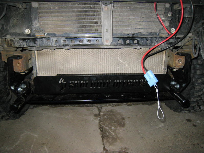

    Here is what I have....

    Is that all part of the skidrow plate?

    No, the side pieces are part of my snow plow.

    the 2 hole's you can see on either end of the frame, those are called endcaps.
    there is a crossmember/crush plates that bolt to that, and the front of the skid plate bolts to it.
    also, with the arb bumper people do the endcap mod, look into it if your mounts are similar

    Thank you... with your info I was able to google some more info and found out just what all I was missing...
    I am on the right track now. fabricating some stuff to get it all working right.
