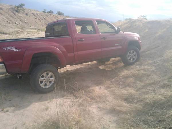

    If your axle doesn't look like ^^^^^^^^^^that, then you DO NOT have the rear differential lock. You may have an LSD (Limited Slip Differential) which is either aftermarket or the SPORT package which you don't have. I think the previous owner installed a LSD and the OR stickers.

    Sorry to say dude, but you have a double cab long bed and you couldn't get them in TRD OF
    And your OR stickers aren't OEM. The should look like these

    So I may have an lsd diff? Would there have been a button for that? That would explain the extra connections I have there. Is there any way to tell from the vin#?

    No button.
    A rear differential lock or e-locker is an electrically engaged locker that locks the differential. A limited slip differential will transfer power (torque)to the wheel with more traction (or resistance). Read this
    The extra connections are standard. Many automotive manufacturers will use the same harness for different types of the same model (example: pre-runners, TRD sport, TRD OF, etc.). It is cheaper that way. Those plugs are for a system that did not come on the truck.

    just because your back wheels both spin doesnt mean you have a locker, im sorry to say as well but you dont have a trd model truck. you would not have a good ride if you had an always on locker, when I first used mine it got stuck on and I had to drive it like that for a week and it was a horrible ride. My wheels would chirp when I made normal turns at normal speeds.

    So this whole time I've been a poser, posing as a trd OR driver :( I have what I believe to be the orignal sticker, ill see what the vin decoder says. Damn, if it was sold to me as a OR package, shits gonna hit the fan. This f'n sucks. Now I just wanna go home and verify all this info.

    yeah your stickers should have offroad written in black not white

    ya I would take a pic of your seats for us too, cause they should be different you should also have an ac outlet in your box. shocks should either be blue or yellow as well.

    The thing is it's a long bed double cab. They didn't offer TRD OF for those, only the shorts and access (xtra) cabs.

    Damn now I really feel bad. Nope no blue yellow bilsteins, no outlet. Dirrty cloth seats. Yep a sad say for me.
