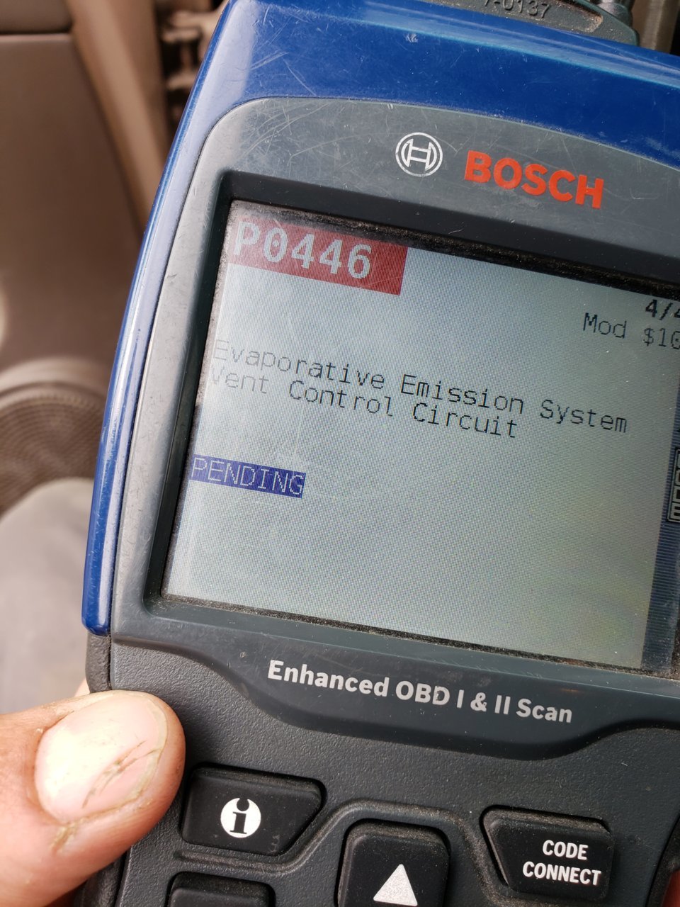

    What does this mean and what do I have to do ?? Thanks!

    The EVAP system carries fuel vapor from the tank into the manifold to be burned.
    The most common reason to throw this code is the Vapor canister purge valve. Fairly easy to replace.
    Could also be something as easy as replacing the fuel cap. If your caps gaskets is dry/cracked you could have a leak there.

    Gas cap on tight?

    +1. Start there.

    I'll start with that and let y'all know if I dont figure anything out . Thanks a bunch !

    If it's like my Yukon it could also mean the vent solenoid is bad.

    Can you be more specific on that please ??

    I havent messed with it and the light hasn't come on since so kind of putting it off for now..
