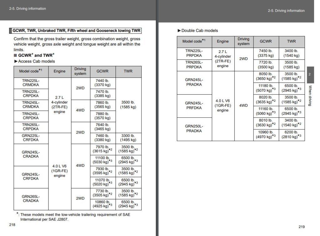

    I've owned my Tacoma since it was new. In looking for parts I looked for 2009, Tacoma, Access Cab, Base, TRD Offroad, Auto Transmission, Towing Package.
    However, when looking for parts I frequently see them refer to GRN2###L - ***DKA
    The sticker on MY truck states that it is a GRN245L CRADKA - What does this code mean, and how do you decipher it?

    Essentially it's the long model code for your truck, it contains information on the configuration for powertrain, cab, bed, and destination country.
