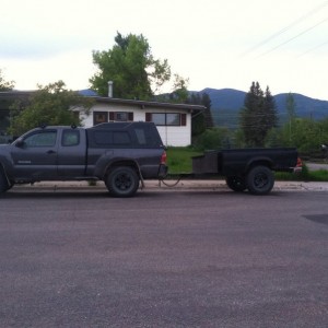

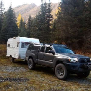

    If you're going to drive anywhere rough, those adjustable hitches will drag bad. I have a different hitch for each trailer. Some of my trailers are lifted, so the drop is flipped to rise 2" or whatever. Just make sure that the ball is the right size and rated for the correct weight. The standard 2" drop will do fine for what you described.
