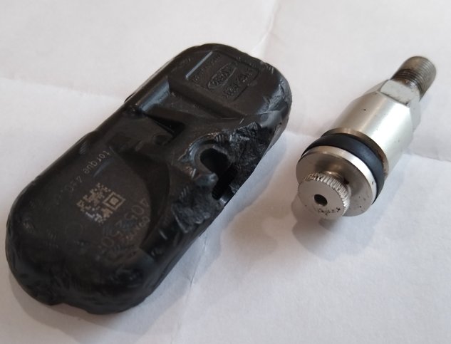

    I've had this cause similar problems. It kept working until the battery died.
