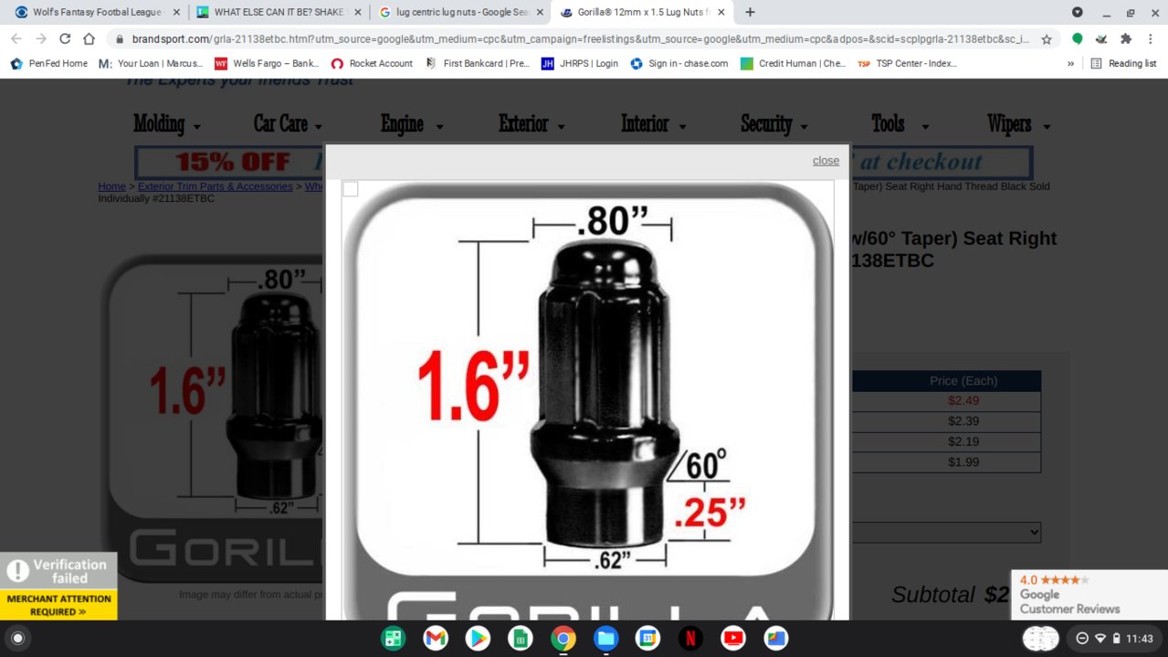

    Check your lug nuts if they are acorn style and your wheel is NOT hub centric then that will be your problem. You need lug centric bolts. I would do the lug centric even if you think your wheels are hub centric. They truly make a huge difference. Most Toyotas have them as Original Equipment.

    This is what you should be running with your aftermarket wheels. Dont mind the specs, the style of lug is what your looking for. Screenshot 2021-09-18 11.43.02 PM.jpg
