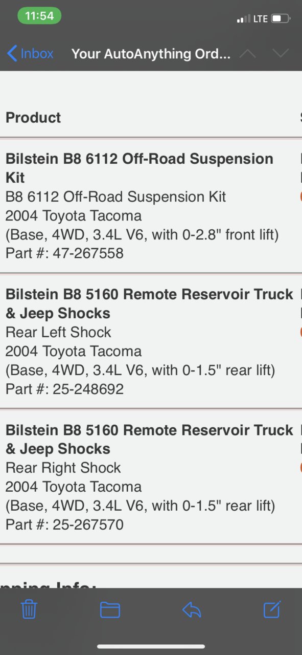

    Can you post the part number of the 5160's you will be using?
    This way we can gather the extended and collapsed length of the shocks. Some websites will say "up to" but it's all really just an estimate.

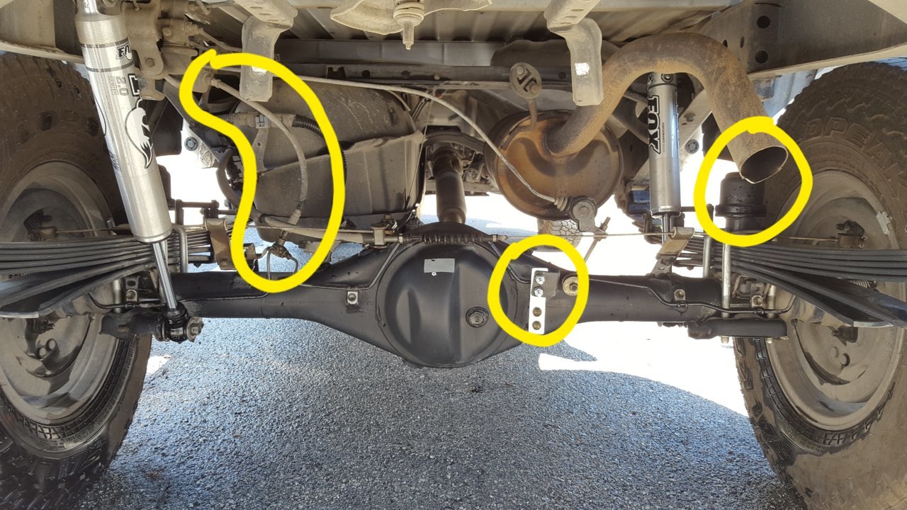

    Some here don't bother with the relocation bracket; I simply cut my exhaust.
    There's also the brake proportioning valve relocation bracket, that helps to maintain the stock rear braking.

    Here you go ...

    The 25-267570 has the length of 13.42 - 21.73
    The 25-248692 has the length of 12.95 - 20.66
    What's nice about this is that they're damn similar to the 5100's at
    33-247717 for 14.07-22.09
    33-247724 for 13.62-21.26
    and the other variant of 5100's at
    BE5-D560 for 14.65 - 22.57
    BE5-D559 for 13.93 - 21.63
    Since the collapsed lengths are actually a tad shorter, just run Wheeler's Super Bump stops and call it a day. As long as you don't lift your vehicle all too much (droop) you shouldn't have to worry about overextending your shocks.

    Since you changed your title again, I'll post pics of what I said I did (or suggested you should do)
    I have rear extended brake lines and I've been too busy to even install it :facepalm:
