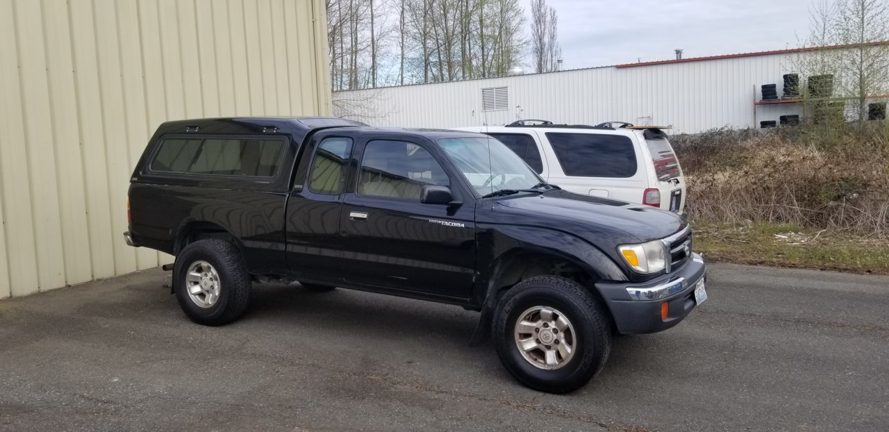

    That's a sexy looking taco :thumbsup: do you have 31s on those 15" wheels? That's still alot of lift up front even with an arb bumper!
    OP here's a picture of my very similar taco with absolutely zero lift and worn out suspension.. just to compare to hammer95 here20190329_090442.jpg

    Thanks, mang! You have a cool truck as well. Yes, those are actually 225/75 on factory OEM aluminum alloy 15” wheels that I had powder coated in black. I got the widest set of tires that would fit on those wheels.
