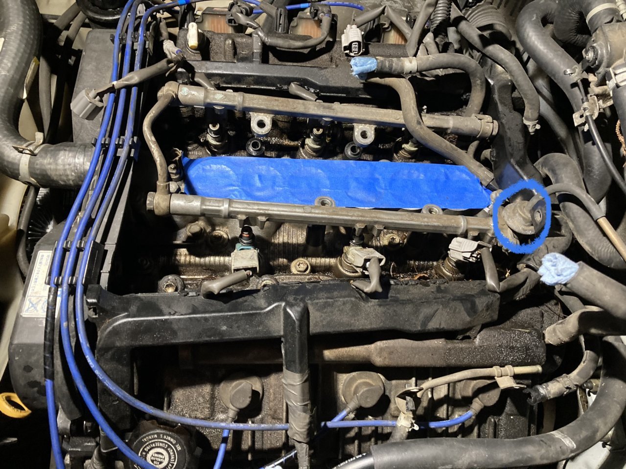

    Is what I circled the FPR? I’m all about it! Which connectors?
  14. Dec 9, 2021 at 6:27 PM
    legalbeagle
    legalbeagle Member
    Feb 4, 2019
    #281796
    7
    95 Tacoma SR5
    Yes. That's the FPR. A few months ago I was doing something similar and had two of the injector connectors break. They get brittle with age. I would recommend swapping out the heater hoses, but after what I went through getting them unstuck and then having to reshape the metal pipes from the heater core they connect to, I wouldn't do that to you.
