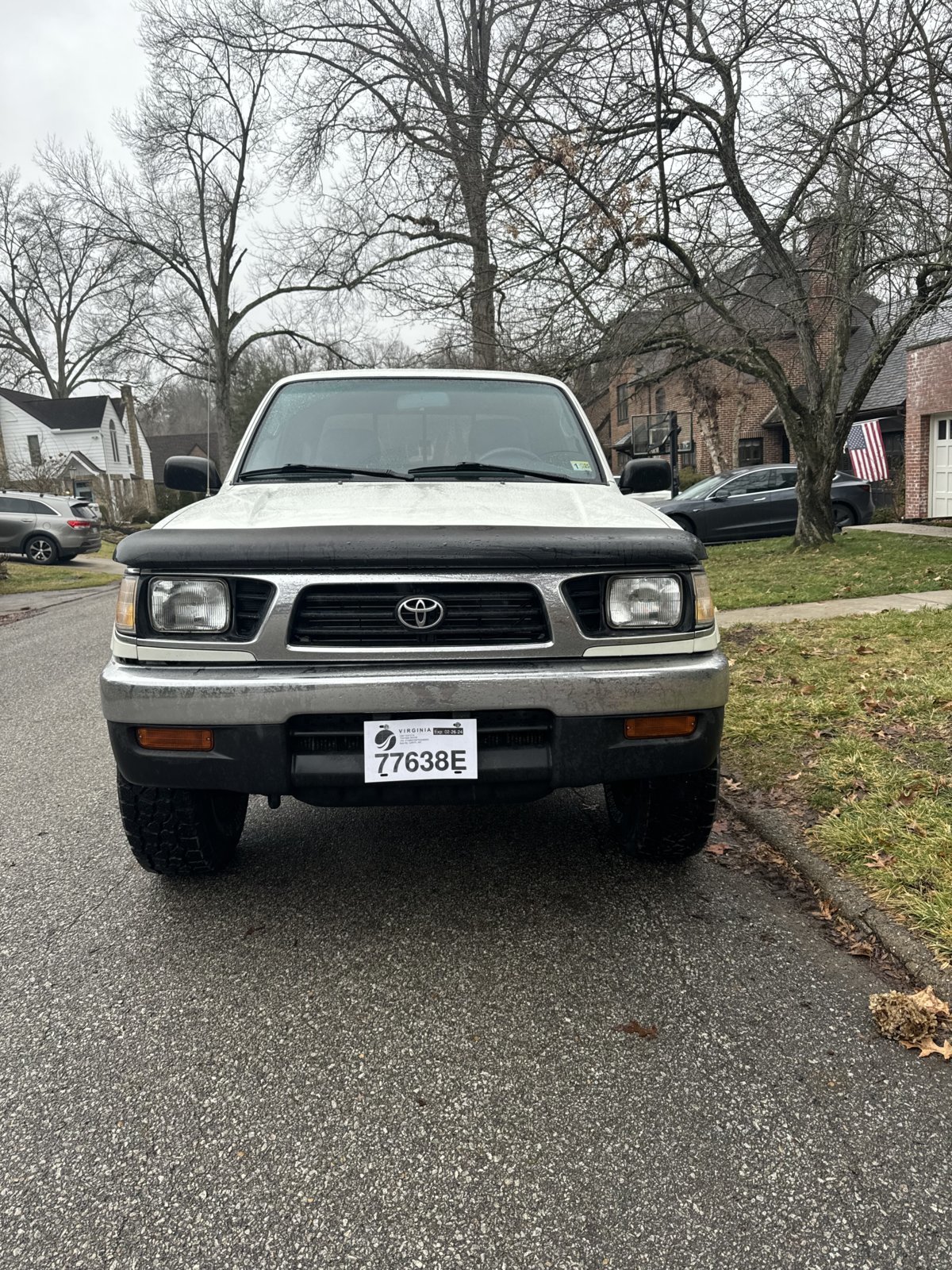

    Hi All,
    I am currently having some gaskets and seals replaced on my 97 Tacoma that has 207k miles. While the engine and transmission are pulled can you recommend some other things I should take care of while I have the opportunity.
    For example, I plan on replacing the clutch components while I am I replacing the rear main seal.
