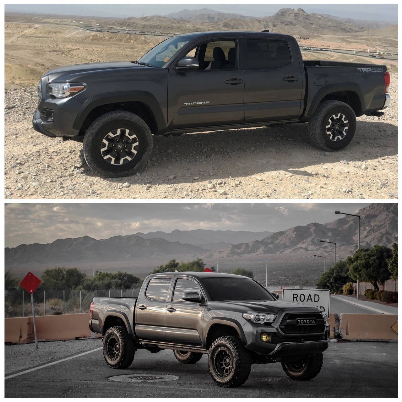

    I had to post a pic to update the post thumbnail. Couldn’t take it anymore.
