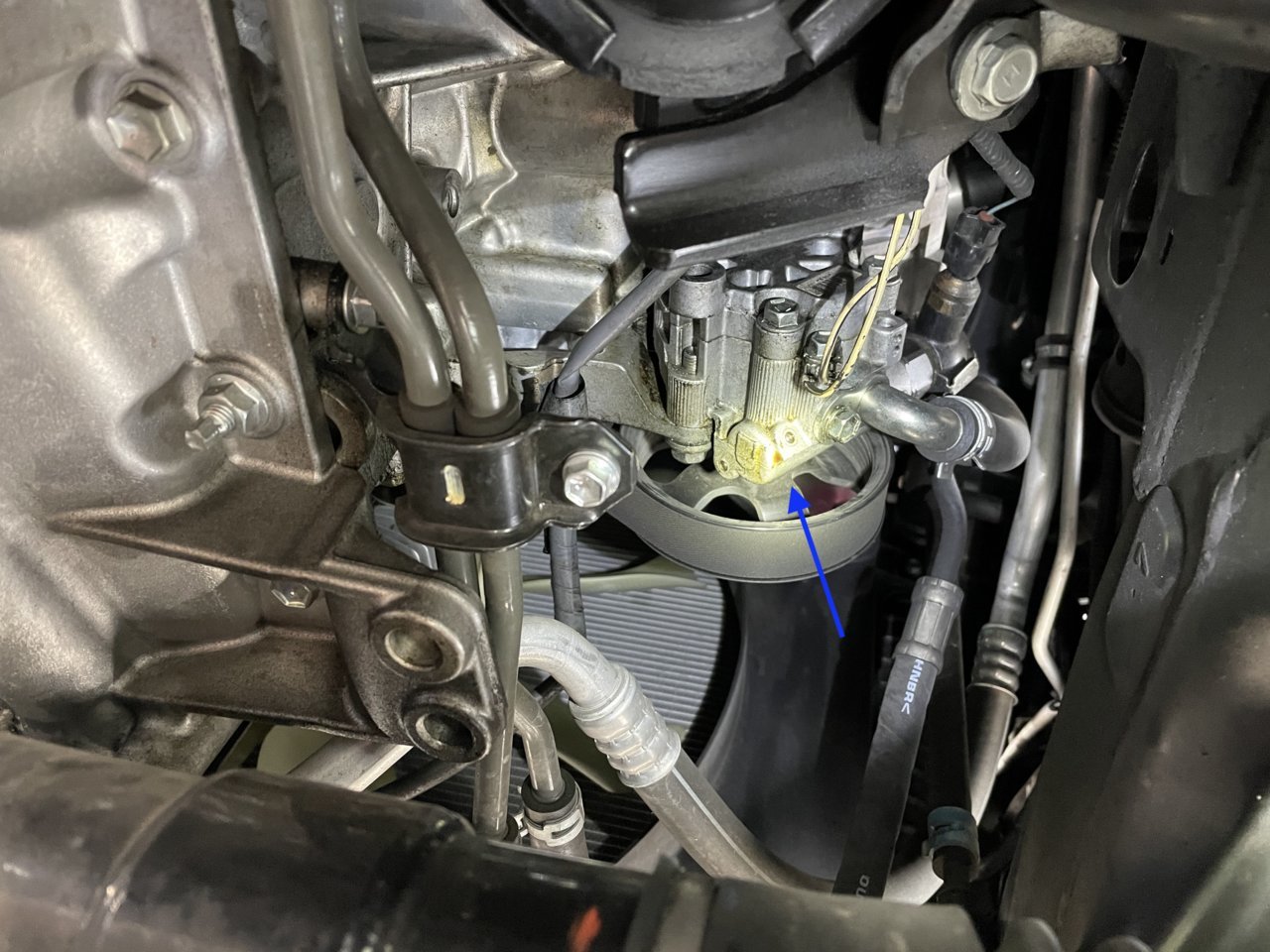

    Hi - Recently purchased a '16 CPO Tacoma TRD Sport 2WD. I crawled underneath the truck when I first purchased and saw some fluid leak underneath the engine area (center).
    I wiped it off and found that it's slowly leaking again after a few weeks. Currently at 60k miles. Anybody know what leak this is so I can fix under CPO warranty.

    Timing cover mostly likely. Dye it and check back.

    Timing cover. It's a big job.

    @thinklambda , You're on a slippery slope. 60t miles and 5 years. Tell the dealer its dripping on your garage take a pic of the drip/s and show it to them eith this pic. Its an expensive repair. Remember to show them and tell them its dripping otherwise you're on your own

    Thanks everybody. Sent it to check at a Toyota Dealer and confirmed timing cover leak. It was a pretty big job and was invoiced ~$3k. CPO warranty covered it since I bought it used and was within first 12 month. Only had to pay the $50 deductible.
