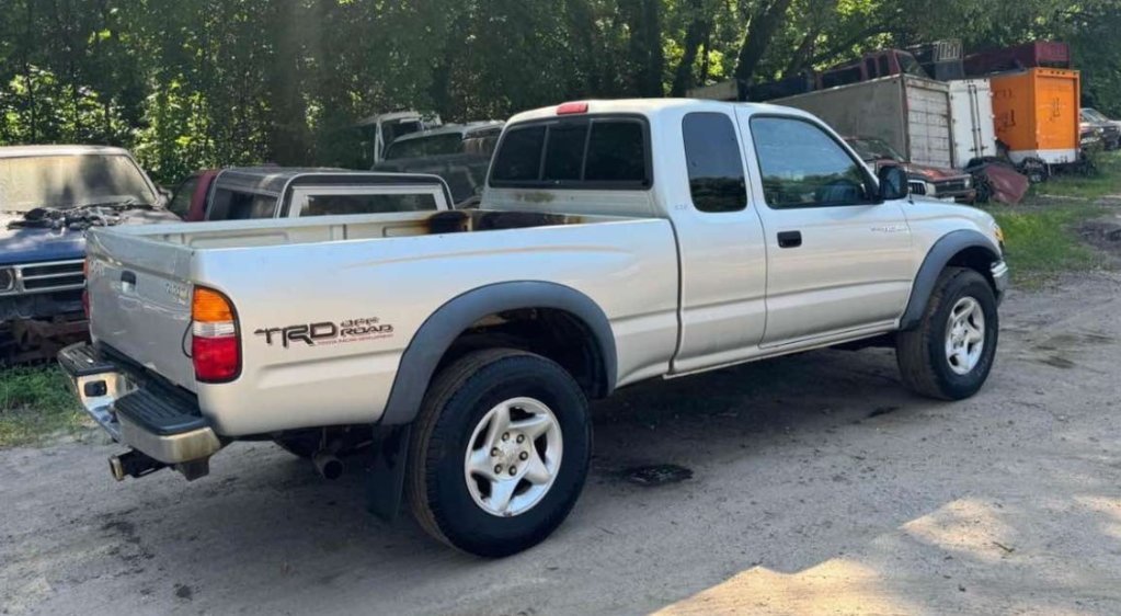

    this is why im asking... didnt even know there was different bed lengths...
    it looks like this:Screenshot_2024-10-30-16-45-56-44_40deb401b9ffe8e1df2f1cc5ba480b12~2.jpg

  5. Oct 31, 2024 at 5:27 PM
    Red_03Taco
    Red_03Taco Well-Known Member
    Nov 2, 2021
    #381170
    1,740
    Jerad
    2003 Tacoma Xtra Cab 4WD
    Any Xtra Cab 6-Lug frame frome 95-04' will work.
    You didn't state if yours was v6 or 4cyl. Or if it's stick vs. auto. I believe those factors can matter (trans cross member location varies between them I believe). But those shouldn't be deal breakers. Just don't buy a 5-lug frame
