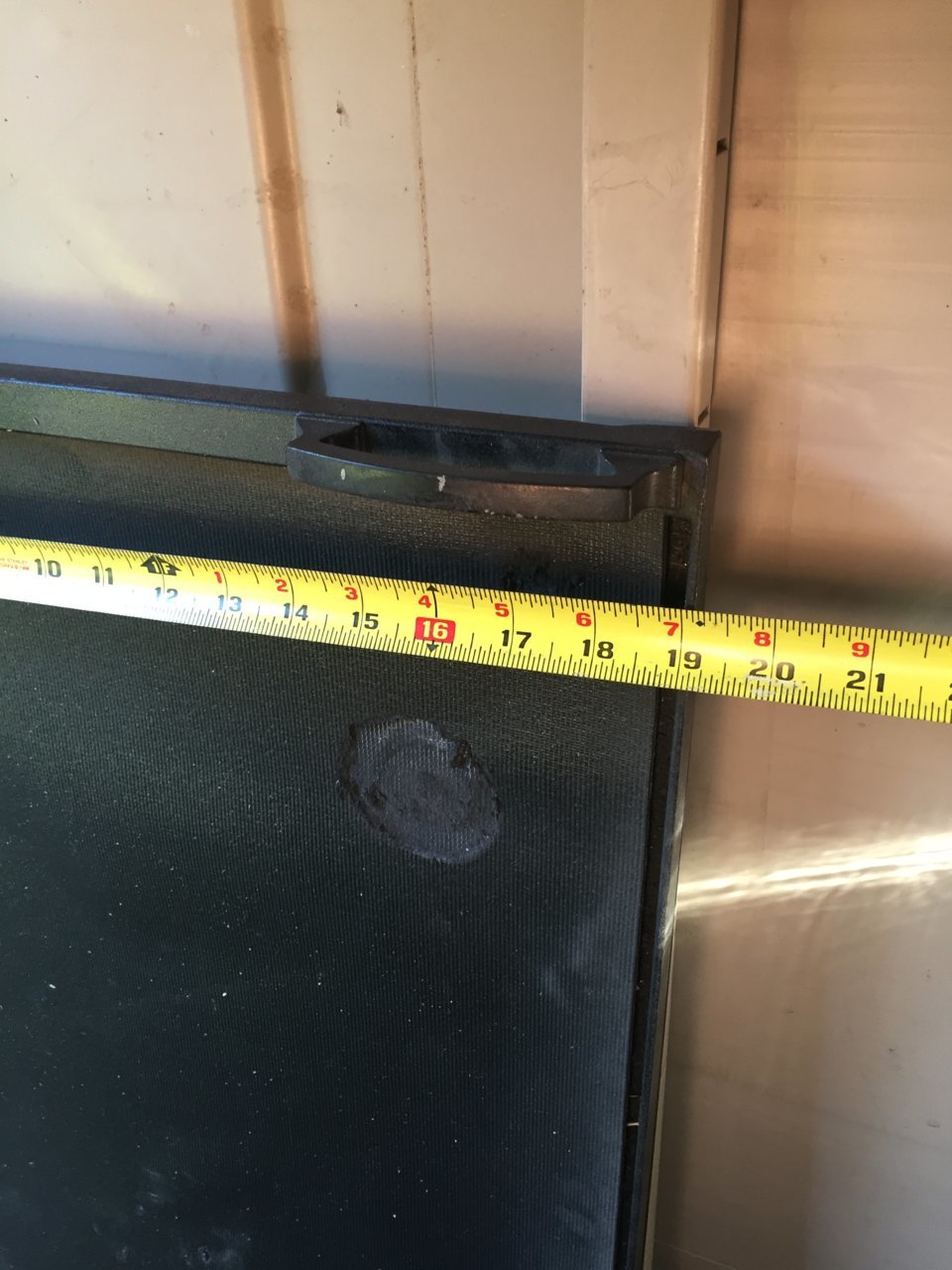

    Looking into a new fridge. I need the biggest one(height wise) that I can fit under my Diamondback. Dometic CFX 45 should fit, but I also want to build a low profile sliding tray. What say you folks??

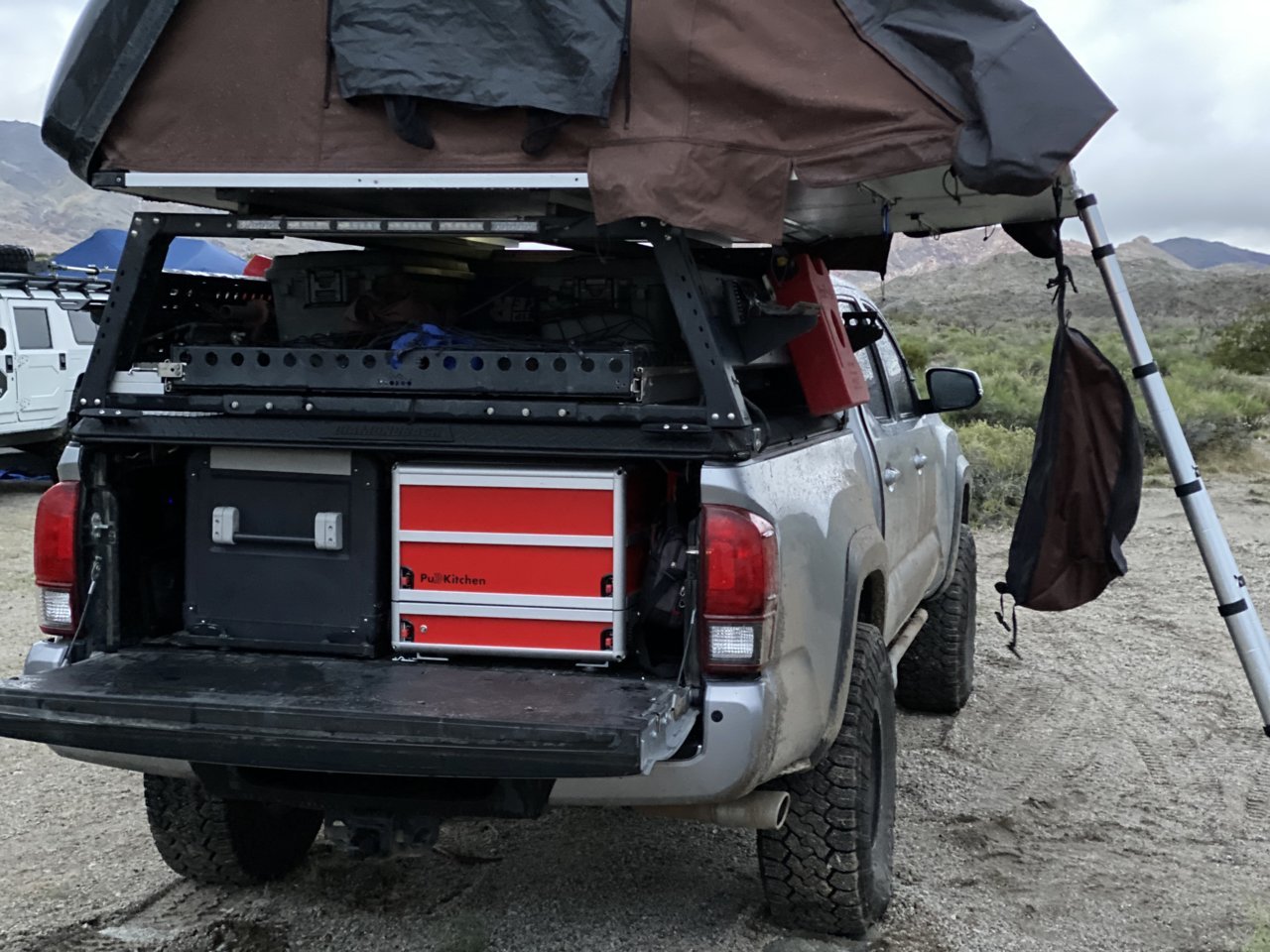

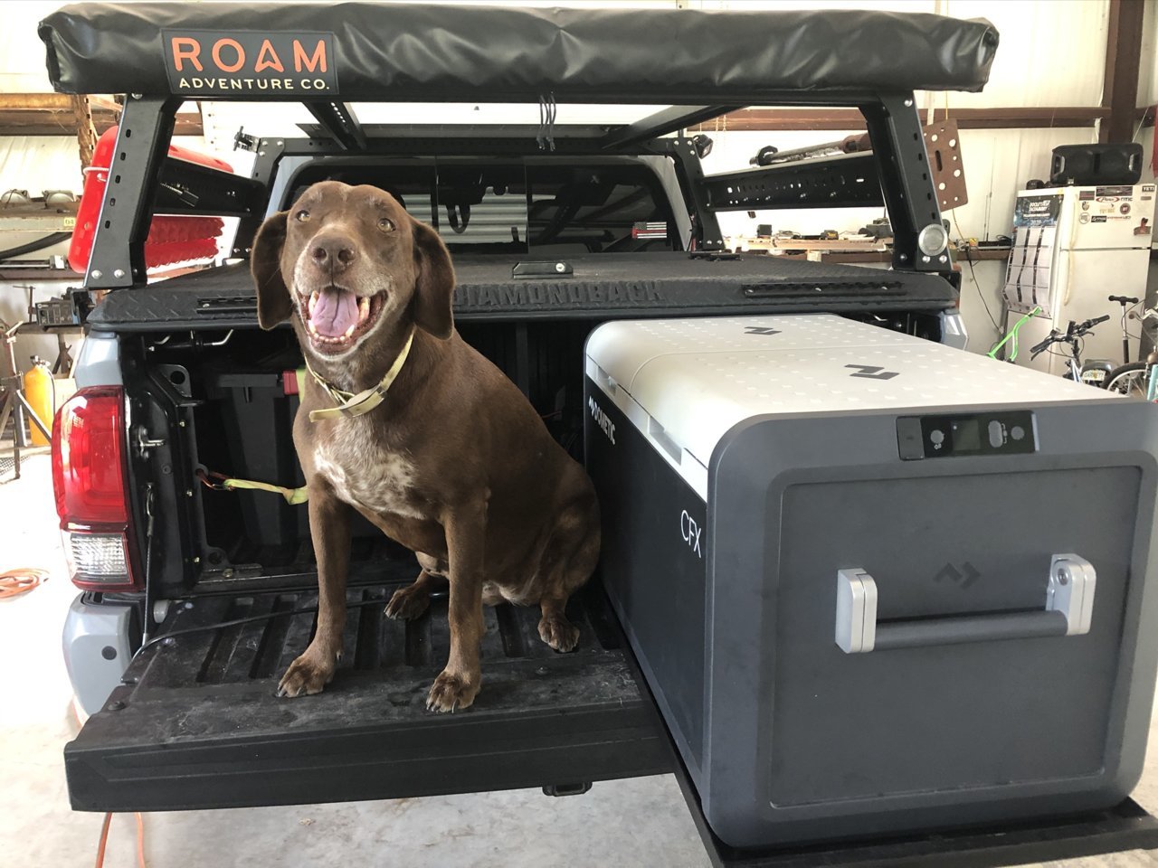

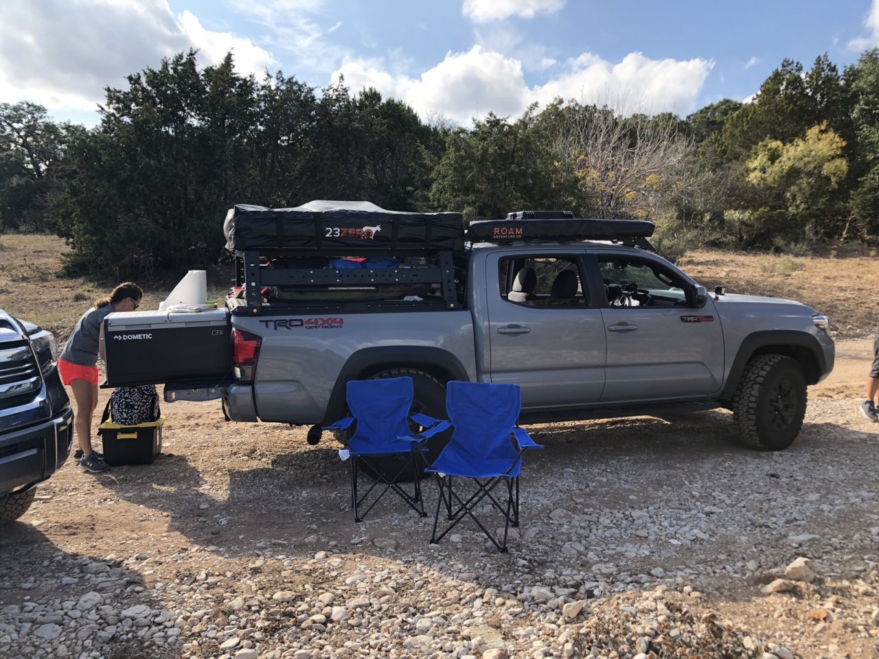

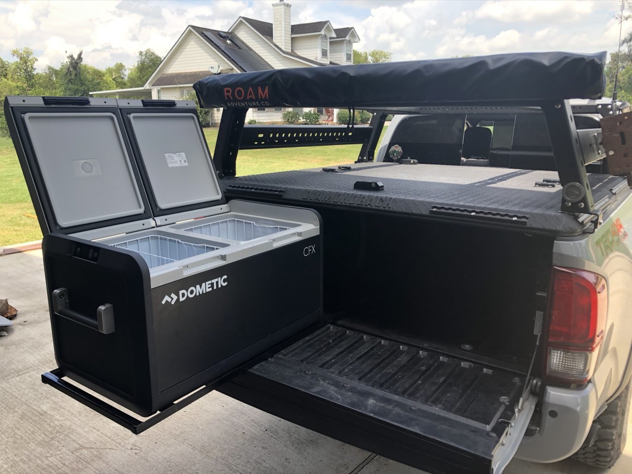

    I made a DIY fridge slide to fit my Dometic 75DZ under my Diamondback cover.
    I used square tube welded to angle iron and sheet metal, anchored the rear with T nuts to C channels. Simple but works great.

    Honestly, your build was my inspiration. I’ve been looking for your post on this slide but couldn’t find it. Do you mind giving more info on the slide? Where did you find the rails? How does the tray slide in the rails?

    Glad it helped! The build is under the voodoo rack diamond back thread I made. I also posted a build thread on the Overland Bound DIY section. www.shorturl.at/acnoz

    Hey man! that slide for the domestic looks amazing, anyway you can share with me what and where you bough everything needed to make it happen?
    I want this fridge and I am getting the cover soon, but seems that the OEM slides will not fit in our bed :( with the Diamond, meaning most likely only option is the DYI

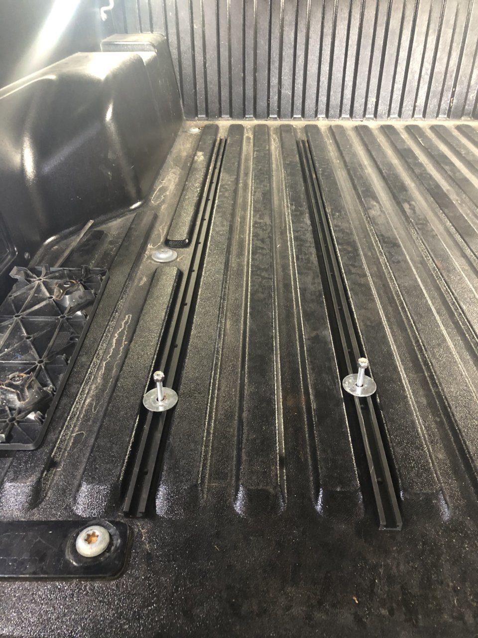

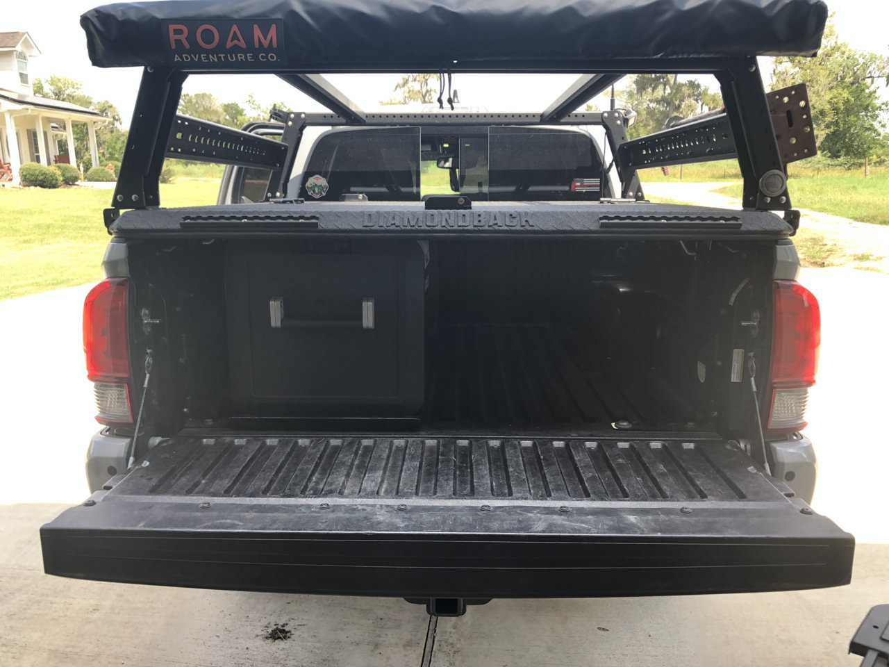

    Not trying to step outta line here, but I think I can answer since I copied his design.
    Not sure we’re he got his materials from, but I went to my local steel supply and fabbed it myself. Found some table saw tracks on Amazon, and bolted them in the bed. Welded two T nuts to the frame, then skinned the bottom with some thin aluminum. Painted it black and put it to work. I ended up mounting it on the drivers side, that’s why the pics show both sides. Sorry for all the pics.....I like visuals.
