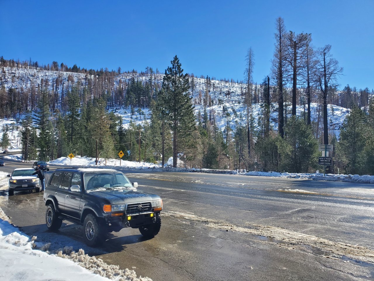

    8 months has passed since posting that and yeah I can say I absolutely love my Sparco!
    Stupid comfortable and my last decent drive was just yesterday coming back from Lake Tahoe (six hours).
