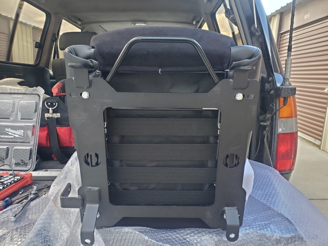

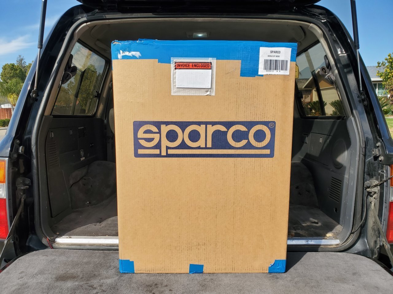

    Here's how my setup arrived, seat in a big ass box -
    Followed by whatever else you ordered in a separate box -

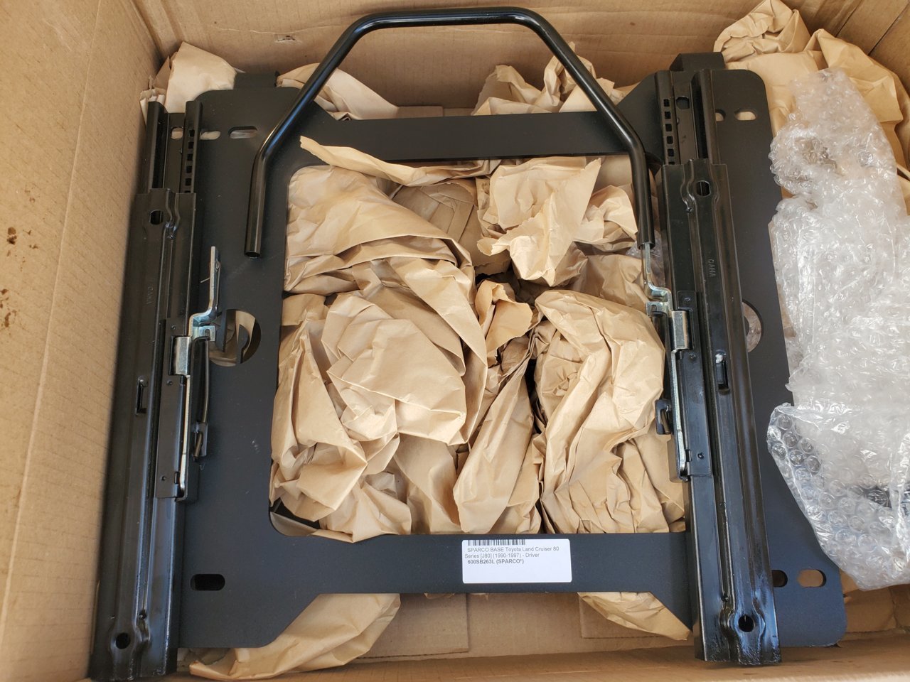

    I do believe there's an option for buying the hardware too; I completely missed it so I had to buy some locally. Believe it was M8 I used -

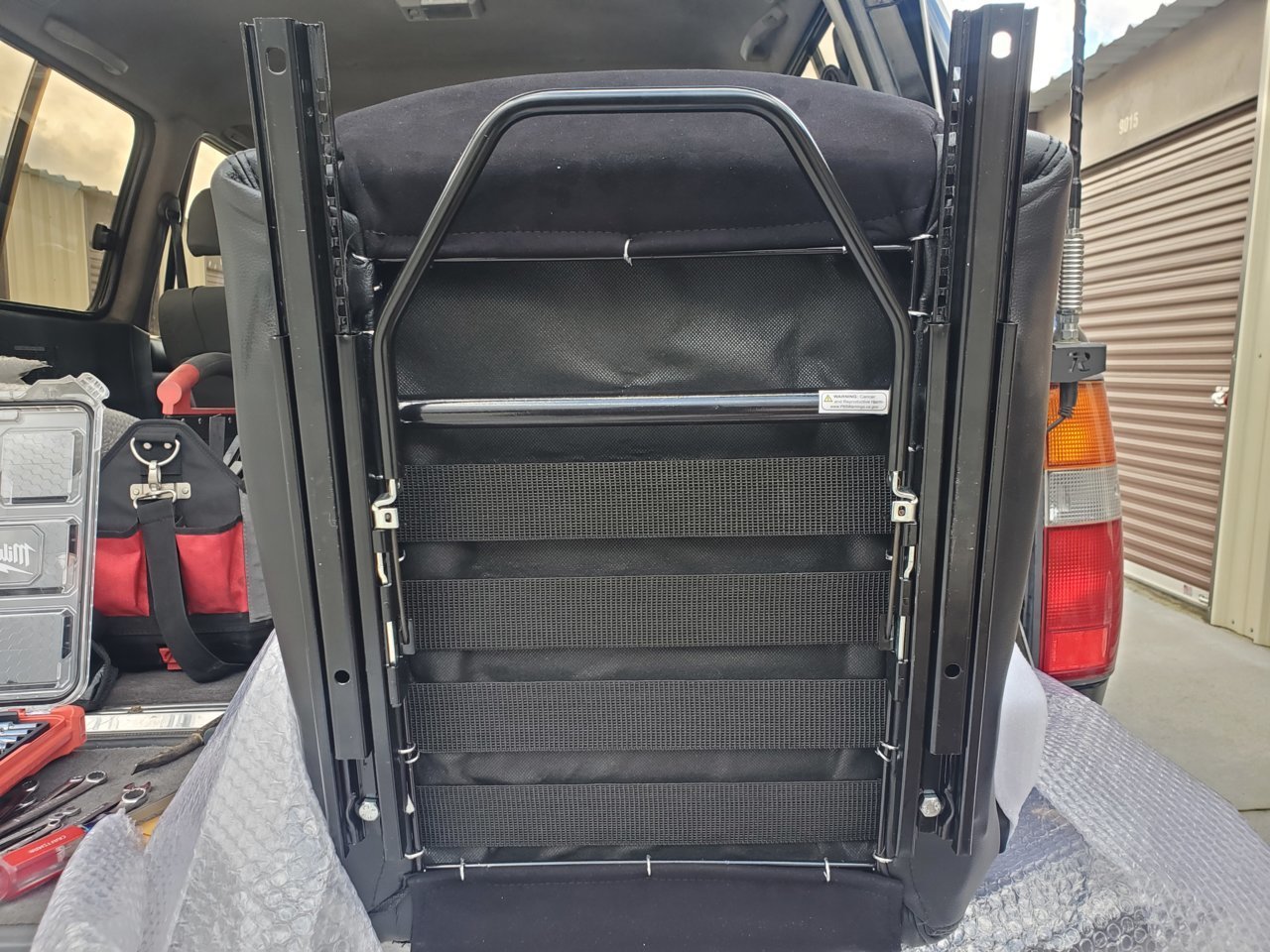

    Assembly of the track slider -
    Followed by the base -
    I don't recall if instructions were included...it's been awhile. But it's self-explanatory really and you'll have no issues at all.

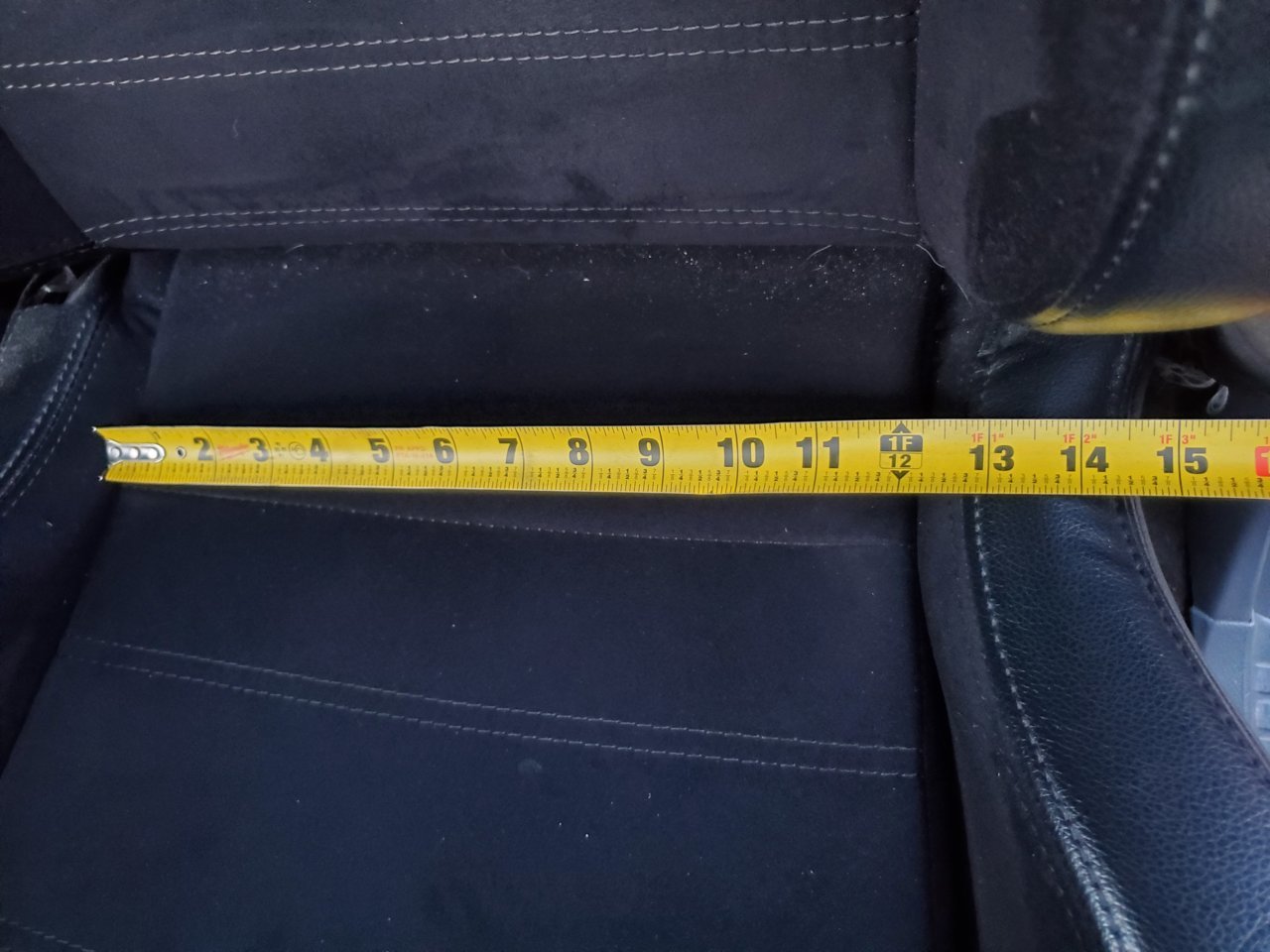

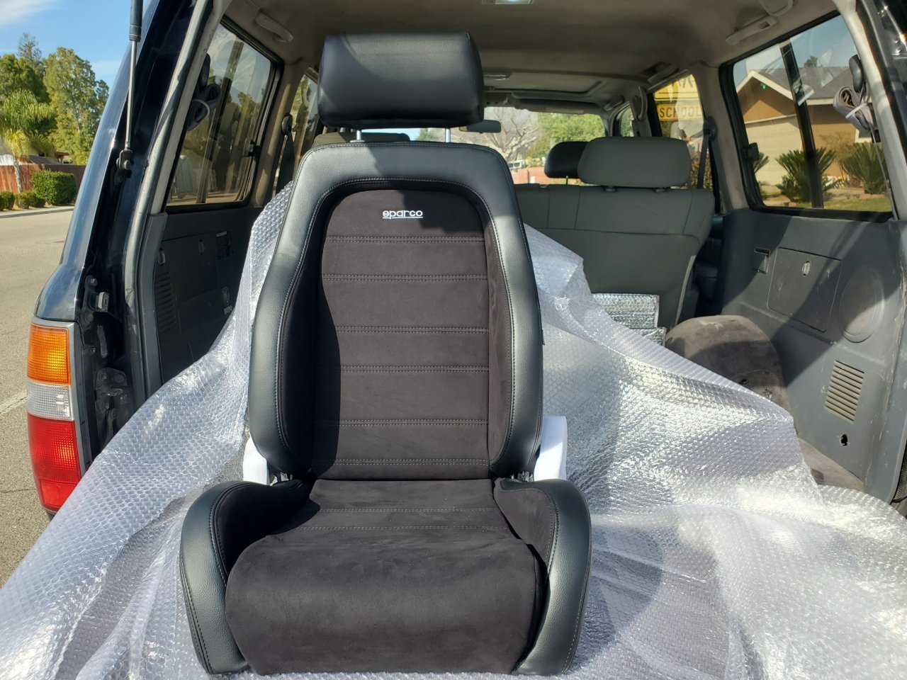

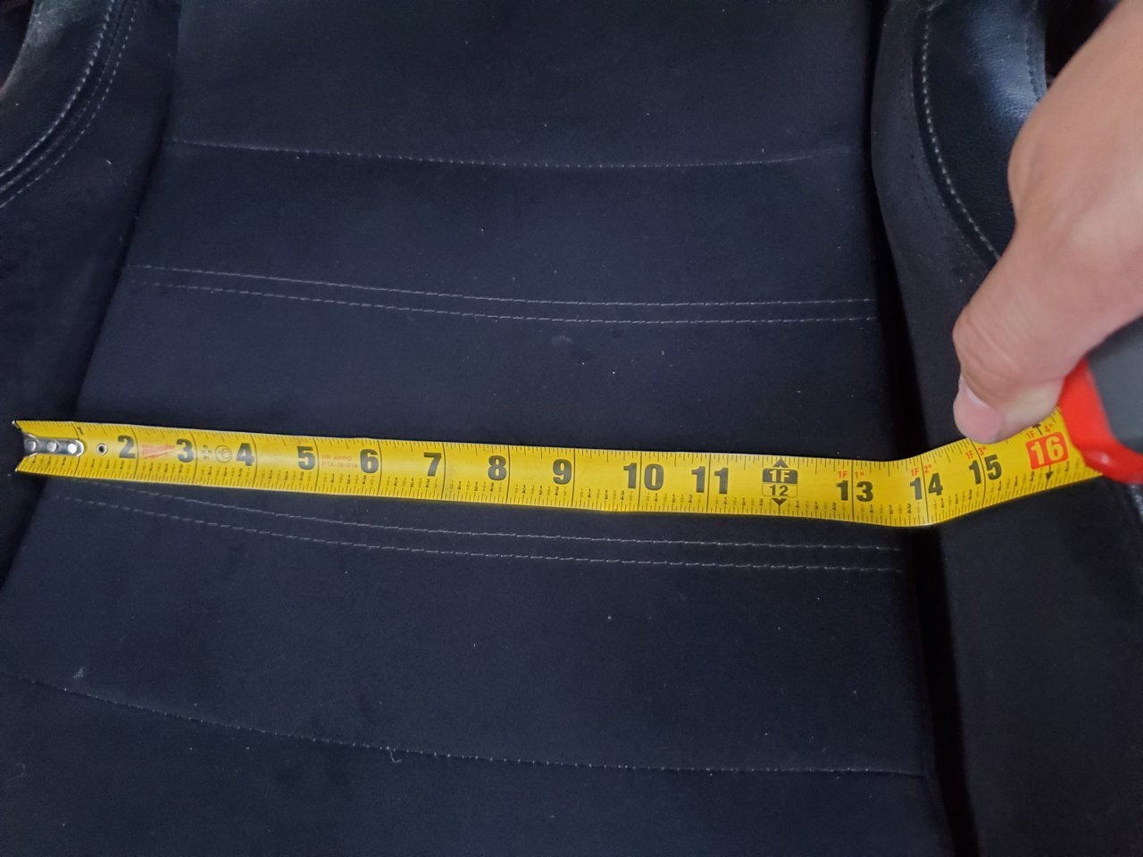

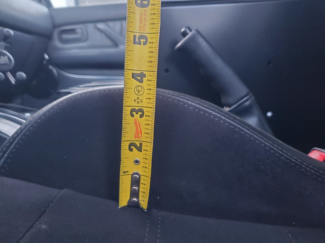

    I currently have Corbeau Baja XRS seats. The seat bolsters are only 11.5" across and were agonizingly painful.
    I had an auto upholstery shop remove as much bolster as possible, but I still fidget about all trip.
    Your seats look like the Sparco GT's. I've been looking at those as a replacement.
    Would you please measure the space between seat bolsters?
    Kwikvette[QUOTED] likes this.

    The rearmost part of the seat has a gap of 12.75" between the bolsters
    The center part has a gap of 14" between the bolsters
    And the bolster at its highest point is approximately 3.56" from the seat bottom
    btu44[QUOTED] and Madjik_Man like this.

    Thanks Xbeaus and Kwikvette. These pictures are a big help.
    Is the bolster at the 12.75" gap pretty soft and crush down. My hips measure about 17".
    The Baja XRS seat bolsters have metal bars to hold them up. Takes a few times to figure out how to exit the truck without crushing the tenders.
    Xbeaus and Kwikvette[QUOTED] like this.
