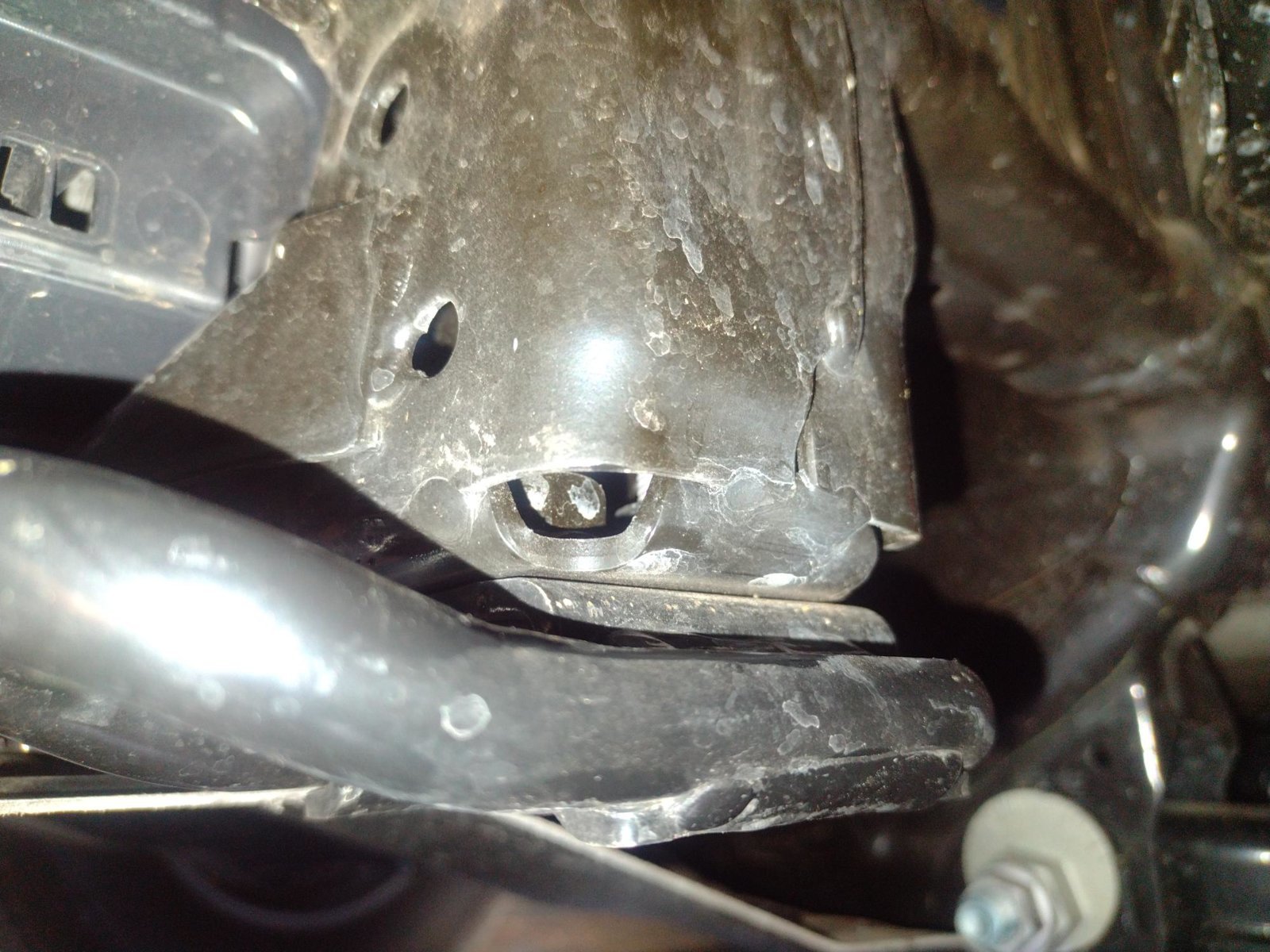

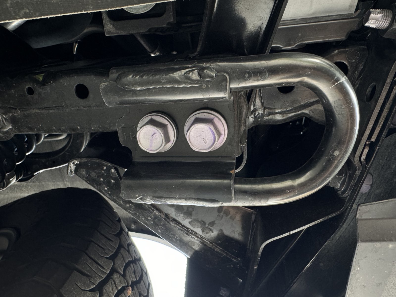

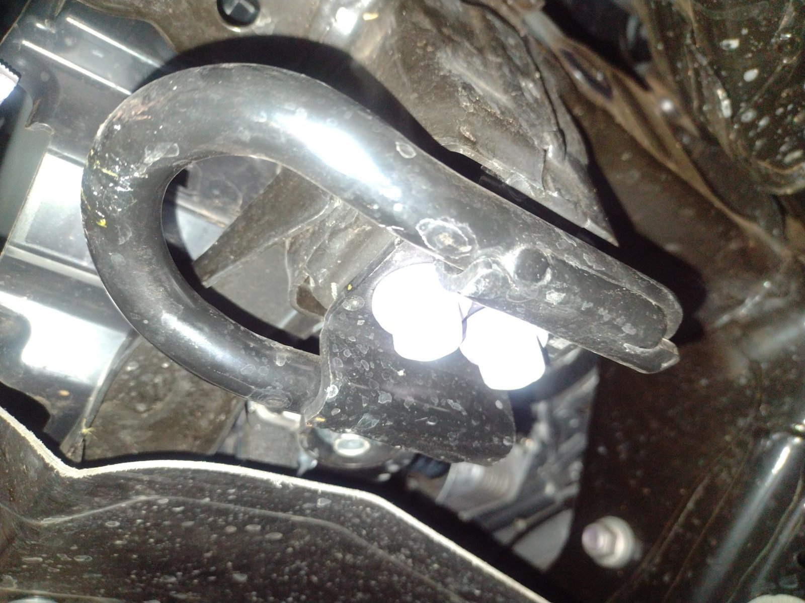

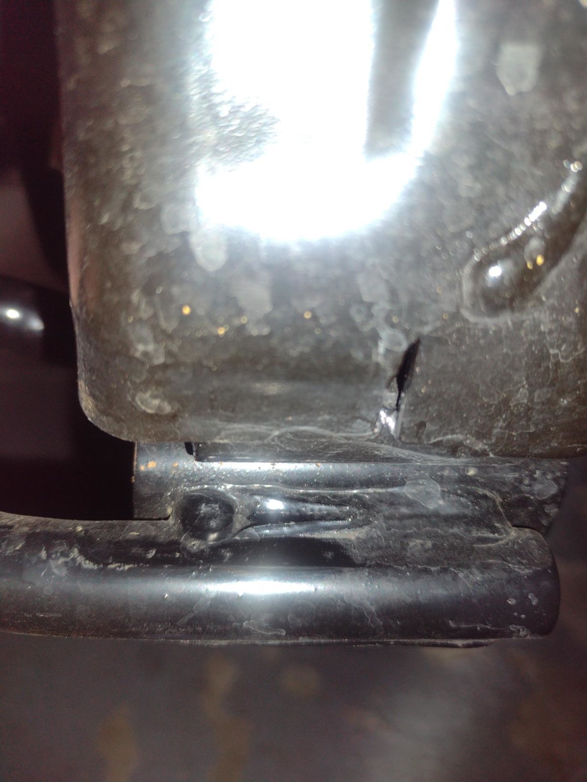

    Tooks some pictures and measurements of the stock recovery points on my OR.
    hoops are 5/8" and double welded onto the 4mm mounting plate.
    Bolts look to be 12mm (didn't take them out to check) I can't find the bolt-head marking (single radial dash) on any bolt ID tables so far. If someone were worried that much then the thing to do would be track down some 10.9 bolts (120,000 psi proof load, 150,000 psi min tensile strength).
    Looks like a full hex nut is welded inside the frame stub.
    Based on my decades of experience in listening to other non-engineers talk about engineering stuff about which they have no clue ;), I'm going to say that the failure point would likely be the bottom plate of the frame stub tearing off.

    If that's the case then replacing those loops with something more robust doesn't increase the reliability of the recovery point, it only moves the failure to a more expensive part. They do not look janky or meek at all in their stock form.
