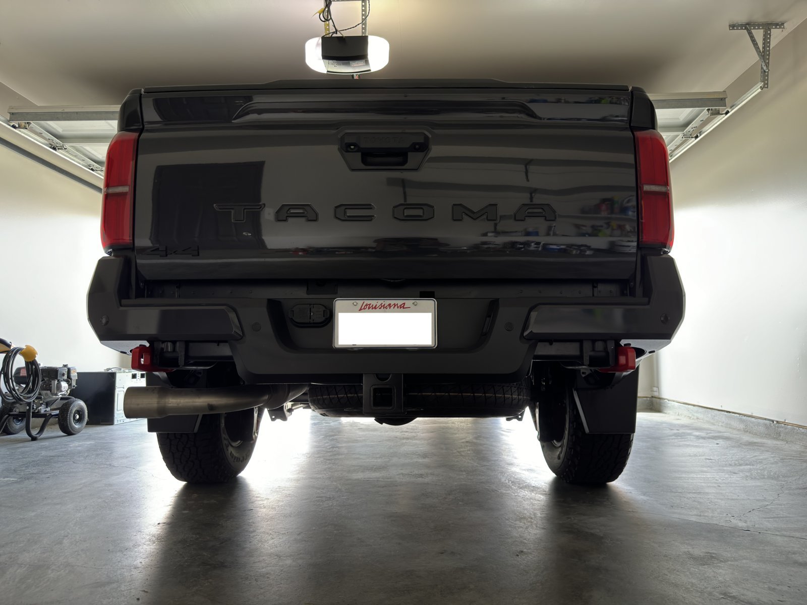

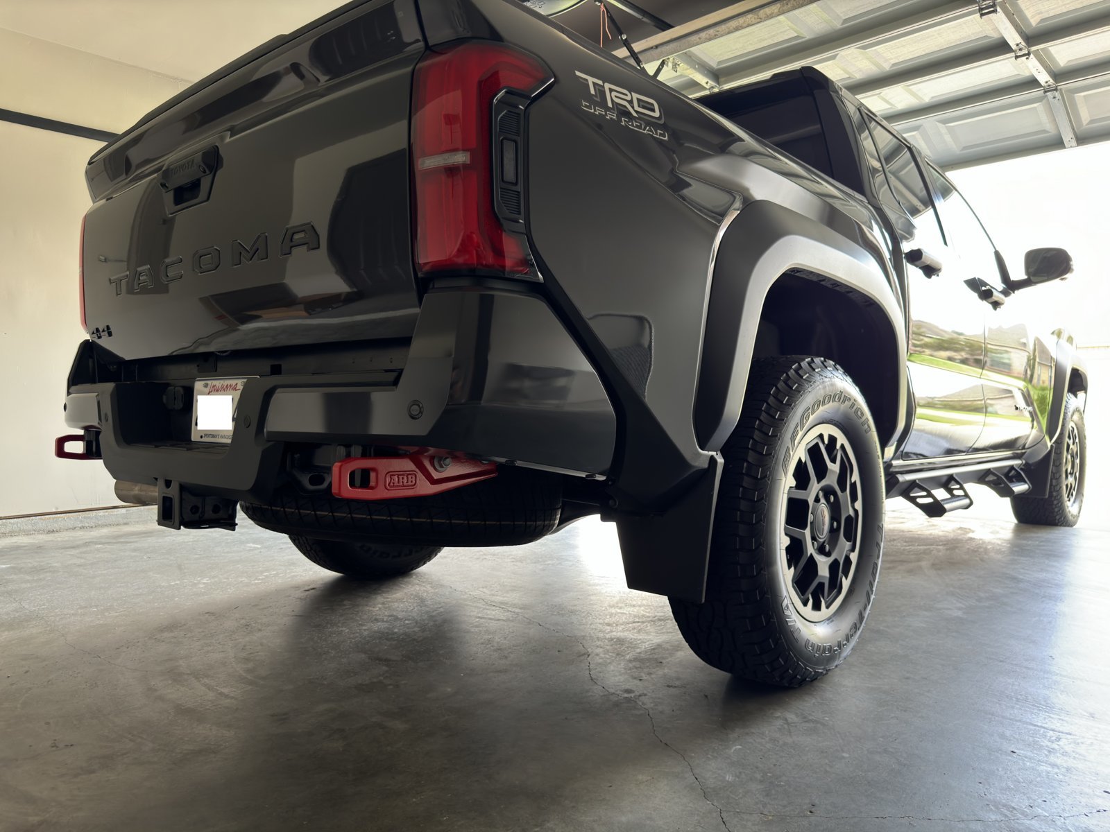

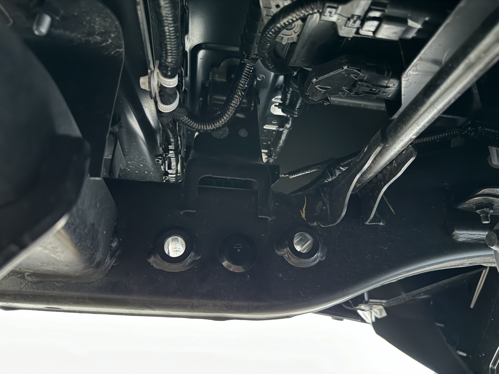

    Installed the ARB Rear Recovery Hooks. Instructions came with hooks, attached. Interesting that the truck 3D model has "ARB" logo on the rear bumper.
    10lb 14" x 4" x 3/4" Steel (each hook)
    0.6lb M16 x 130mm Bolt + Nut <unknown material> (each bolt)
    Bolt / nuts are the weight and color of aluminum, but are indeed magnetic. They have the same one-line head as the front hooks. DP can for size.
    Hook holes must have welded inserts to be compatible. Do not need to remove the center hole cap.
    Installed

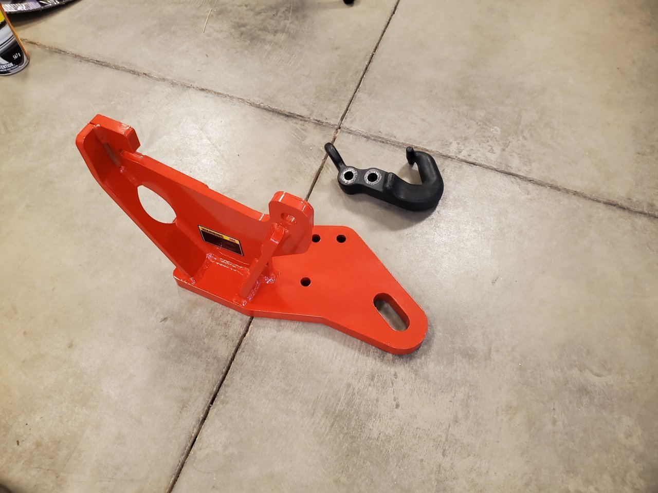

    ARB's stuff is all legit. They engineer everything with, you know, real engineers, and test / rate their recovery gear with published working load limits, etc.
    If there isn't an ARB front recovery point yet for the 4th gen, wait until there is one.
    Here's what the 2nd/3rd gen one looks like. It's around 20 lbs of massive beef metal and it is RATED for 17,600 (seventeen thousand) pounds when pulled from any angle within the left/right sweep of the front tires.
    The point of having a recovery point rated that high is two-fold:
    1) You don't have to think about whether it, or the vehicle frame, is going to bend in any recovery scenario.
    2) It'll also easily handle whatever dynamic loads may occur during snatching and/or if the truck gets momentarily stuck on an obstacle of some kind like a rock or stump etc.
    There are 3 bolts visible, and 2 more besides (not visible in this photo). It makes a massively strong/stiff L-shape. Only downside is this old 2nd/3rd gen version (released about a decade ago) does not have radiused inner corners on the shackle hole so it is not directly usable with soft recovery shackles etc. Needs a D-ring, but that's OK, proper D-rings are megastrong.
    https://store.arbusa.com/recovery-point-2823010/

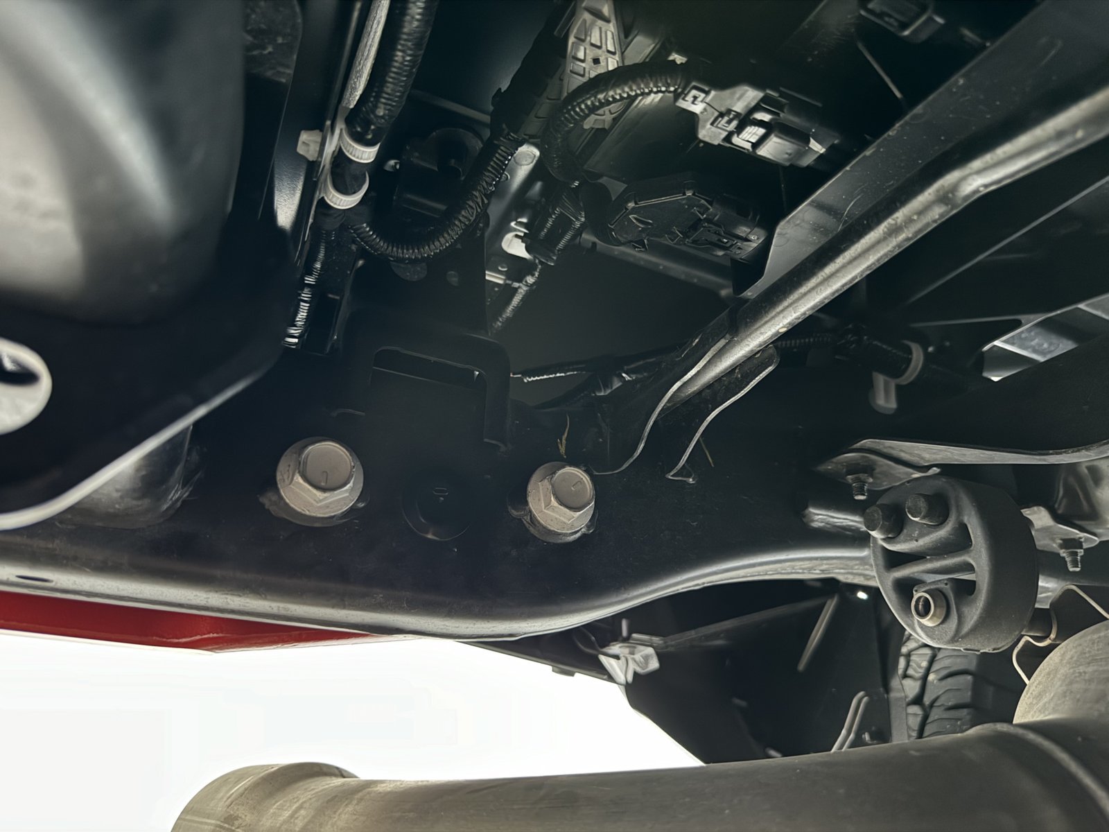

    I wondered why there was no ARB front recovery point on the Toyota parts site. Have been trying to decide if I should get one of the available aftermarket points to make anyone trying to pull me feel better. The stock ones look plenty strong enough to rip the frame plate off where they're bolted on.

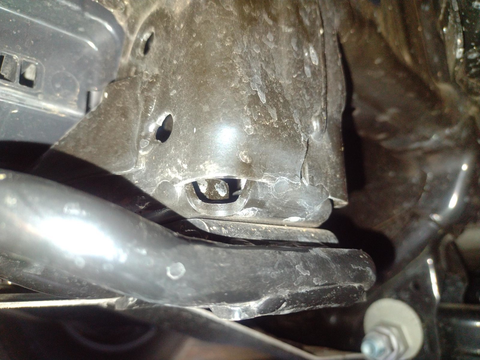

    I'm thinking that welding is going to be the only serious answer for this. Those two bolts and the frame appendage are just not ever going to be enough meat for the kind of force that the pictured 2nd gen ARB bracket will handle.
    A suggestion - replace the flange screws with hardened capscrews and hardened flat washers (not stamped or crowned). Metric 10.9's are about all the nuts will handle - but get all of the grip you can. Flange screws often give false torque indications due to drag. Buy these hex head screws from John Deere, Komatsu or CAT - not some "will fit" hardware supplier - get them from an organization that has real world quality controls. CAT has a catalog called "One Safe Source" and I've used it in several places around the world to get the right stuff by part number.
    Fully weld the boxes to close all of the holes and bend relief cracks. The photo shows something that could be rated for a shipping anchor - not an impact worthy frame mount. It needs to be completed. Use a wire brush or sanding disc to be sure that paint, rust and dirt don't contaminate the welding - shiny metal is the answer. You may have to remove the hoop bracket to complete this - be sure the clamping surface is left clean and flat for final assembly. Prime and paint the welds.
    After the final assembly - find a hole and squirt the interior with cosmoline or some similar rust prevention material. You don't want the box and hardware degrading in the future with no way to check it. In my world (mining machines) we would place a tack weld on the back of the bracket and inspect it after use (or before) to be sure nothing has moved.
    When you use these anchors - use two, both sides need hitched - easy to double up.
    I'm positive this writ can be refined - but this would be a start.....

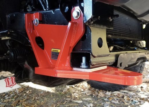

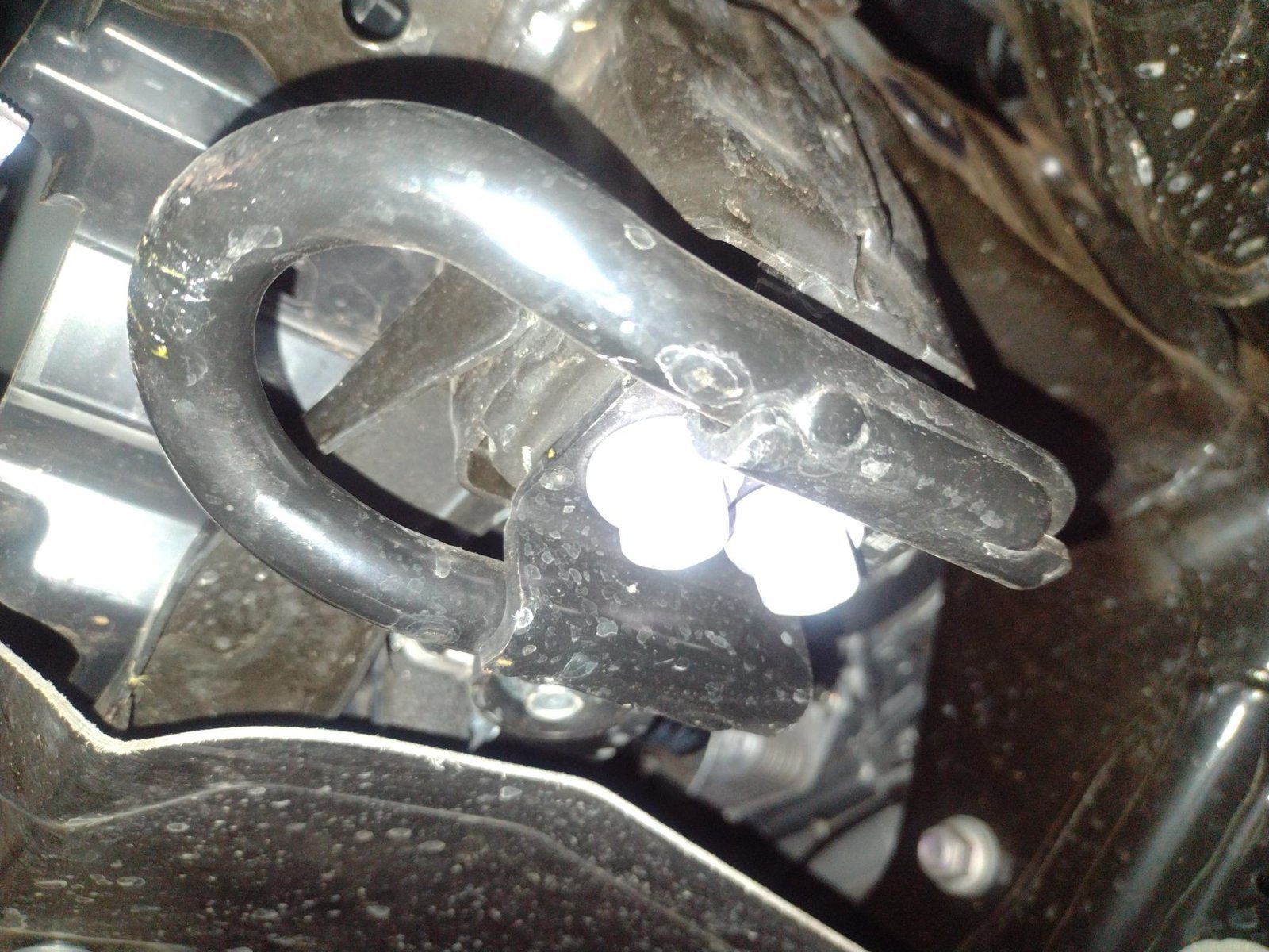

    Here's a visual comparison between the ARB 8.5-ton rated recovery point and Toyota's heaviest-duty factory front tow point, as shipped on 2nd and 3rd gen TRD-OR trims.
    Can you yank on the factory Toyota heavy-duty tow hook? Sure you can.
    How hard can you yank? I don't know. Toyota certainly knows but isn't telling.
    Good luck & use good judgment when trying to yank on it.
    The issue isn't the construction of the hook itself, the body of which looks to be at least 1" in diameter and forged steel. That's great. The hook alone, in a test rig, probably wouldn't break until somewhere past 15K lbs.
    The problem is in how that hook transmits pulling forces to the frame, through only 2 bolts in a single plane in a small area.
    By comparison the 17-pound ARB contraption uses 5 bolts spread out over multiple planes and a much larger total area.
    (Pic borrowed from someone else's post on TW forums.)

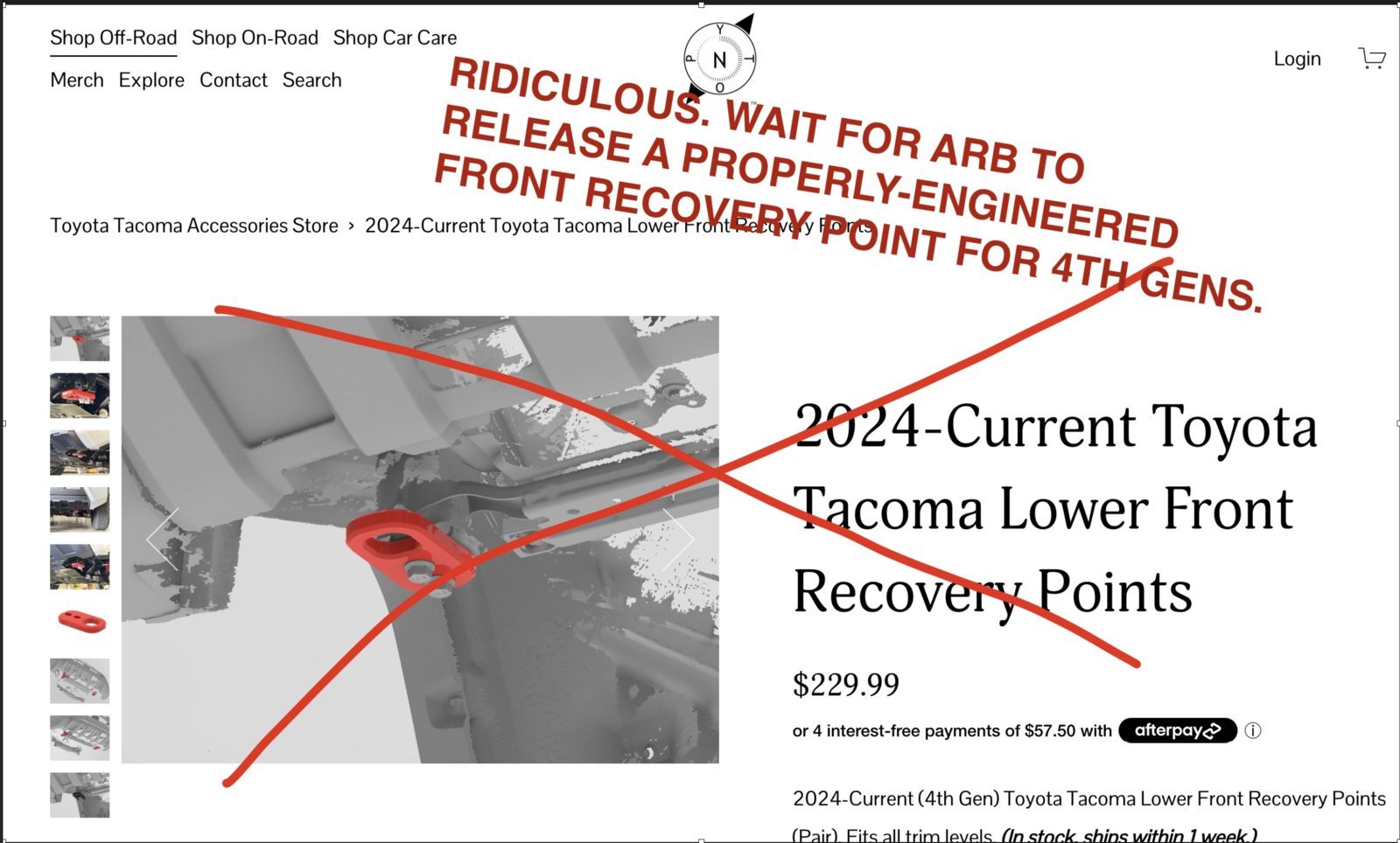

    I'm just going to call out this "NYTOP Front Tow/Recovery Point" as another ridiculous product. This piece of machined steel probably costs less than $10 a pop to make and it has no more strength than the standard Toyota TRD-OR tow hook. They can rate it for whatever they want -- 9K, 11K pounds, it varies depending on the website -- but it's just 2 bolts in a single plane, the same as the Toyota TRD-OR tow hook. In a test rig, the piece of steel itself may easily handle the 10K+ pounds, but the 2 bolts & frame where it attaches probably wont.
    $260? I hope that's for a pair of these. Regardless of whether it's a pair or not, the actual ARB 2nd gen recovery point only costs a bit more, at $310 for an engineered product that is going not going to warp or bed a front frame rail in actual use. (2nd/3rd gen version. Obviously ARB hasn't released a 4th gen version yet.)
    For a mall crawler with money to set on fire, who cares, throw these on the truck and look rad.
    If you may ever actually need to attempt a recovery from vehicle front, as with the Toyota factory TOW HOOK, good luck.
