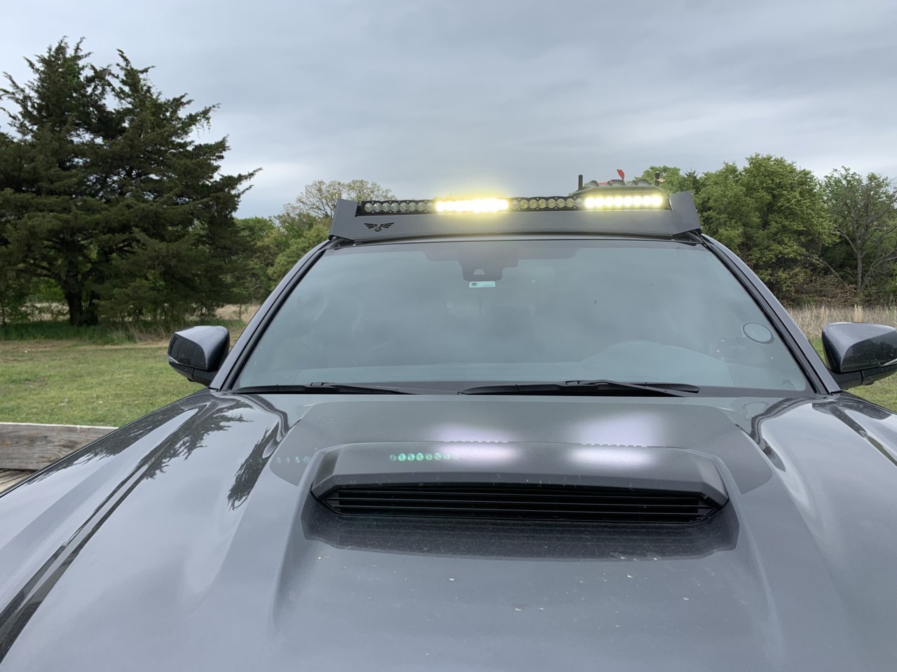

    What an I doing wrong? Thought it was the gauge of wire. Just removed the 16 ga and went to 14 and still having issues. Is there a way to test just the light? I have a multimeter. Also considered removing the light and going directly to the battery with a 1ft 14-16 ga cable to rule out power and/or cable issues.
    what’s wild is, the section on the far left was lighting up at first but now it won’t light up either. Basically, was getting 3 sections to light up but am down to 2 now.

    Kinda suspicious that exactly two pairs of eight are on and two pairs of eight are off. That suggests a defect in the internal wiring.

    i flipped the bar to shorten the run to where the cable goes down my drivers side window straight to the fuse box. I ended up running the bar straight to the battery and still had 2 sections not light up. I sent it back yesterday.
