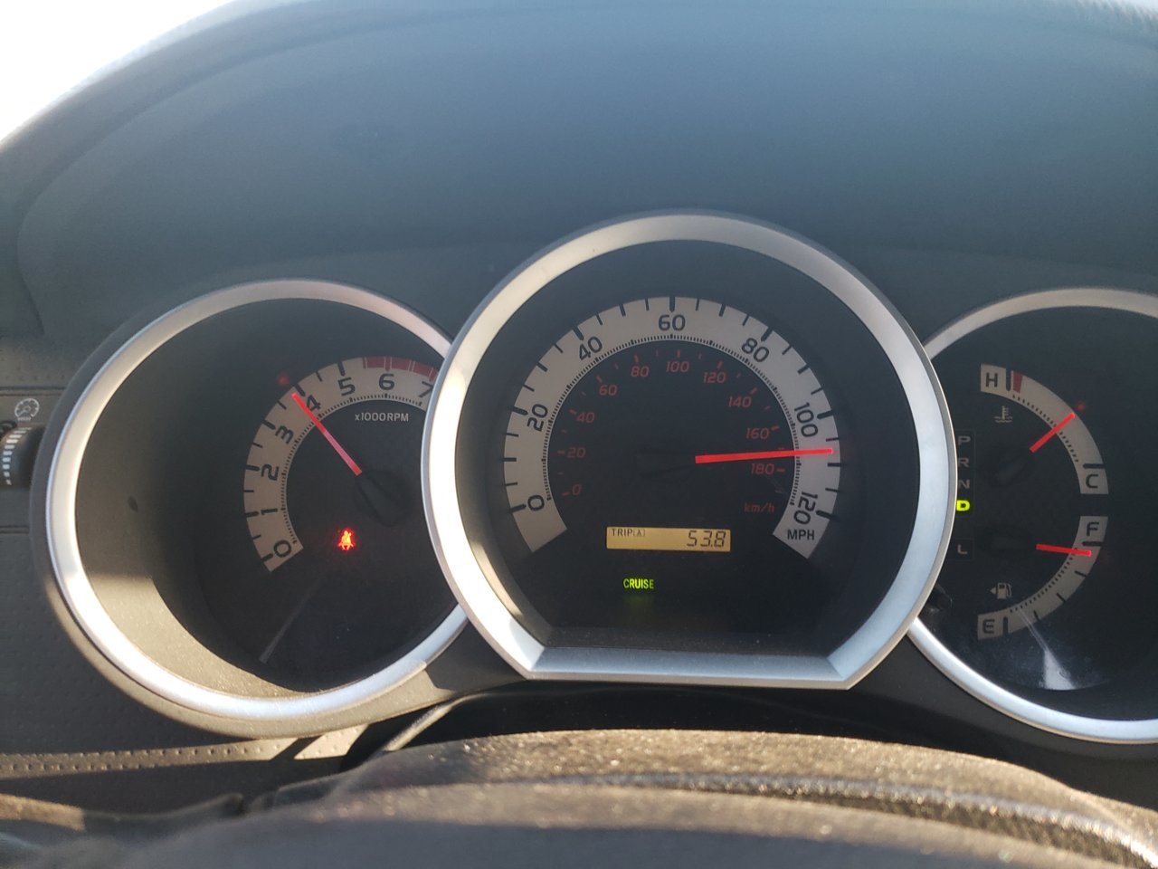

    Didn't know the silly things will go that fast...

    They could go faster if you remove the limiter .

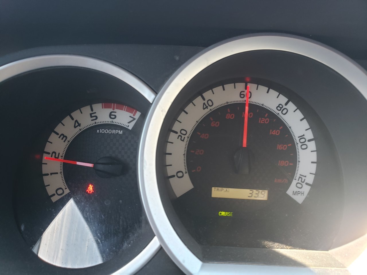

    This my 2013 4.0L with stock 3.73 on 33's tires. My actual speed on GPS in 64 mph. I think on 31 inches should be the same RPM.

    Thank you George. I'm loving the idea of 64 mph @ 1,900 - 2,000 RPM. I'll have ample time to compare the stock tires vs my 33s as I'll have to drive it back from Michigan to Minnesota around an 8 hr trip. Once home I can put on the 33s and see how it differs in both hyway and off road use.

    Once you put bigger tires your car will be slower and fuel mileage drops.

    I thought you stated the photo was taken with stock gearing and on 33s already, right? I have no plans to go larger than 33s.

    Yes, stock gears 3.73 with 33's. But stock tires are 31inch tire. 33 inch are oversize.
