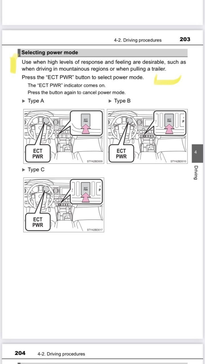

    Owners manual says to use S4 for towing. If u feel the need for more u can still use the ect button with a tune.

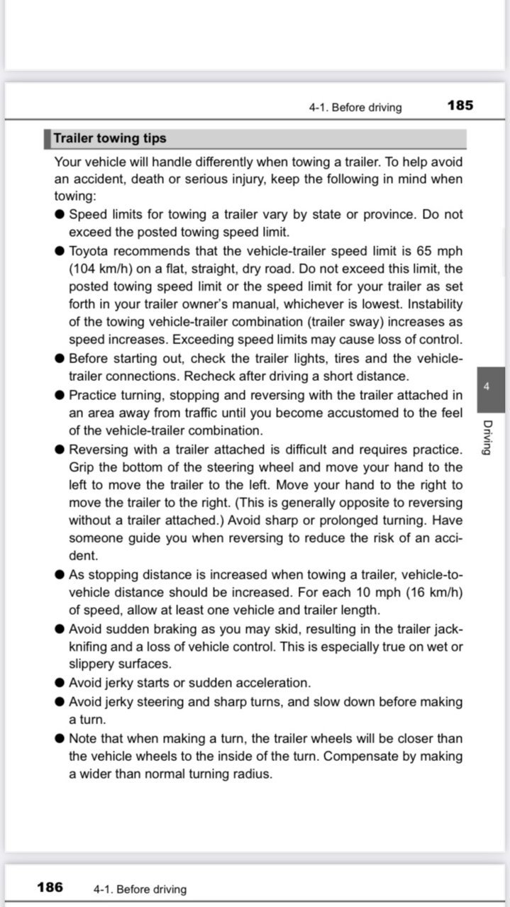

    TW, where some people quote the manual … but the manual doesn’t say what they quote lol.

    That’s an often repeated falsehood. The manual says to use s-mode for engine braking when towing and not towing.

    Please provide evidence.
