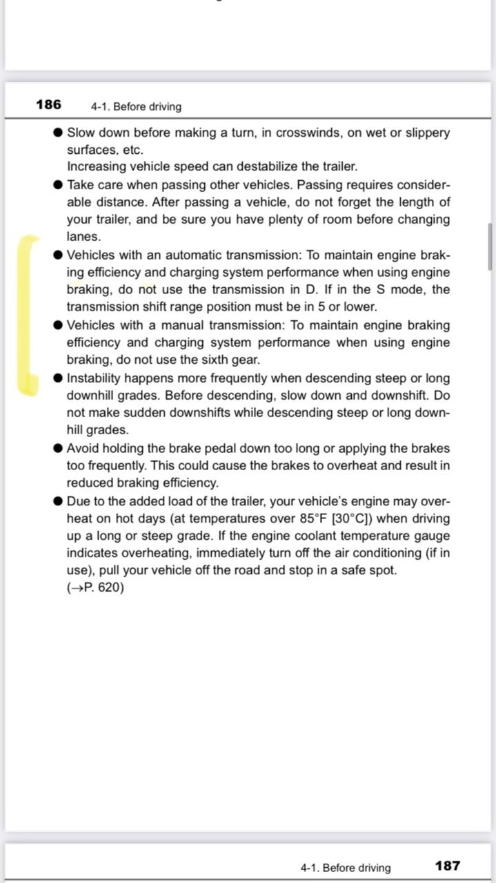

    Leaving the transmission in drive will not lockout 5th and 6th gear when towing 2 tons. Thats very hard on the tranny towing that load in those overdrive gears. Your going to have a lot of heat. I would even recommend in drive if towing 1/2 that load.
    Even GM states never to tow in od.

    I’ve owned both, but what does it matter? It doesn’t change what the owners manual says.

    If you’re going to tow 2500+ (heavy for Tacoma) in D, the trans will tend to lock/unlock and shift unnecessarily creating more heat than it would if it stayed locked in s4. Although the manual states that s mode is to be used for engine braking and charging when towing, the side benefit is a more normal trans life because of more normal fluid temps.

    What matters is that multiple people in multiple threads have quoted screenshots of where it says in the manual, to which you always reply with a spirit-of-the-law argument.
    It doesn't matter why the manual says don't tow in D, the fact remains that it does say don't tow in D. So I personally don't tow in D.
    Not that you even need the manual to say that, because as an AT owner who puts 3-5 thousand towing miles on the truck per year, I can say that it's pretty obvious when the transmission is unhappy. And it ain't happy in D.

    This is the answer you seek. Use S5 and/or S4. Don't tow in 6th gear.
    ECT is optional but works well for most towing situations.

    Read it again more carefully. It's talking about engine braking while towing; not towing in its entirety. Also read the section in the manual specifically about s-mode (page 212 in my copy). It says s-mode provides 6 levels of engine braking force.
