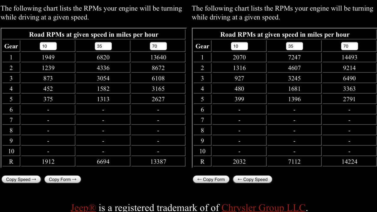

    Here is a chart according to the calculator on grimmjeeper.com. Left is stock 245/75-16 tires with stock 4.10 gears. The right is 37’s with 5.29 gears. Obviously the weight of the much larger tires will have an effect on things so I’d imagine 37’s with 5.29’s would drive similar to a truck with stock gears and 33’s. This is all speculation though as I have no experience with 37’s on 5.29’s
