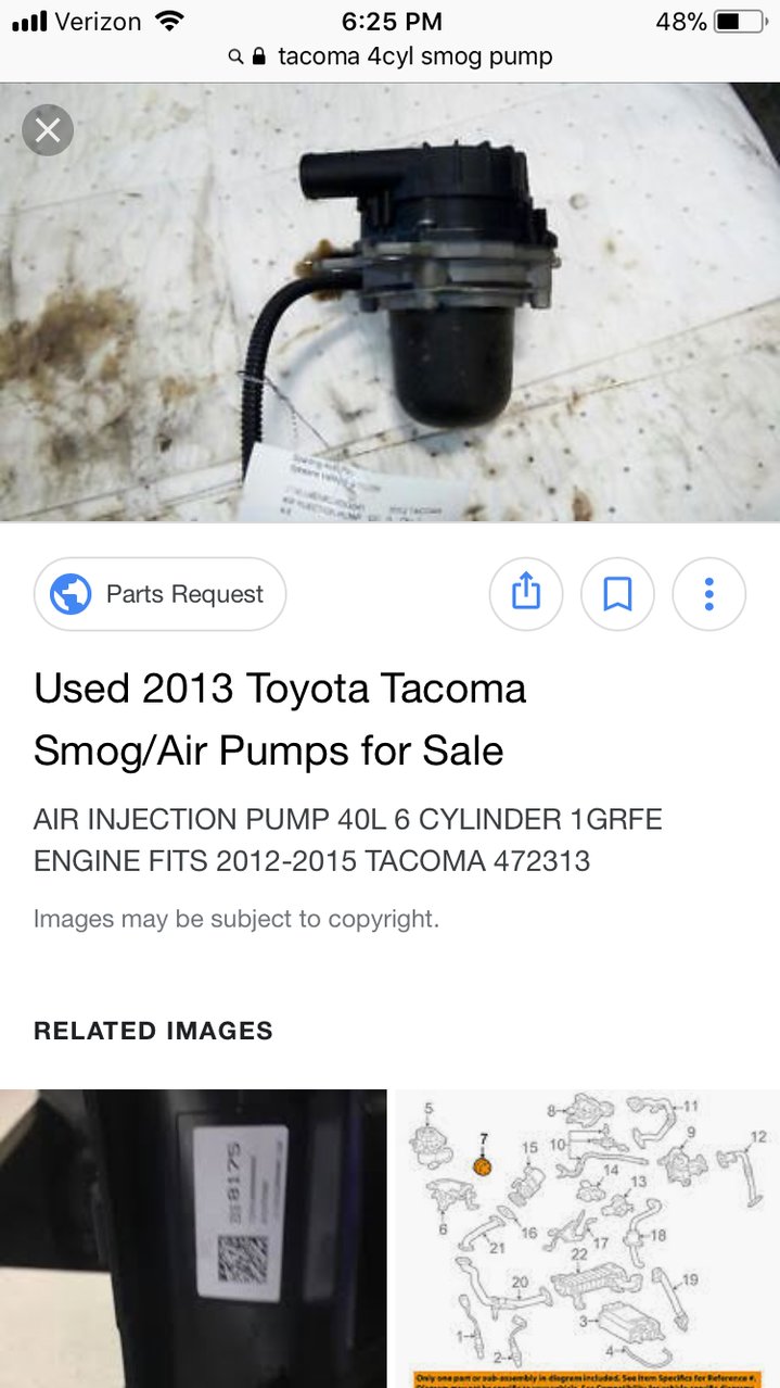

    Hi all,
    Hopefully I'm a future member of this community. I'm looking at a 2012 2WD 2.7 Taco, which is going in for a mechanic inspection tomorrow, but in the meantime, while "kicking the tires" I think I spotted something missing from the engine bay.
    What goes here, next to the washer fluid tank? There are some bolt holes, and it looks like *something* used to be bolted there.
    Thanks!

    You're missing your smog pump.

    ^^ what the heck is that? Now I need to look to c if I have it and get rid of it.
    Just checked I don’t have it. Good. Just notice this is for 4 cycle not 6

    I think those smog pumps are about $1500 if it matters to you.

    I'm in CA, so this car will very likely have to go through a smog check. I assume that this pump not being present would probably cause the test to fail.

    The Smog pump only runs for the first 20 seconds at start-up.
    I hear mine kick-off every morning....
    You might be able to pass CEI without it?

    There is something there.... like a Sock Filter...

    Looks like the smog pump is there it just looks different like it’s flipped upside down on your model year or something.
    I mean you can see the air hose running from it to the engine.
    Maybe it was replaced after it crapped out? Or maybe it just comes like that on certain 4cyls?
    I have a 2013 V6 so I wouldn’t know. Mines essentially where your air box is lol and those holes you are looking at are probably just universal for that sheet of metal for all models.
    Edit: if you pump was gone, without some sort of electronic bypass hack, your truck would be running in limp mode maxing out at like 45mph. And throwing codes.

    your smog pump is there but its just hanging off its bracket cus the bolts fell off. Fix before you do any more driving.

    Also wtf is up with the random green wire just sitting there with exposed copper? Is that going to the pump?
