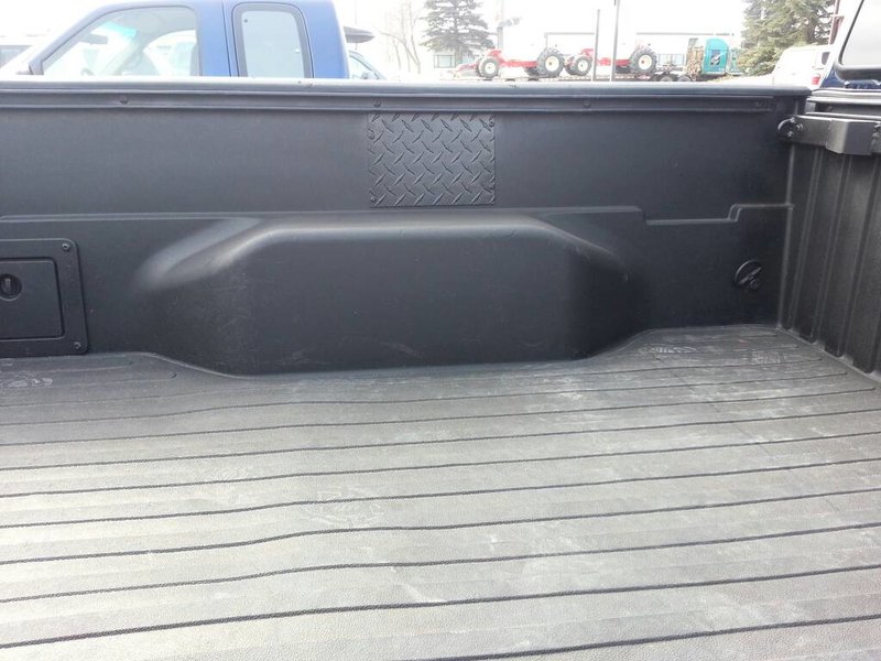

    Got around to doing something about the 2 holes
    Cut some aluminum plates and sprayed Bedliner on them

    They are breather holes. If you obstruct them your rear end can't breathe and you'll burn up diff oil like crazy, but whatever do what you want

    Since my bed stays dry (canopy) i installed the rear differential breather in the driver side cubby hole.
