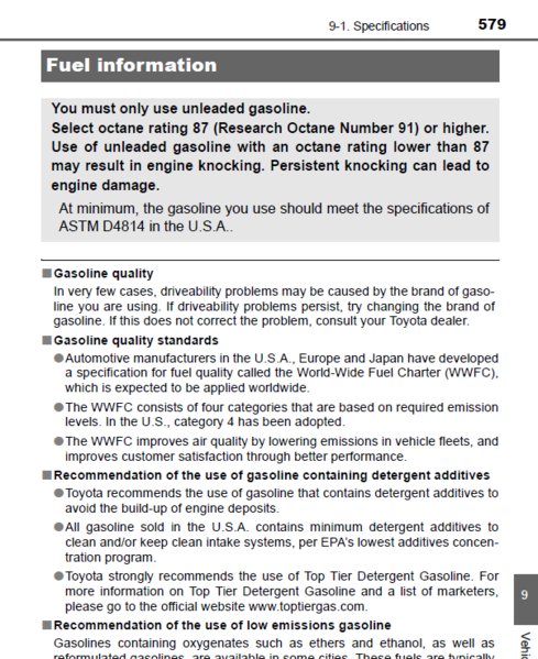

    This is the manual info.
    Fuel type Unleaded gasoline only
    Octane rating
    (Unleaded gasoline) 87 (Research octane number 91) or higher
    Fuel tank capacity
    (Reference) 21.1 gal. (80.0 L, 17.6 Imp.gal.)
    Here is info on a RON (Research octane number).
    Some foreign vehicle manuals recommend a Research Octane Number (RON) instead of the more common octane rating that appears on most gasoline pumps. As a rule, the recommended octane rating can be determined by subtracting four (4) from the recommended RON number. A vehicle that calls for "91 RON" should use 87 octane gasoline (as measured by the (R + M) / 2 method). Using a higher grade than is required will not usually increase performance. However, if the vehicle is equipped with knock sensors, as many late model vehicles are, a higher octane grade may enhance performance.

    Page 579 of the 3rd Gen Owners Manual says that "Toyota strongly recommends the use of Top Tier Detergent Gasoline." You can look up companies that sell it online at http://www.toptiergas.com/. Personally, I'm betting that there is some money changing hands for that recommendation, but hey, I'm a bit of a conspiracy theorist.
