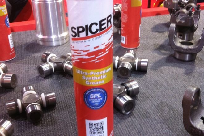

    I think any of the greases above that match spec are fine. The key is applying the grease regularly and more often than you’ll casually remember too. I started with Red N Tacky but found it doesn’t last long (zerks dried faster). Then I went to Valvoline (my Toyota dealership uses it in-house). It also sperates badly into oil/putty consistency over time in the garage. I’m gonna try Royal Purple this time around but I’m sure the 100F garage storage is contributing to the separation vs storing it a room temp.

    Anyone use a NLGI-2 grease that doesn’t make a mess when stored?
    Edit: Did a google search and found Super Lube was the one most mentioned as a no mess (separation) when stored....

    I'll be loading up a tube of the Super Lube in my newly obtained Lincoln pneumatic greaser this weekend. Should take care of my ujoints for a few months at least:woot:

    I use mobil 1 syn, with the grease gun sitting for a couple months i may get a few drops, but it seems to have gotten better in later cartridges. Just a few days ago i went on a long internet search comparing the specs of different brands, because yes i tend to go overboard. I wasn't all that happy with the specs, but im not a grease expert and it does have the gc-lb rating, which i suppose is good. if i go 10,000 miles without greasing, the u joints are definitely dry. i tend to think its just the design.
    I stuck with mobil 1, and here's why. The tech specs were very similar to the spicer grease. Its readily available. i use it in my trailer bearings and it doesn't seem to ooze out. In the end, regular greasing is more important, just stick with any lithium/lithium complex nlgi 2

    I use this too. Never had an issue with it except the baseboul does drop out and leak from the grease gun after sitting for a while. Just a small mess though

    I switched out to valvoline synth-blend at some point in time. Less mess than Red Tacky stuff.

    My garage can get pretty hot in the summer so I figure it’s just hitting the drop point. Seems fine once is applied to bearings ect.

    should grease driveline at every oil change interval, at least the rear driveline

    PreRunners don't have greaseable U-joints, if I remember correctly. Take a look and see if you got zerk fittings. Check the U-joints for backlash. If you got visible backlash, replace the U-joints.
