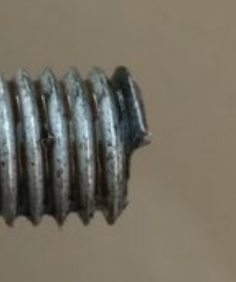

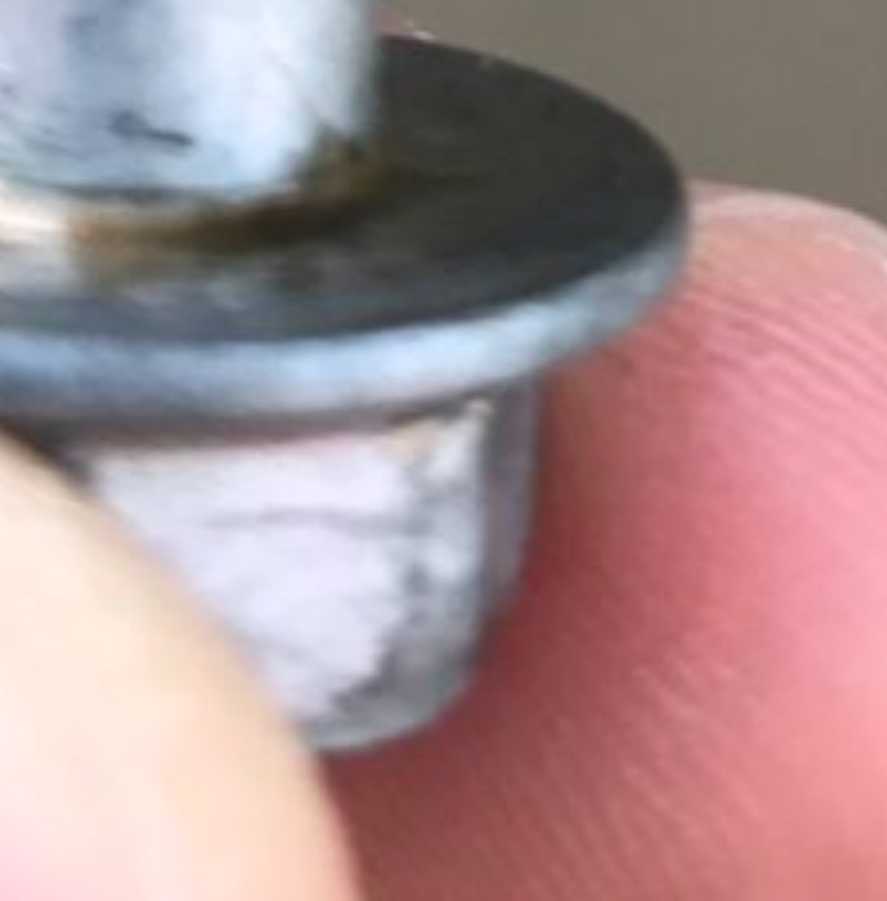

    Well- at least his photos are good enough to ID the part and one could count and compare the total number of threads on it to a good one. Not all is lost.

    Sure would have liked to see the bolthead edges closer though. And if it sheared off, we may know where the other part is.

    True. The photo is better than nothing. From what I can tell, nothing seems to have hit the head of the bolt. The edges look clean with no blunt marks.

    Post #1...PIC # 2.... the bolt head clearly shows the deformation of the bolt by an air gun...!!:eek::eek::eek:

    Then those photos are just as good. Someone at Toyota possibly fucked up, if OP never touched that bolt.

    That bolt does look air tool damaged, the head is striped and threads are broken - I think the pics do look good enough for OP to prove it if the shop cant return the original part. The end of the broken off bolt is in the hole still too, I bet.
