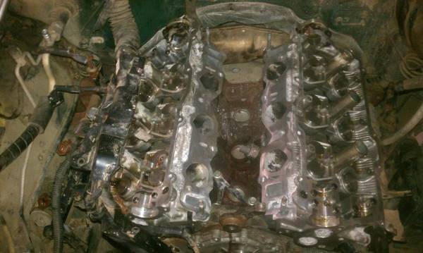

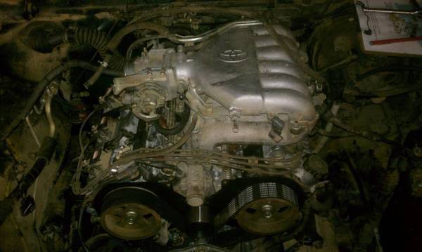

    Actually it is going along pretty good! I have the heads installed, valve covers installed, intake manifold (upper, mid, and lower), and expect to be turning the engine over the first part of next week.

    You haven't seen all of the pictures then. I have about 6 quarts of muck drained from the original engine, and went through a total of 5 gallons of Purple power to get this thing clean. lmao. I think it is about time though to put to rest the comments about the parts cleaners. You are shooting a dead horse at this point. I have about 10 hours of physical work on it, spread out over several weeks. I let the owner know that this would be an ongoing project, and that a lot of time would be spent with parts soaking in the washer for 24-48 hours or longer. The heads themselves spent 4 days in the cleaner.

    IT'S ALIVE!!!!!.....Sort of.....
    Well this morning the truck fired for the first time. After all of the extensive work done on the engine, I was ready to start it this morning. First I disconnected the coils and cranked the engine over a couple of times. I spun it up for 15 seconds each time. This is done to build up oil pressure so that none of the bearings or other lubricated parts are dry when the engine starts. After that we reconnected the coils, and she did not want to start. Checking showed that we had no fuel pressure. Seems like the fuel pump does not want to energize, or perhaps the relay has gone. Heck, after all this time, we may be empty on gas. I still have to check on that. What I did do was used a small amount of gas that I sprayed into the intake. Engine fired up, and of course died quickly as I was unable to keep fuel going into the intake. So once we have the fuel issue worked out, we will go from there!
    MUAH! Dr. Frankenstein has breathed LIFE into the Tacoma!!
