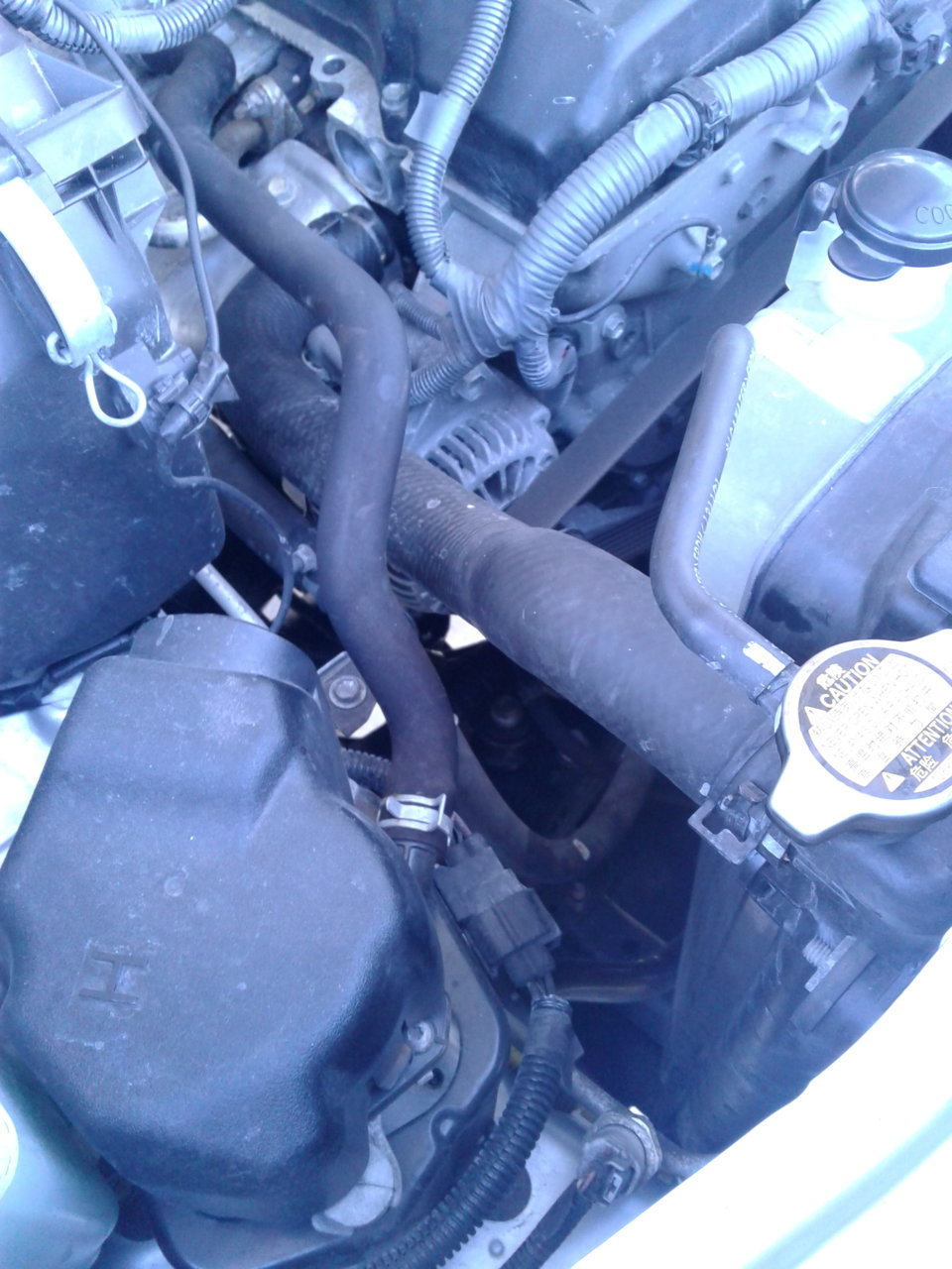

    This drawing is best i can explain
    TireFire and rmorse like this.

    Picture (photo) please.
    tinker_troy likes this.

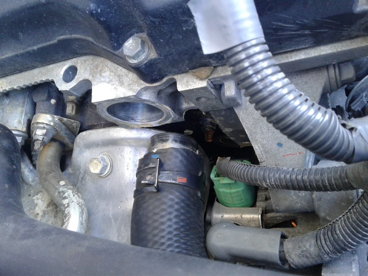

    Theres a fitting that is clamped to the hose and it popped out of the engine, so idk what hose thats called

    Heres a pic of the problem
    SR-71A likes this.

    Damn. That isn’t looking good. You dumped all your coolant.

    The hose fix looks like a force fit, discuss with a mechanic. You should have the cooling system flushed with the proper mix of antifreeze. The question/issue is, was there any damage done to the engine when it over heated.

    Its probably fine if it wasn't ran too long overheated. 2.7 is iron block they take the heat better than aluminum. My last truck, ford with iron block 302 and aluminum heads, I overheated several times one time driving about 20 minutes with the needle pegged because the heater valve broke and that thing took it like a champ. I say fix the the clamp fill er up with coolant and keep on truckin.

    Wonder how a hose like that becomes loose
