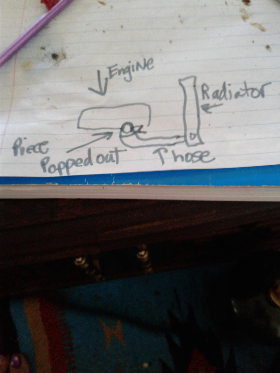

    If you drove it until it stalled... you’re probably gonna need a new engine. I’d think new or machined heads at a minimum, but if it stalled I’d say there is also cylinder damage.

    She ran it until it stalled. I’m nervous for her, but hoping for the best.

    Usually when wildly over heated I check compression quick and see if its obvious what happened.
    Next we quote a tear down or used motor.
    I would 100% expect a head warped beyond spec, and a block that might be close.
    What I've seen is cylinder so badly warped it allows compression to pass from cylinder to cylinder. Coolant everywhere

    Sorry too say,but you should of had it towed,running the engine until it stops with no coolant,is almost always a destroyed engine .

    At this point you need a good mechanic to evaluate the engine. It doesn't look good from your description.

    I see eyes peering out from under your drawing.

    So, im pretty sure i blew something, for sure! Yes driving it was really stupid, i had no idea what was wrong with it, the gauge stopped working so i didnt know it was even hot because i put water and thought i was good but ive never had a car get hot so fast, i couldnt believe it! I knew i had full fluids i check all the time, this is really bad. My brother passed away and he gave me his truck, im so sad, hes probly shaking his head at mesorry bro

    If you were near me, I’d put in a face mask and come check it out. That sucks that fitting let go.

    Well guys my truck is at a shop just to be evaluated. I was told I need a new motor,question is ,can't it be rebuilt? If not, im in the market for a motor 2.7 4 cyl, and a trustworthy mechanic to put it in for me, i was quoted 12000, i thought, hell no! So i can get an engine for about 2500 and labor ,so around 4 to 5 grand. But i dont have that kind of money to spend on it, but i need a car, any suggestions or anyone with some advice, I don't want to get taken advantage of because I'm a girl,and you just never know.

    That really sucks OP - the gauge went to zero because there was no coolant touching the thermostat. Good heads up for other people - if your engine temp gauge suddenly drops or rises pull over.
