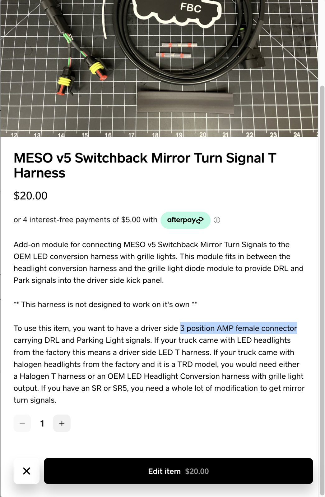

    You get the 3 pos AMP female off an LED T, Halogen T, or OEM LED conversion harness with grille lights. It carries DRL, Park and Ground.

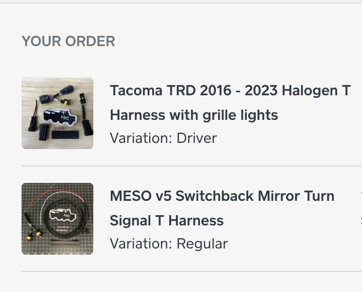

    Just placed my order for the items you suggested. Thanks!

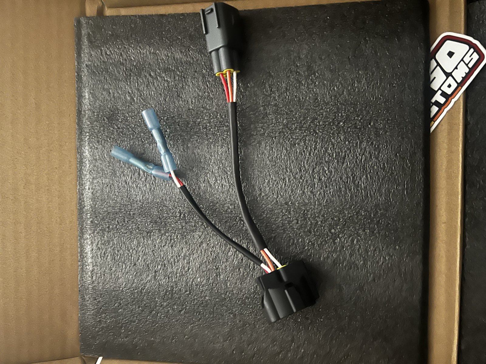

    I just received the Meso V5 switchbacks. Did I need your harness if the kit came with this?

    No, they are the same but cheaper cause made in a factory.
    want me to cancel your order?
