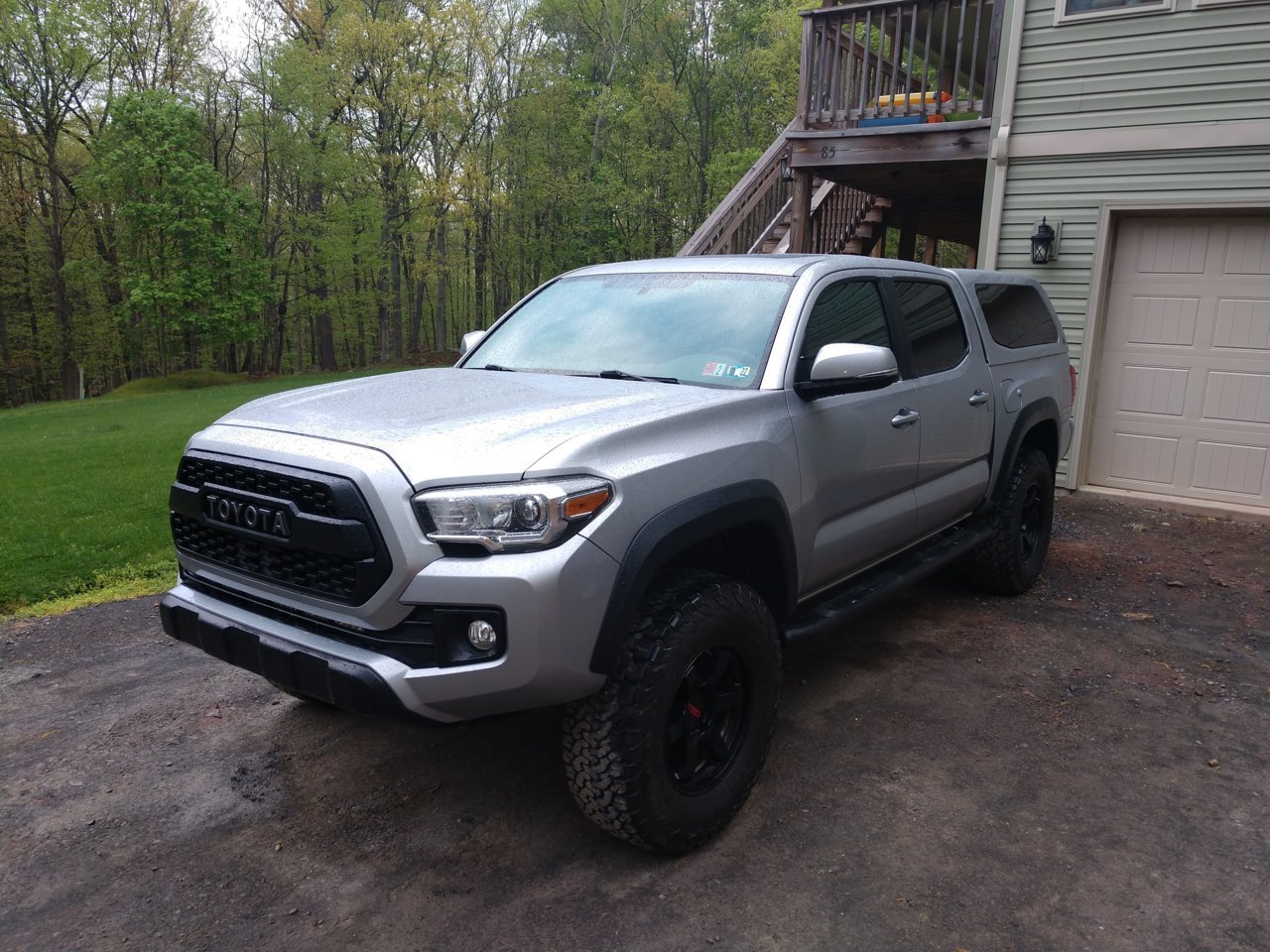

    PAKraig
    PAKraig Well-Known Member
    Feb 18, 2011
    #51375
    373
    Kraig
    Central Pennsylvania
    2017 DCSB 4x4 in Silver Sky
    OME suspension and 285/70R17 BFG KO2s
    TX built 2017 Tacoma DCSB TRD OR w/ OME coilovers, block and aal rear w/ 33" BFG AT KO2s.
    Very nice, very capable truck that gets decent highway mpgs considering the lift and tires. I've owned a bunch of Toyota 4x4s including 4 Tacomas, but I'm really considering something different next time.
    Auto transmission has always bugged me, before and after ecu flash
    the infotainment and Nav is outdated compared to competition and the Nav has always give me incorrect info (I just use my phone now)
    Plastic wheel well liners keep coming loose thanks to wrong sized washers used from factory
    Fuel door spring seized, bent door, and I managed to rebend it so that it's useable again, 2nd Tacoma this has happened on
    Front passenger door shuts rough and has a loud clunk, just before closing
    Driver window whistles before and after warranty fix
    Leaf springs squeak, before and after lift
    It's a cool truck and I realize none of the above are going to leave me sitting alongside the road, but for a truck that still has a retail value over $35k (according to KBB) I don't want to have to deal with all these minor issues.
    Seriously considering a Gladiator next......but FCA worries me too.
