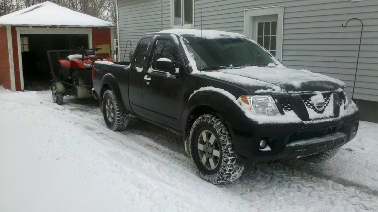

    here's how i made mine better, bought a real 6MT

    I'm not going to argue with you there, I test drove a 2011 Frontier 4X-Pro and I LOVED the 6-Speed. The truck was GREAT. The problem is it sorta cancelled each other out and I got a case of analysis paralysis and didn't buy either!
    I couldn't get around to buying the Nissan which depreciates so much and is due for a more fuel efficient engine... Then, I couldn't go and buy the Taco based on the 6-speed (after having driven the Fronty). Plus, it's also due for a new engine!
    Automatic is not an option for me.

    get a tune for it and you can see upwards of 22mpg, something else you cant do with a toytoa (tune/programer)

    Oh neat, that's a great idea. I hadn't thought about that. People always associate tunes with the little sports cars.
