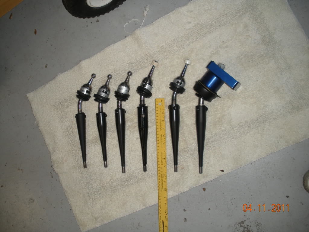

    I have been on TW for a while. I just don't have as many posts. I have sold a few shifters over here. I probably need to do a post about them. I will tell you, by the time you get everything you need to do the mod, you will spend $120. So for the money, it's a pretty good deal.
    Here is a pic of several modded shifters.
    Going from left to right.
    There are two (2) OEM shifters cut down to approximately 8 1/2"
    The next one is an OEM shifter cut down to 9 1/2"
    The fourth & fifth ones are TRD SS cut down to 9 1/2".
    and the last one on the right is a B&M cut down to 9 1/2".
    Stock length is 11 1/2".

    The way I sell these shifters is:
    You send me $120 via paypal.
    I ship you out a shifter, with a new tip bushing & set screws for your URD SS. I do this through USPS Priority Mail. You will usually see the shifter in 3 days.
    You swap it out and send me back the old shifter. No down time.
