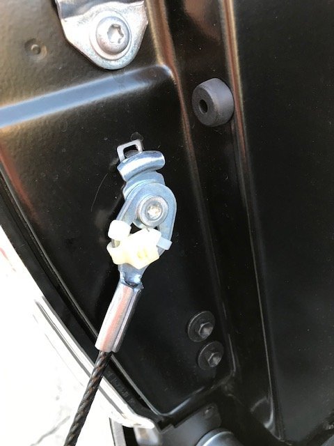

    this plus hose clamp plus lock it plus check it every night.......i should do more

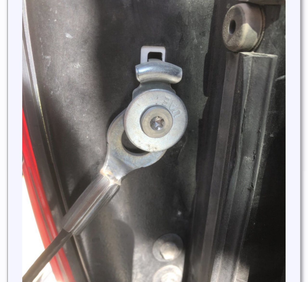

    A fender washer on the torx bolt is more secure. Just put a spacer under it so the cable eye rotates.IMG_1350.jpg

    send me a couple, im using what i had already on hand

    …which is good. I like using what I have, that’s why I asked my neighbor for 2 washers because all I had was a hose clamp and I broke it off too easily testing it! :thumbsup:
