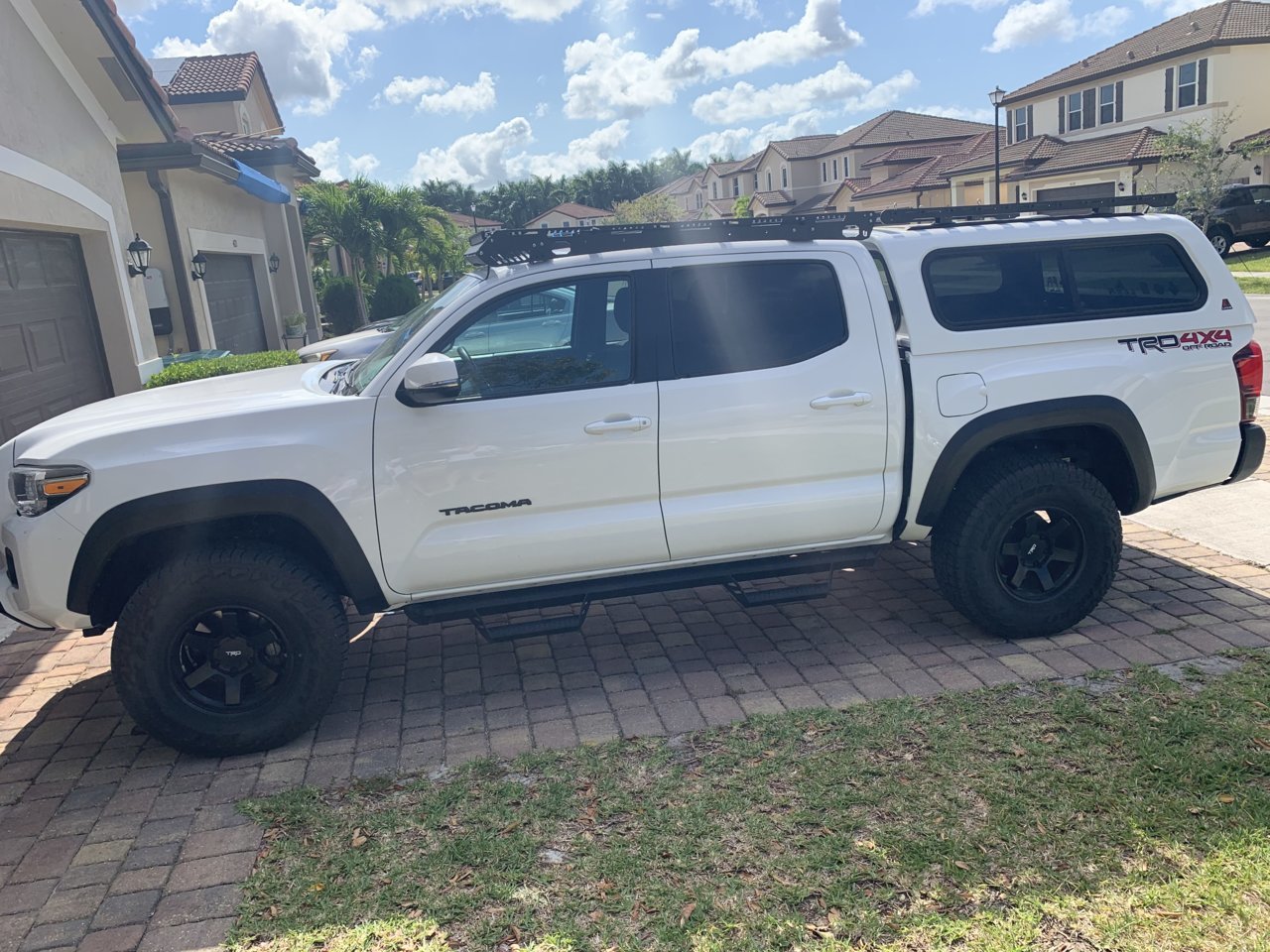

    Picked up a used leer shell! I now have an Uptop overland and prinsu rack. The ultimate Broverlander!!

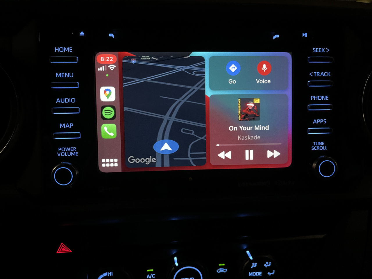

    Retrofit a 2019 Sienna headunit onto my 19' OR for Apple Carplay

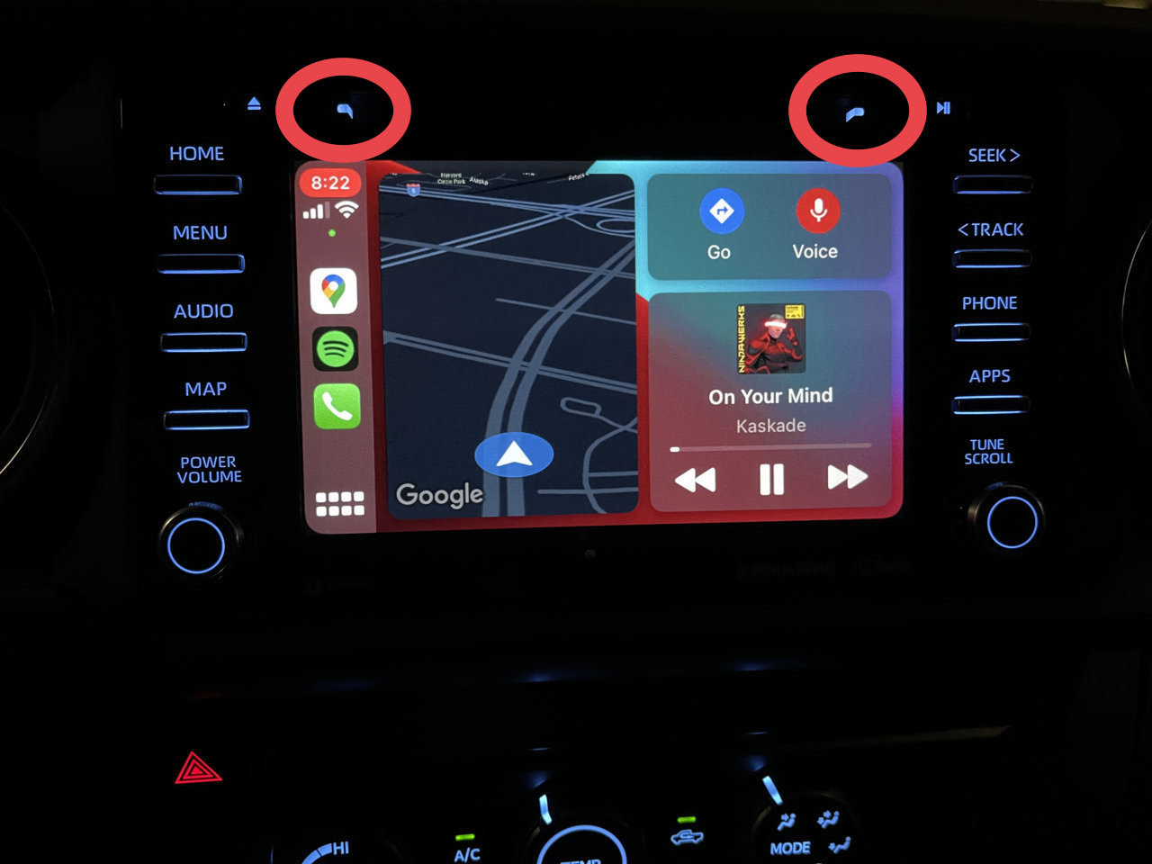

    What do these two buttons do? Or is that the edges of the CD slot?

    CD Player slot indicators.

    I realized that is what they might be after asking and seeing the eject button to the left. Initially, I thought it might be a way to quickly bring up the left or right cameras on the mirrors, that the 2020+ Tacoma does have.

    That would be frick'n sweet. But no.

    Nice. 2 questions. Where did you get the radio? Was it a simple plug and play install?

    2 answers
    1. I found it off car-parts.com off a salvage yard. Ordered the sienna 86140-08190 headunit.
    2. Yes, the hardest part was figuring out which way the side radio holders went. Ordered the needed harnesses off auto harness you have to email them for the harness as it it custom made, and ordered the carplay usb connection that makes your current USB able to CarPlay. Took me about 1 hour to install and make sure everything was working correctly.
    3. Let me know if you get it and need any help. I know I couldn't have done it without many of the guys here.
