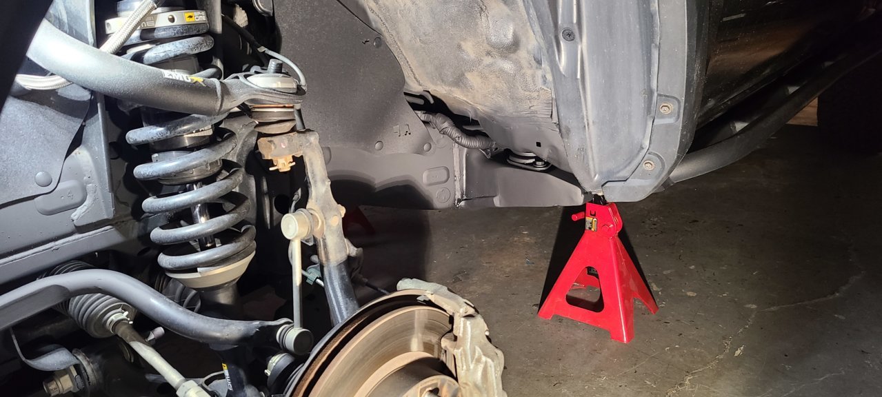

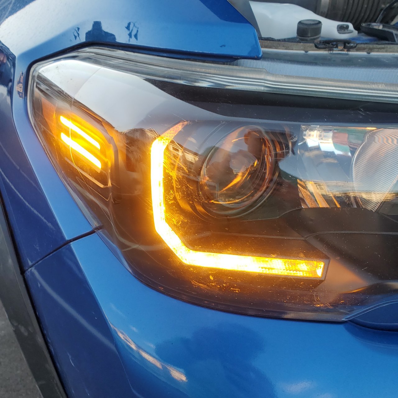

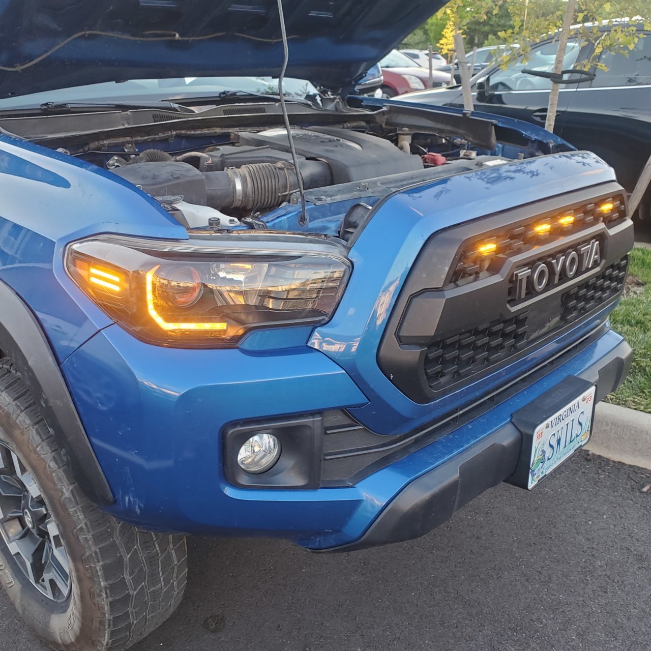

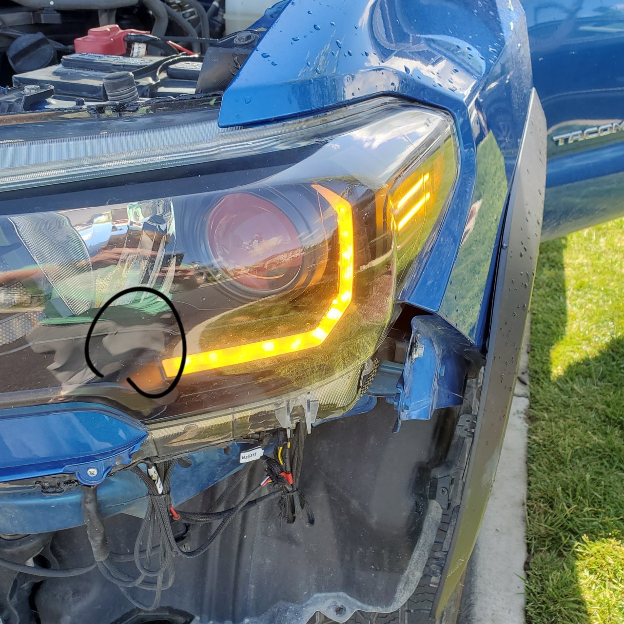

    Well, salvaged it. Learned the lesson after cleaning the tint spray off the first DRL lens: hit it hard with GoofOff, then immediately rinse. And repeat. First lens is foggy and translucent, second isn't quite as transparent as stock but much better than the 1st attempt. It's got some spray tint stuck in the recesses, but that's hard enough to notice as opposed to the fogged one. I think the amber boards are a slightly different shade than the side markers and raptor lights, but at least they're not distinctly dark orange now. Oh, and I got the speck of sealant off of my projector lens from when I did the retro the first time and didn't notice it til it was sealed up! ...then sealed it and realized I've got a new speck on the headlight lens itself. Oops.
    I'm really ready to drop cash on a tube bumper just so I don't have to peel the front end apart just to get at my headlights anymore. Plus all the broken plastic bits and clips... poor bumper covers barely hanging on at the sides now.

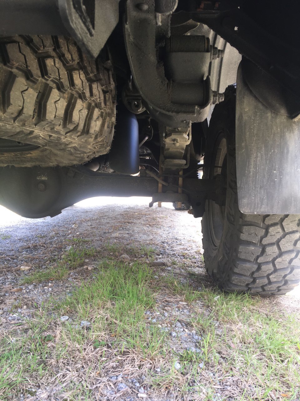

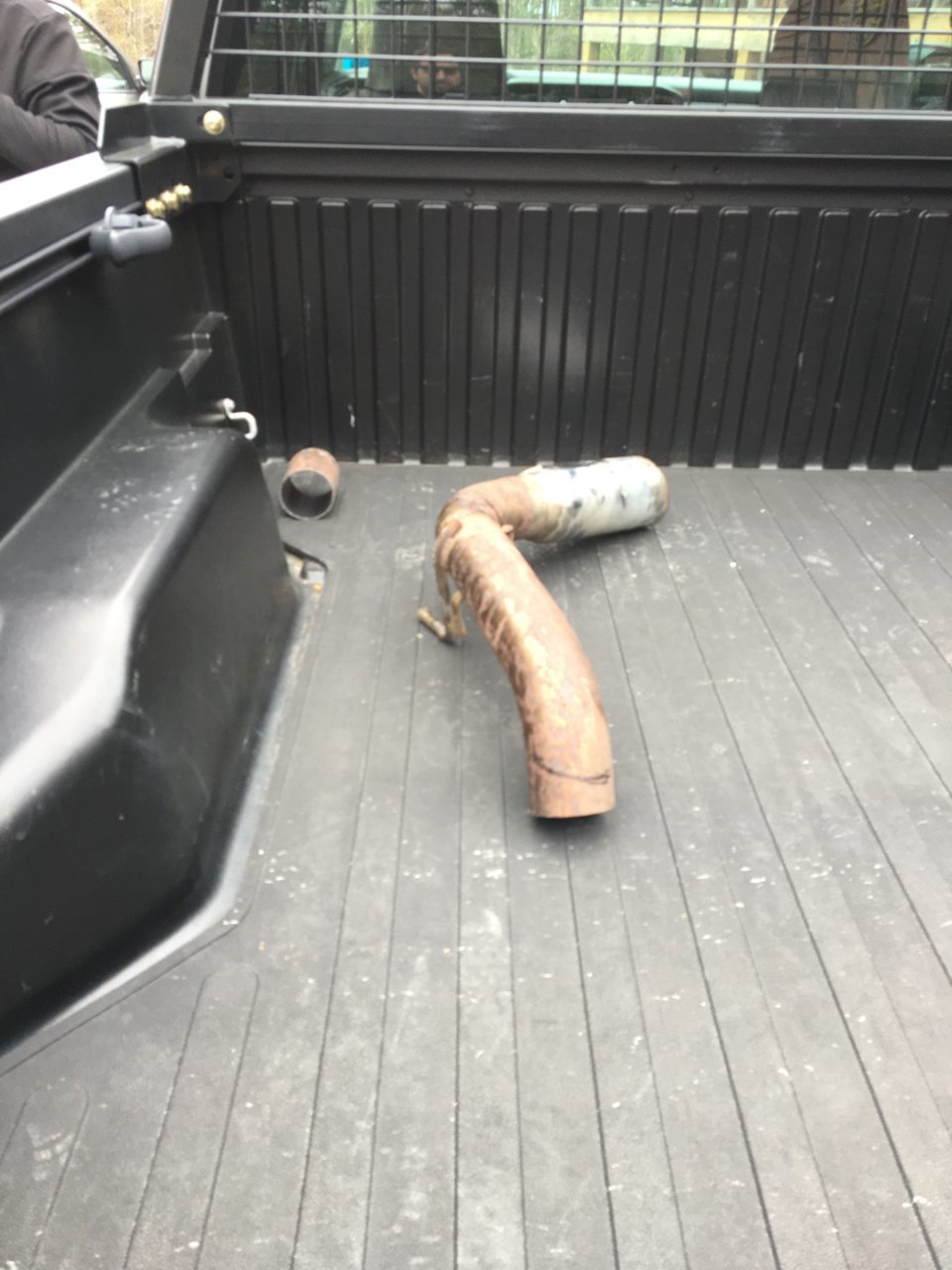

    I hacked my magnaflow street series catback over the rear axle. Mainly for offroad purposes.and welded on a black tip. It actually sounds quiter now while driving. Also i hacked off the ends of the bolts on my a arm Skids under the Cv boots. Next up is u bolt flip kit and bumpstop upgrades, then later- bumpers ! But i am ready to wheel and play this summer now : )

    Man, looks good but I would be a little concerned. Probably install a heat shield or wrap the exhaust there. Quick Google search and it looks like it can melt tires.
