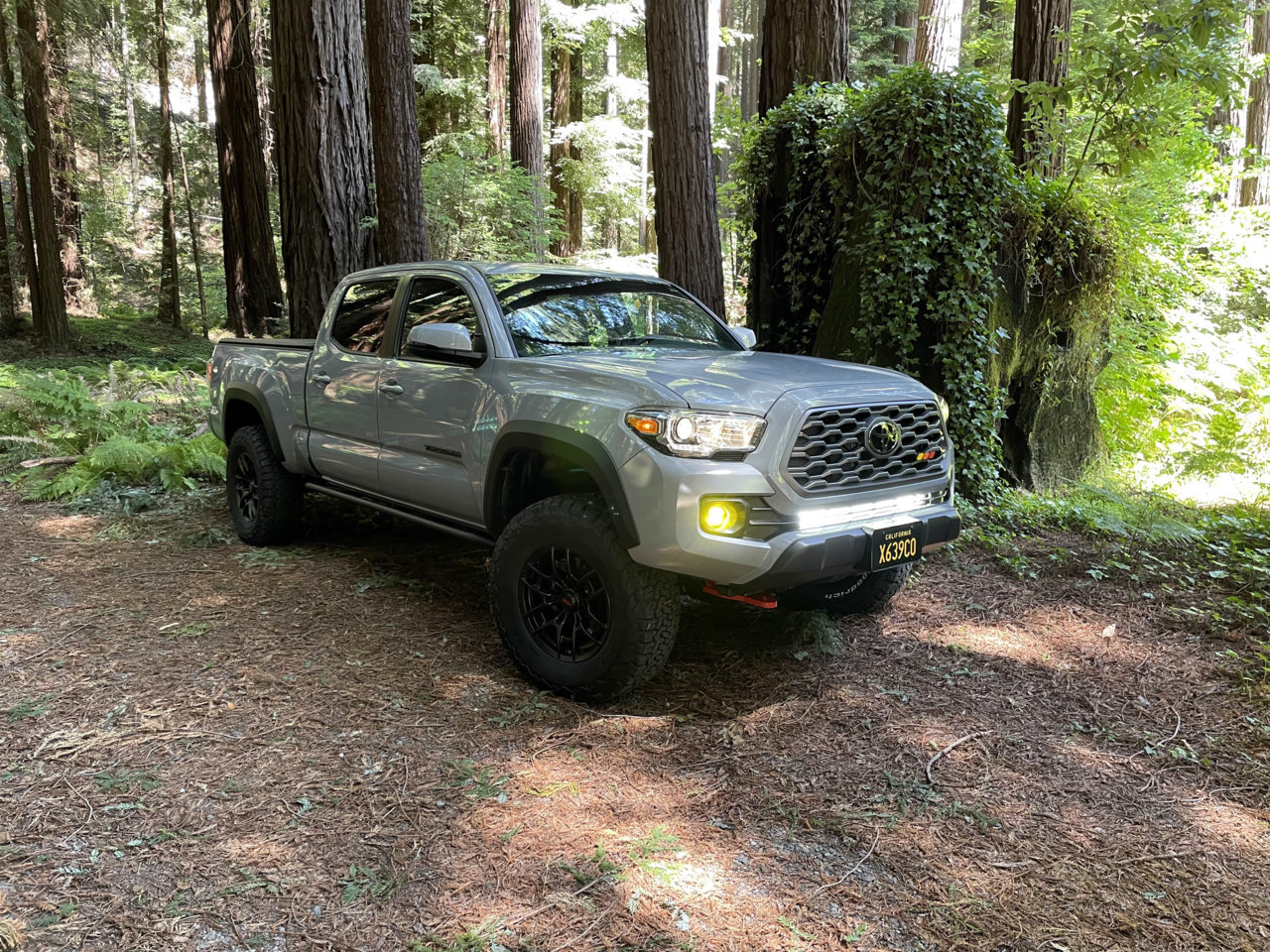

    New Old Man Emu suspension goodies, rims, shoes and ARB recovery point to replace the stock passenger side hook.
    OME: Tac 16 (OMETAC16HKSB2). ~2" lift. Retained stock UCAs. Not fancy.
    Rims: Factory Style Wheels F158. 17x8, zero offset. These will move your wheels from the stock +25mm offset almost exactly 1" outboard.
    Tires: BFG KO2, 285/70/17, C load.
    Fits perfectly in my 2021 TRDOR. No rub anywhere. Been banging it around a little bit at full lock in forward and reverse. Also managed to stuff a full-size spare in the stock location. Tight, but not too worried about the exhaust baking it. I'll keep an eye on it.
    No time today to find some level ground to compare my stock street-to-fender numbers to the new setup, but pretty happy so far. I'll give it a couple of weeks to bed in and chime back in if there are issues. The street/freeway ride is just the teeniest bit more firm. No complaints. Now need to give it a little beating.
    Update: 5/23. Big wind storm up at our cabin. Drove up to check it out on Friday. Some pretty huge diameter redwood limbs blocking the approach, so I did the sensible thing and just drove over that shit to test out the new goodies. No rubbing.
    Then got to use the ARB, a couple of shackles and a recovery strap to lasso the timber, drag it back up the hill, and chainsaw it to death.
    Woohoo! Liking it. :)
    Truck looking pretty after limb-towing duty:

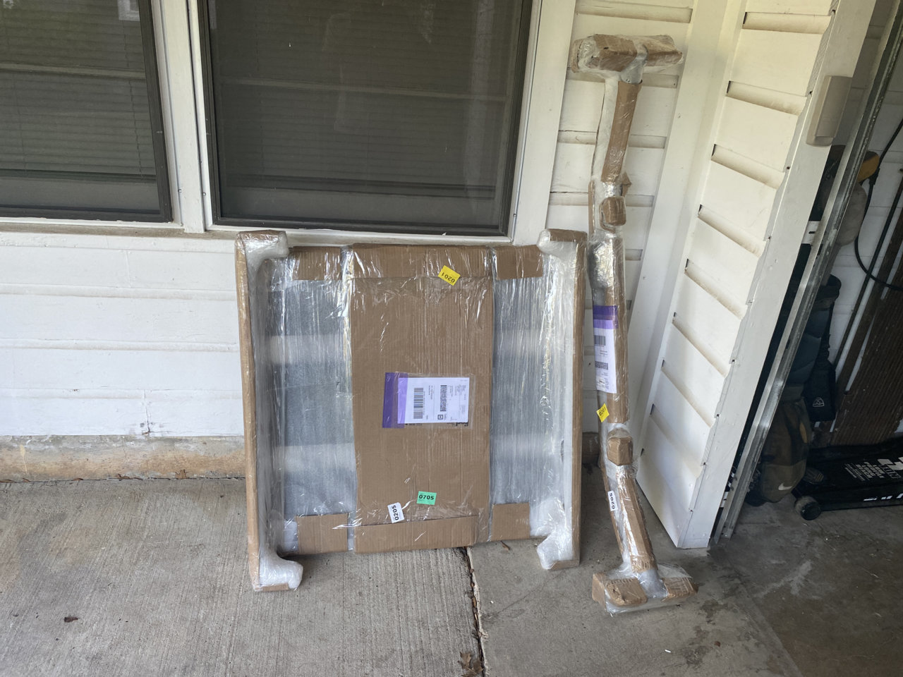

    Avid Bed bars and basket have arrived

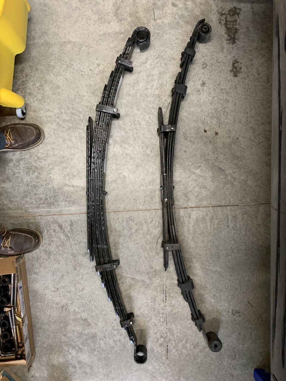

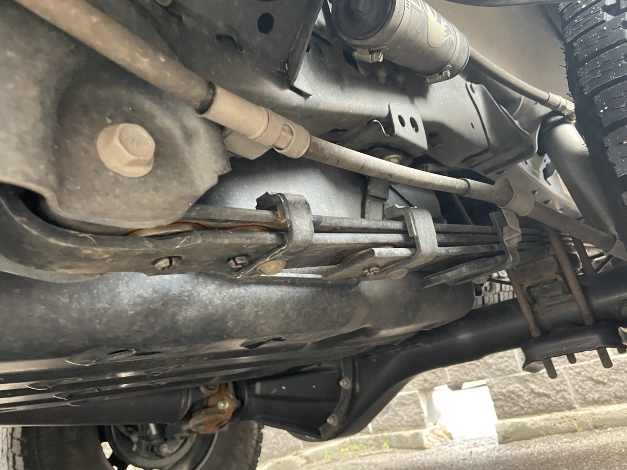

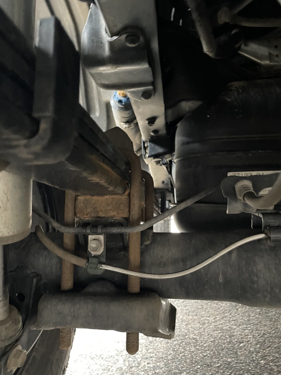

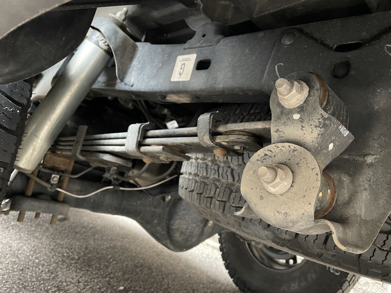

    Man that looks stock. 4 leaf pack. Could be wrong, it’s been known to happen a lot...
    Here’s a pic of my stock vs deaver pack for reference

    Agreed. @Quicksand-TaCo see here

    Oh wow yeah, looks much less beefy.... Guess I'll be adding new leaf packs to the top of my wish list.... :spending:
    @JDSmith Are you happy with your Deavers? I see OME is a good option too... Going to have to do some thread searching/reading on this I'm sure.

    Lol yep they are-- basket for up to 35" spare
