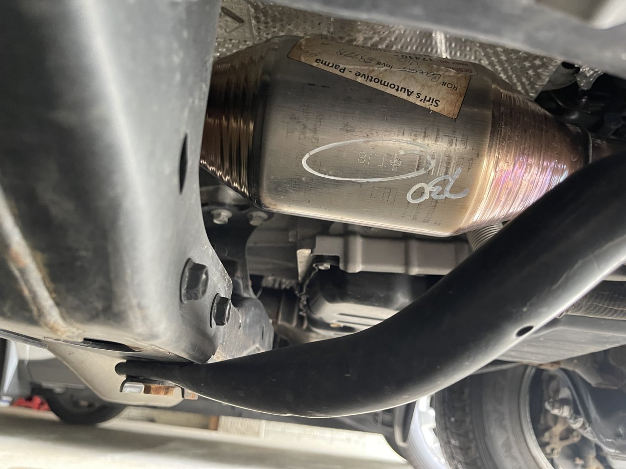

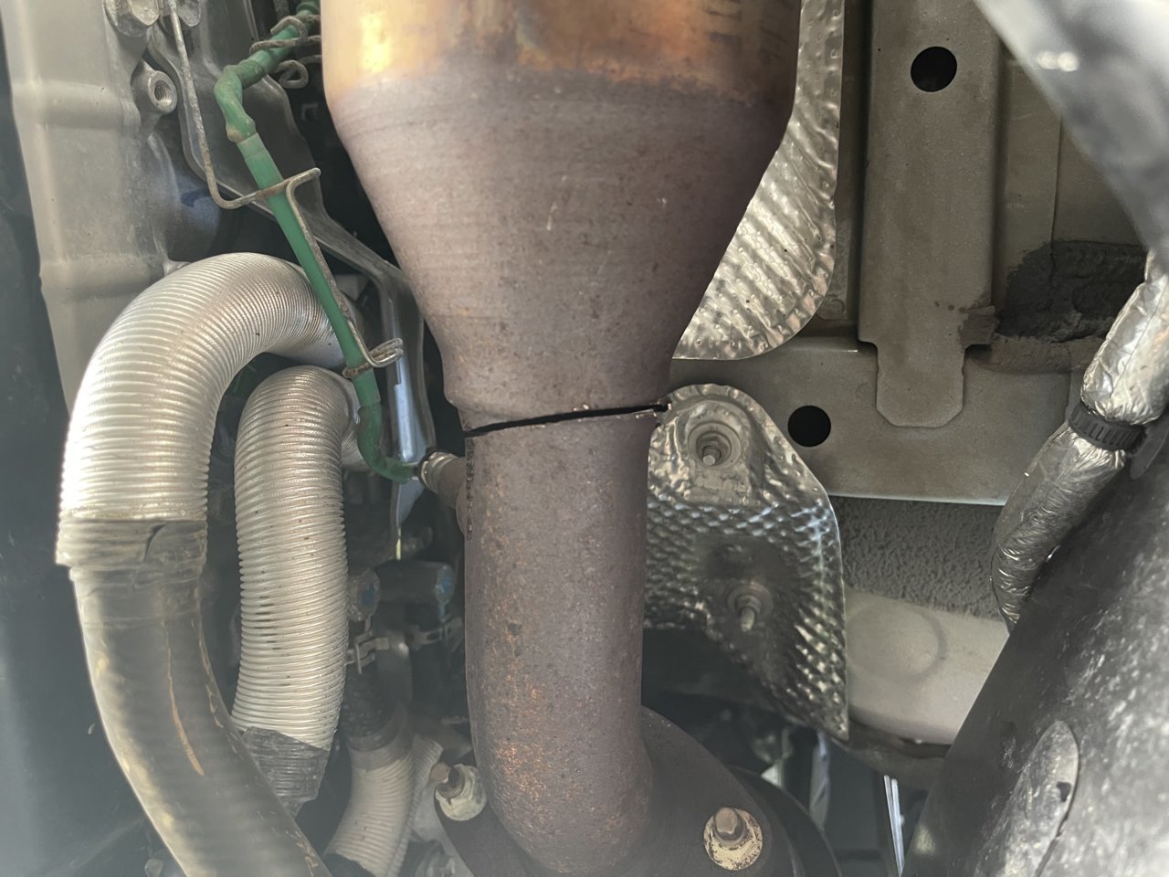

    Was it replaced by the dealer ? Oem ?
  2. May 30, 2021 at 8:26 PM
    JWally
    JWally Active Member
    Dec 18, 2019
    #313640
    36
    Ohio
    2020 DCSB TRD OR
    Insurance covered it, the shop made sure to get oem. Apparently they’ve seen a lot of issues with aftermarket cats.

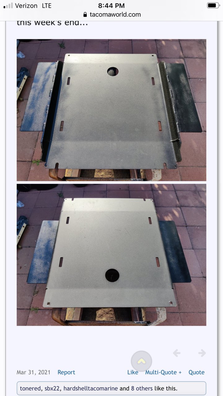

    I’m waiting on my rci trans skid and I’ll be adding “wings” to it so assholes can’t steal my shit

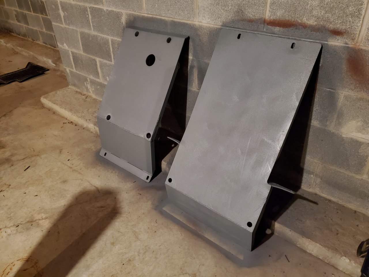

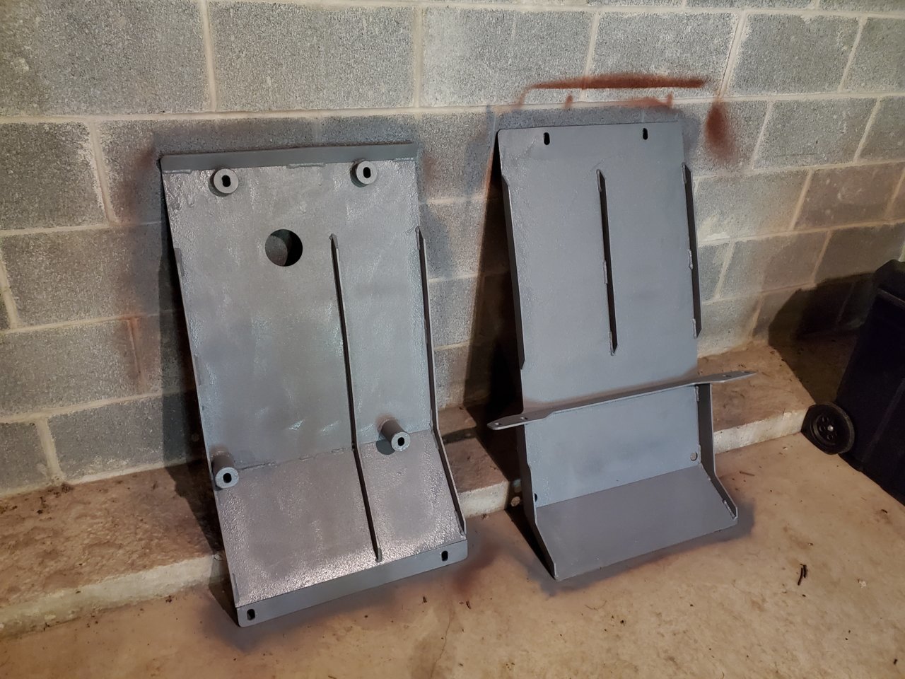

    INSTAGRAM: JWIZZMASTERWET #SUPERCHARGED #METALAF #HARAMBE PERFORMANCE/FUNCTIONAL UPGRADES: -URD Supercharger -Sound Deadened cabin with Noico Solutions 80mil -Skar Audio full pro-audio setup (2xtweeters, 4xmids, 3x10inSUB) SUSPENSION/LIFT/TIRES: -ICON Stage 4 (650lb coils) -ICON RXT Leaf Pack (Option 3), -285/65/18 BFG KO2 FUNCTIONAL(eye candy?): -Rave OffRoad roof rack -Rave OffRoad 43in light bar (amber + white) -Rigid led PODs (x4) (mounted along roof rack) -Westin Side Steps -BakFlip tri-fold tonneau cover -VOODOO Fabrications hi-rise crossbars -Pelican Case loaded with recovery gear(mounted to roof rack) -Smittybilt gen 2 overlander tent -Smittybilt recovery boards -HI-Lift Jack COSMETIC AND NON-PERFORMANCE UPGRADES: -Custom front grill -Bumper Shellz rear bumber cover -Meso Customs full interior chrome delete -Interior of cabin lined with sound deadening material (Noico Solutions 80mil) -Rear seat delete and custom shelf (home-made) AUDIO (SKAR AUDIO): -2x pro audio tweeters, 4x pro audio mids, 3x 10in subwoofers (SKAR AUDIO) -1x RP-1200 amplifier (mids), 1x RP-2000 amplifier (subs), 1x SK-400 amplifier (tweeters) (SKAR AUDIO) -Audio crossover
    Gray RAPTOR liner on Coastal Offroad SKID PLATES

    this is from a other member , similar to what I plan

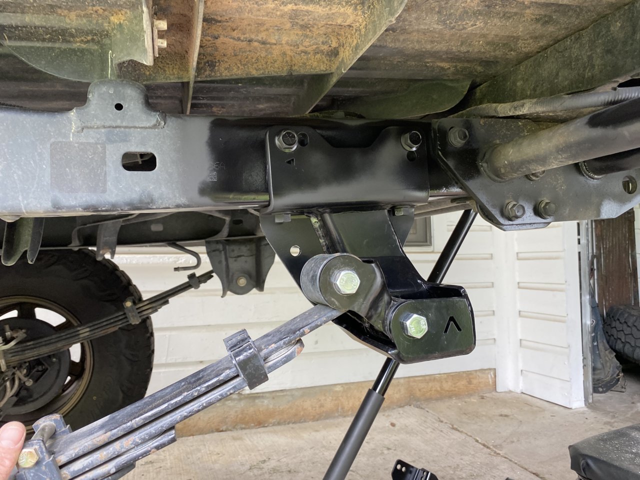

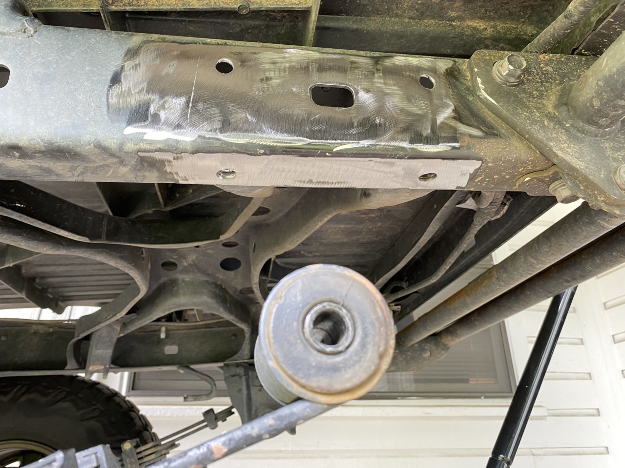

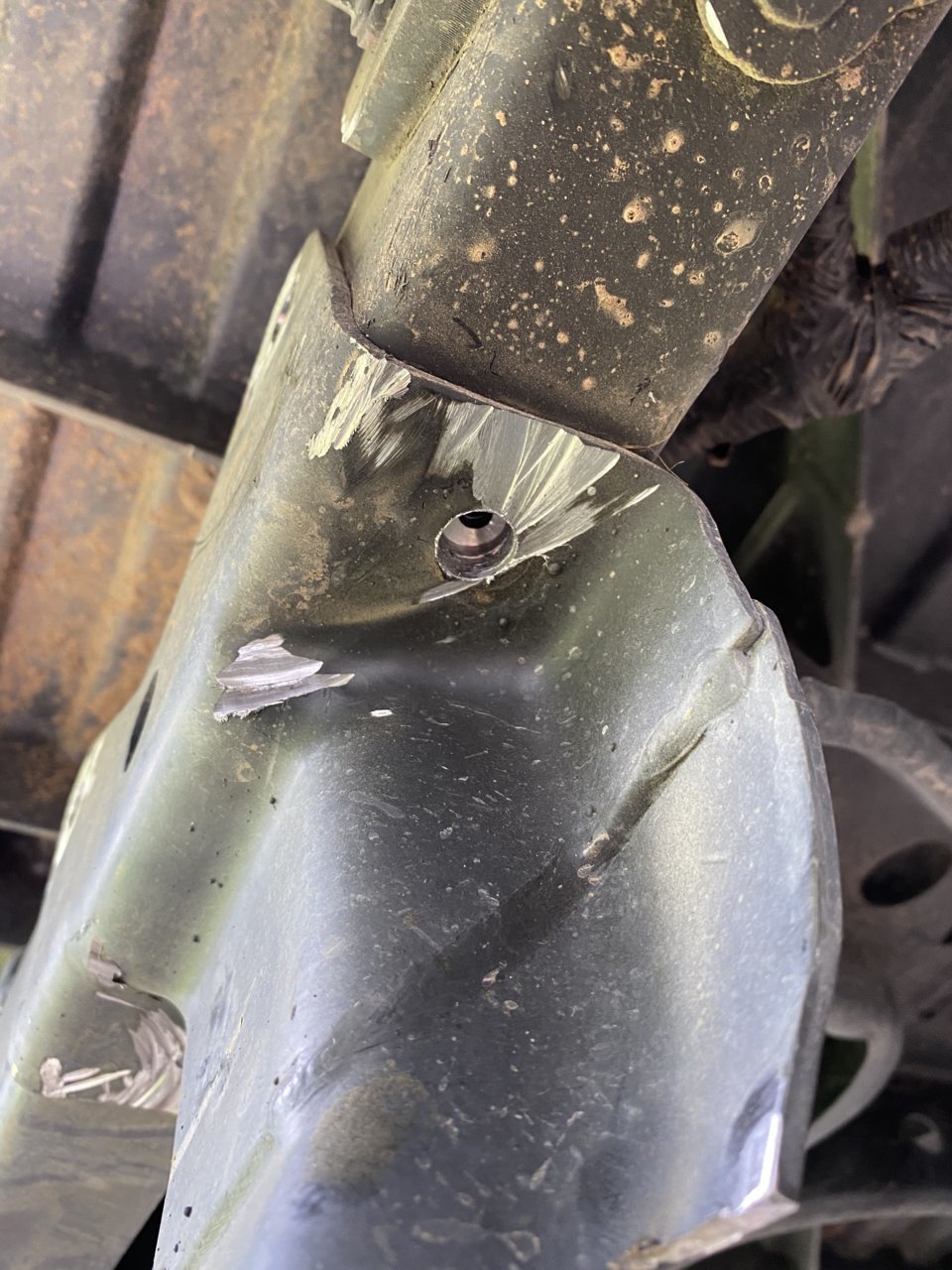

    Lots--

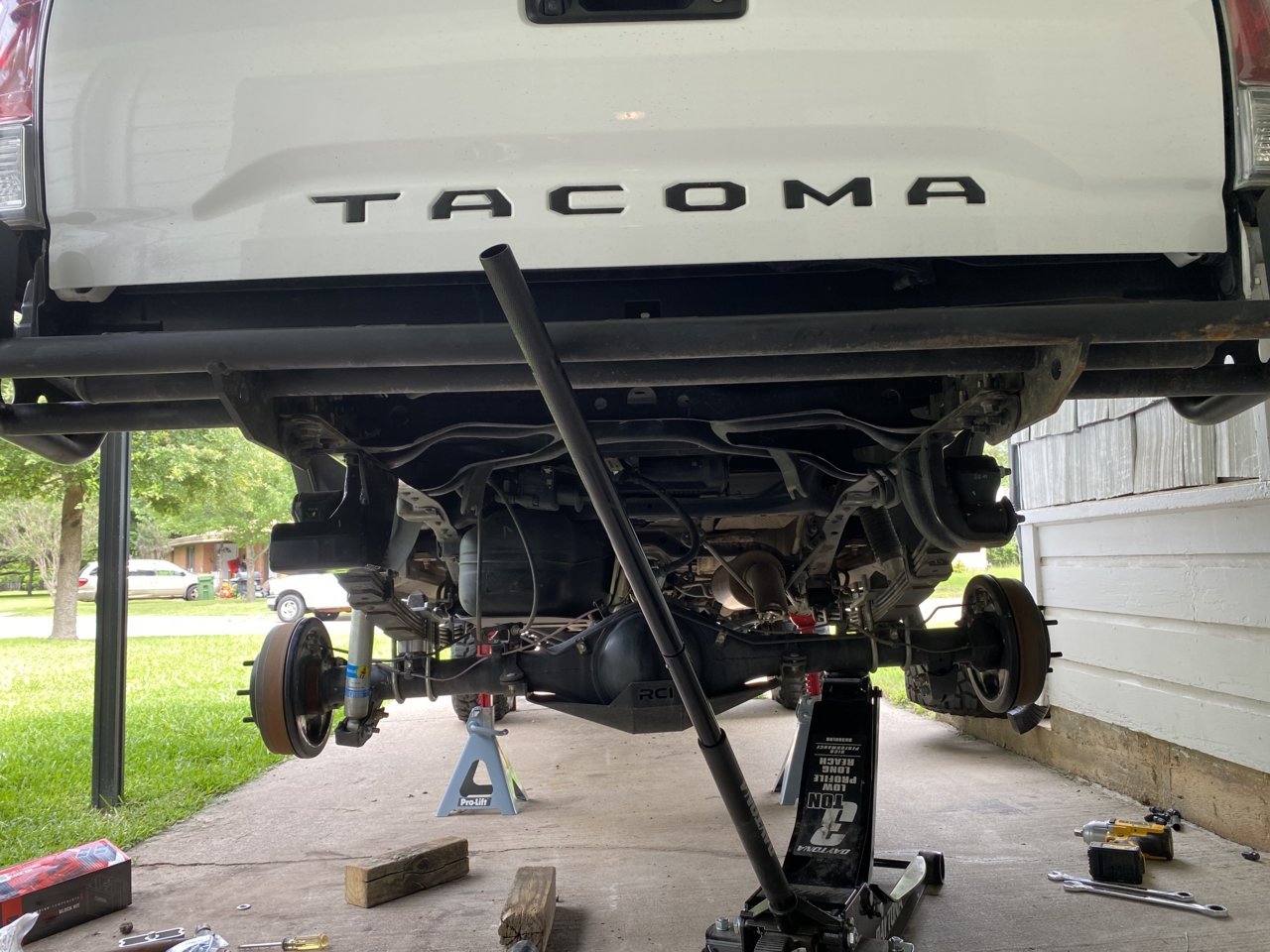

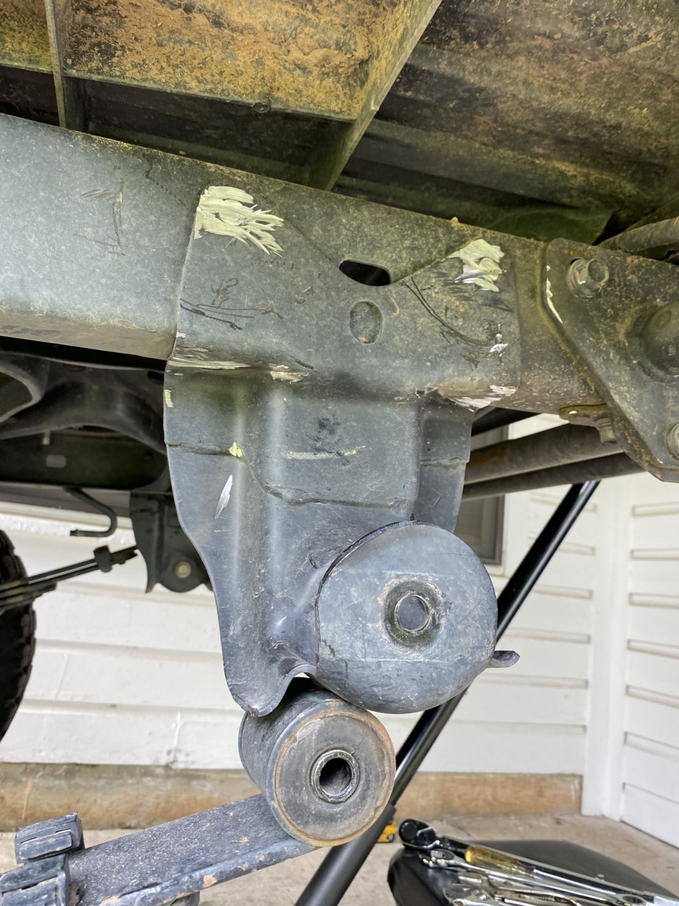

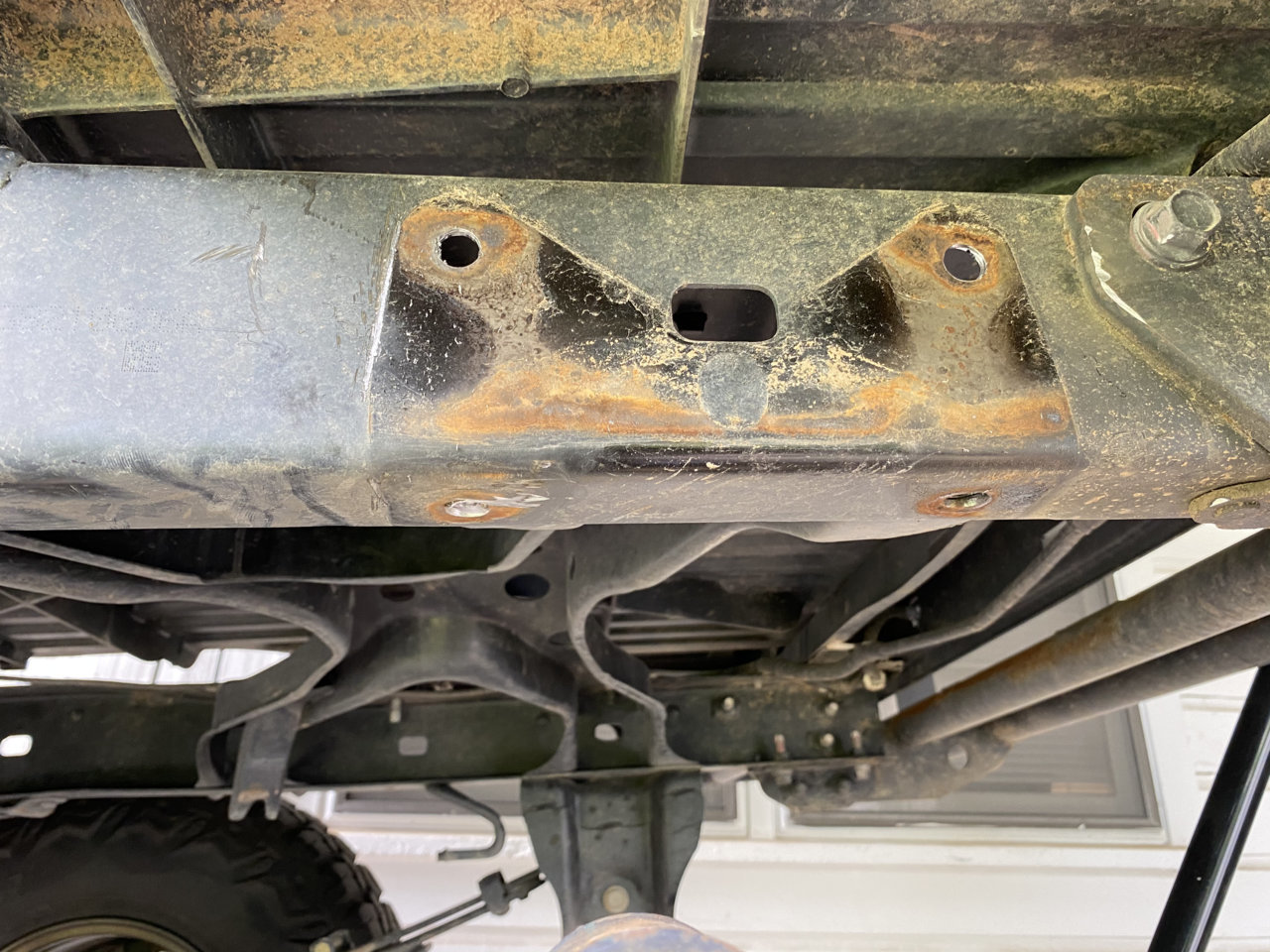

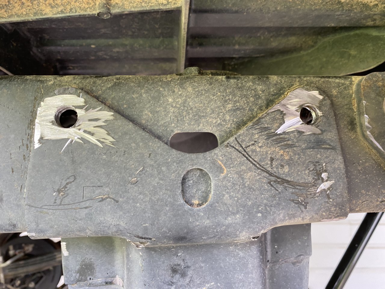

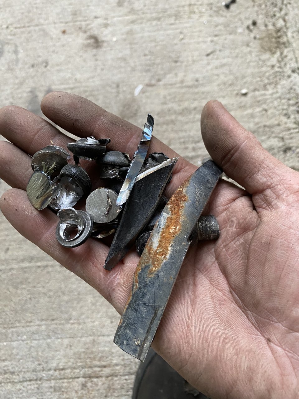

    Hammer hangers and crossmember done. Added a 1” block to my existing icon aal. Def have some rake. Will adjust coilovers tomorrow. I hate spanners
    side note— need a new bolt flip and prob some decent bump stops. The ubolts are def close to stripped.
    this install was a bitch! Lolol fuck those rivets. I actually cut part of the stock hanger to make it easier to drill. Made it easier for sure... glad I have protein here. What a workout above your shoulders. Lol
    I didn’t take a pic when I finished. I need to figure out how to connect the crossmember up top. I’ll prob weld it so it can be connected and disconnected remotely easy. Crazy how much rust under the stock hangers. It’s a 2020 with 16k miles. You can see the difference with hd hangers vs stock too:

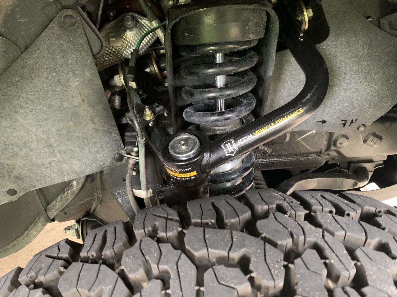

    I finally got my Icon upper control arms installed. Looks and drives great.

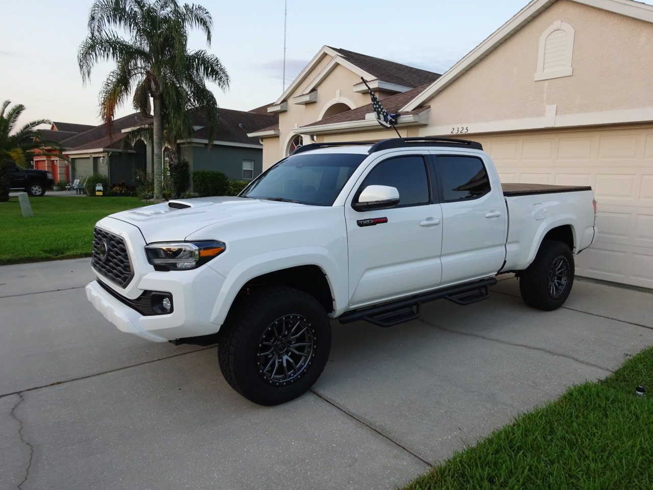

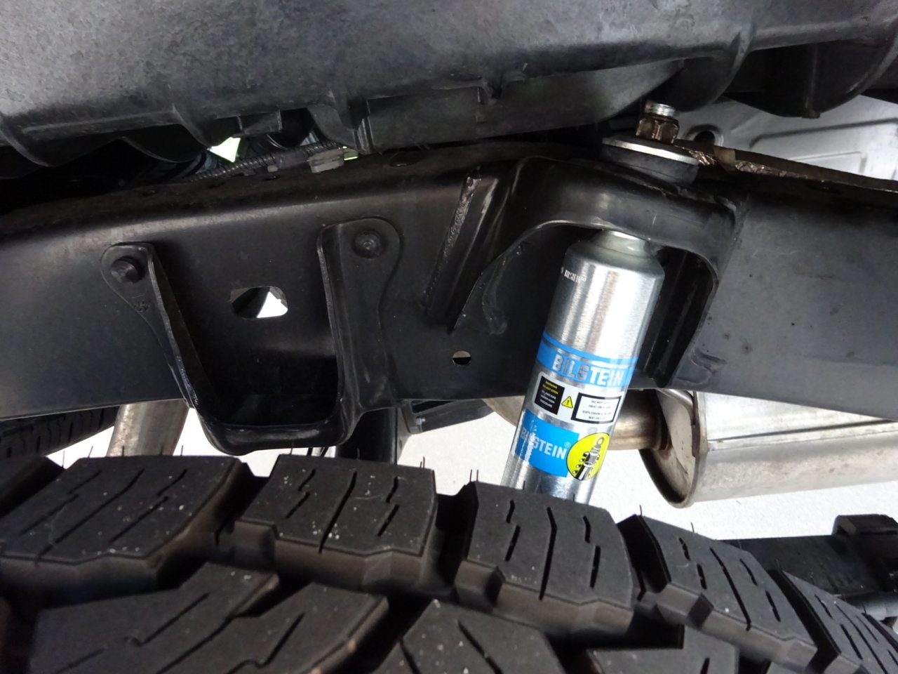

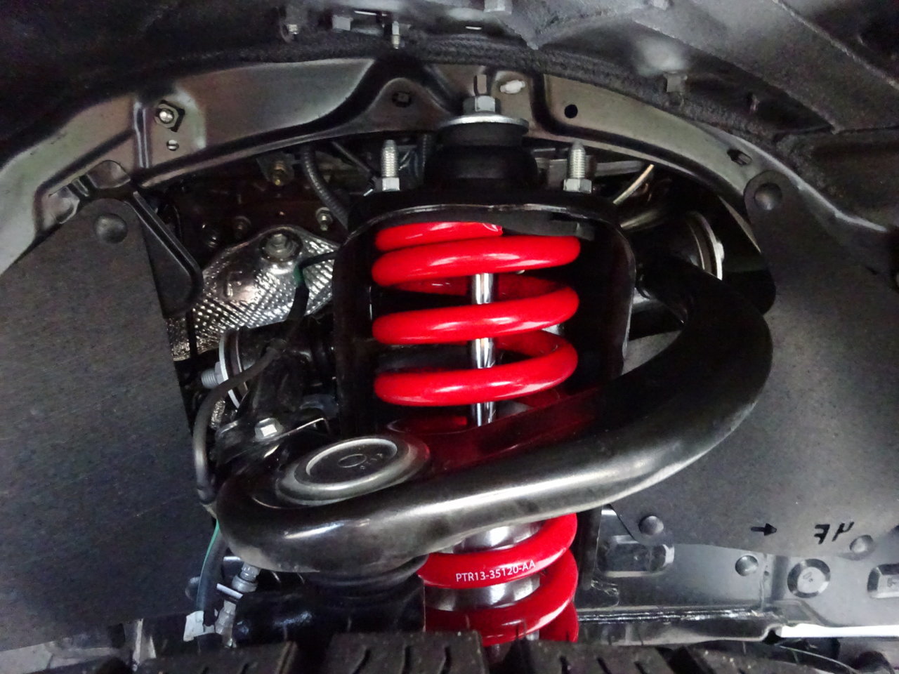

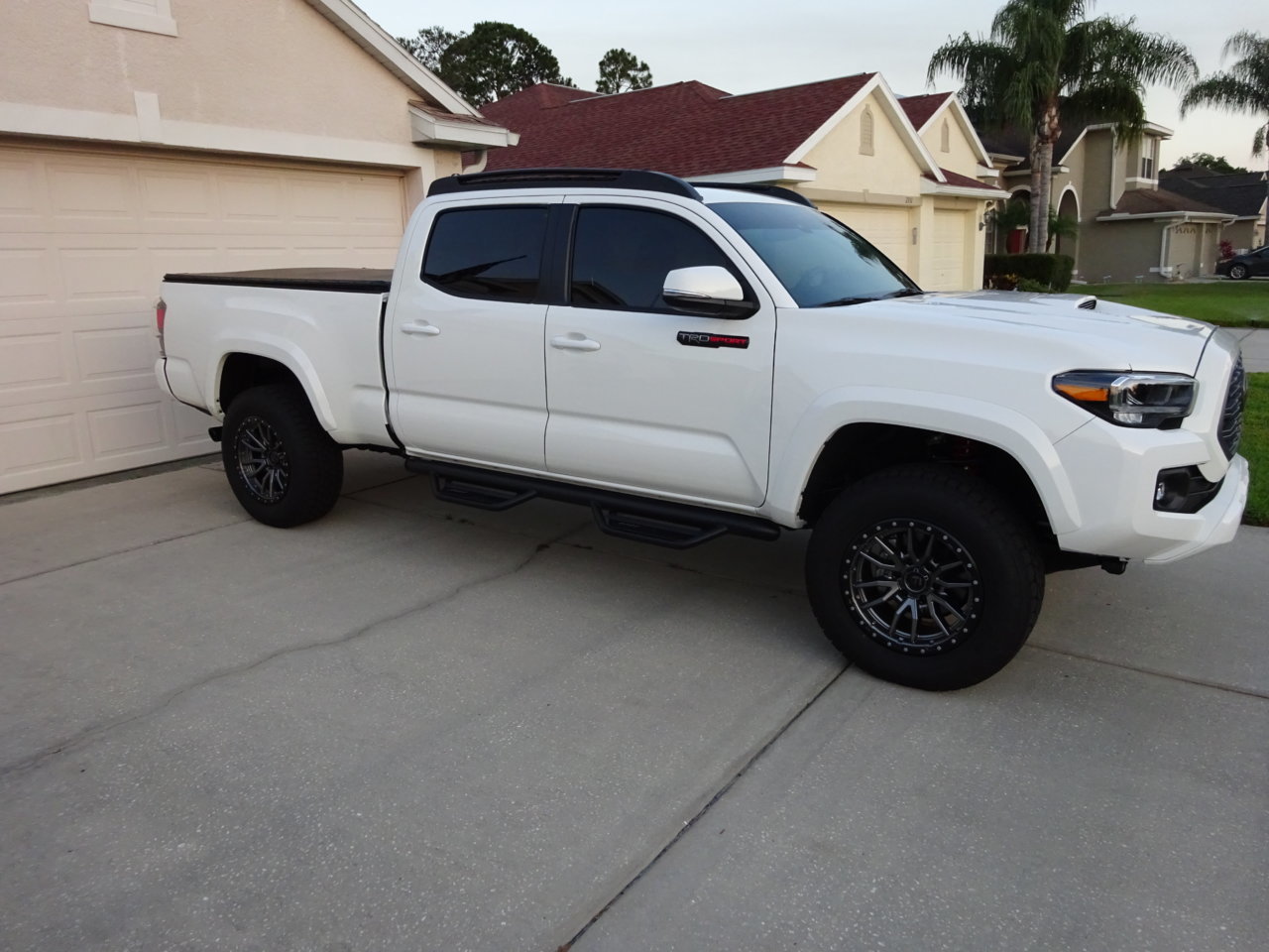

    Added Bilstein 6112's w 650 TRD coils set at 2". Also added N Fab side steps.
