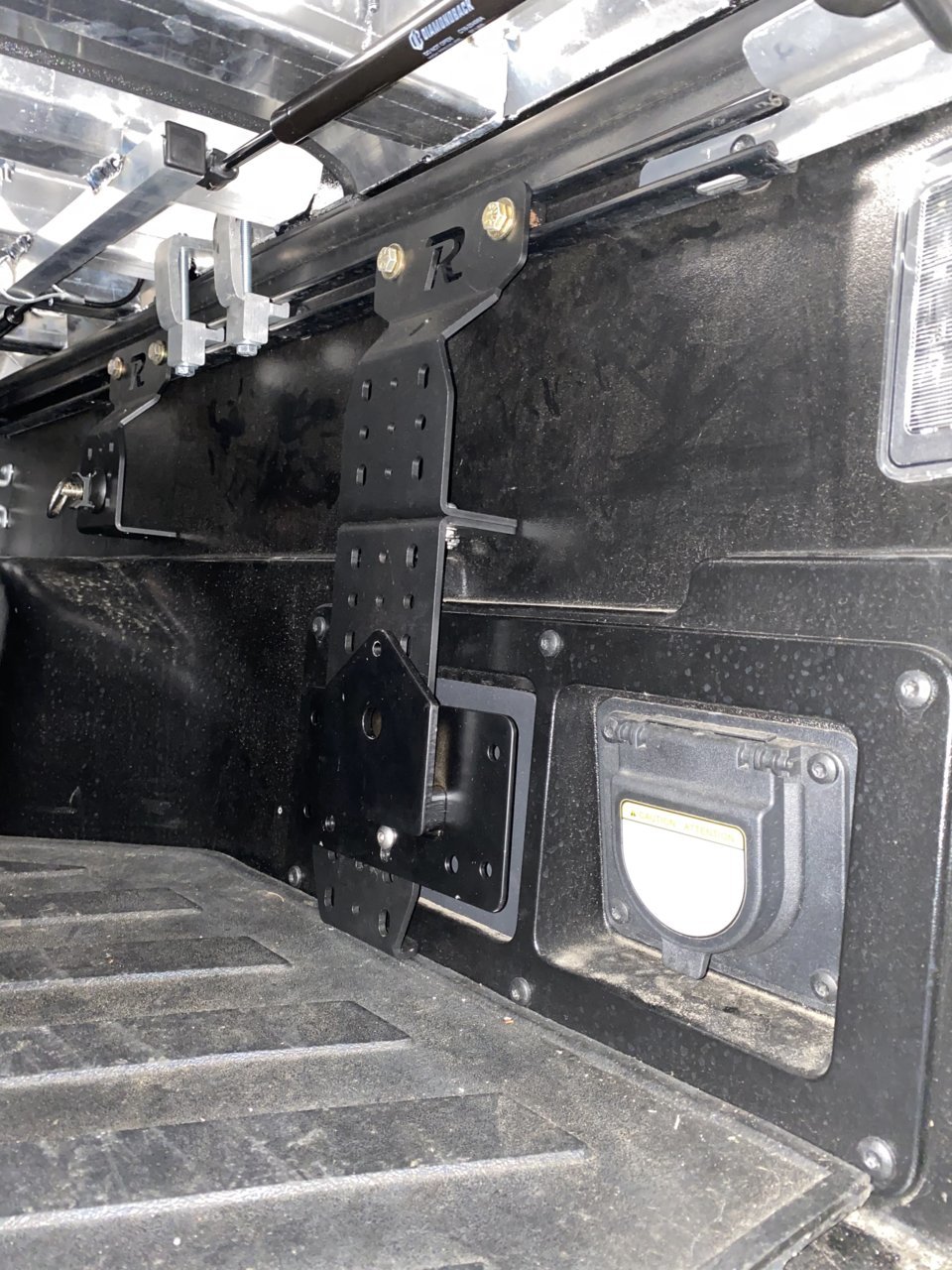

    hahaha its usually cleaner. Im waiting in parts for a fishing reel.
    It comes with a bracket i just need bedrail hardware

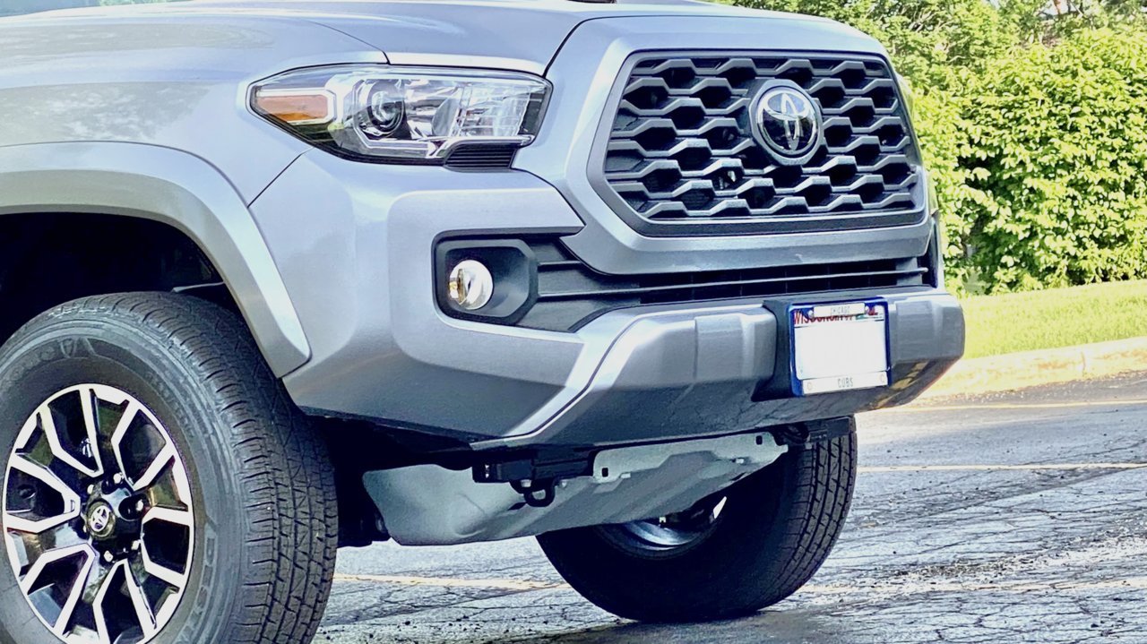

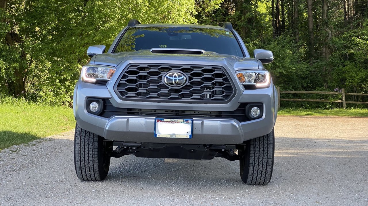

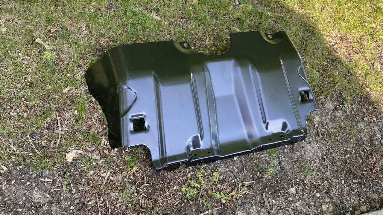

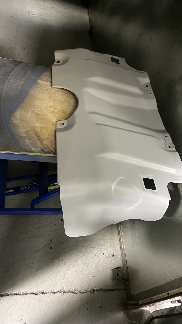

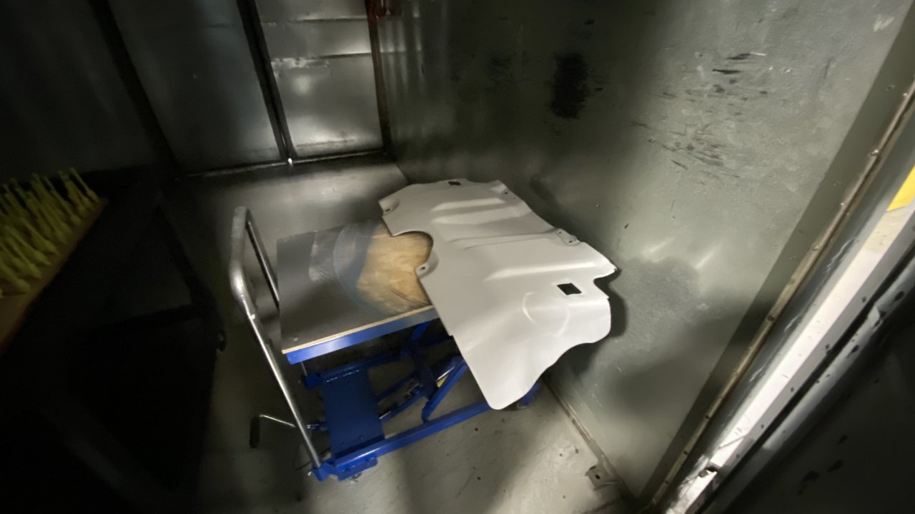

    Painted the Stock skid.
    The Before.
    Removal (209 miles)
    Prepped, primer, painted, and oven baked.
    Painted product. Clean finish!
    Better than factory fresh!
    Back on!

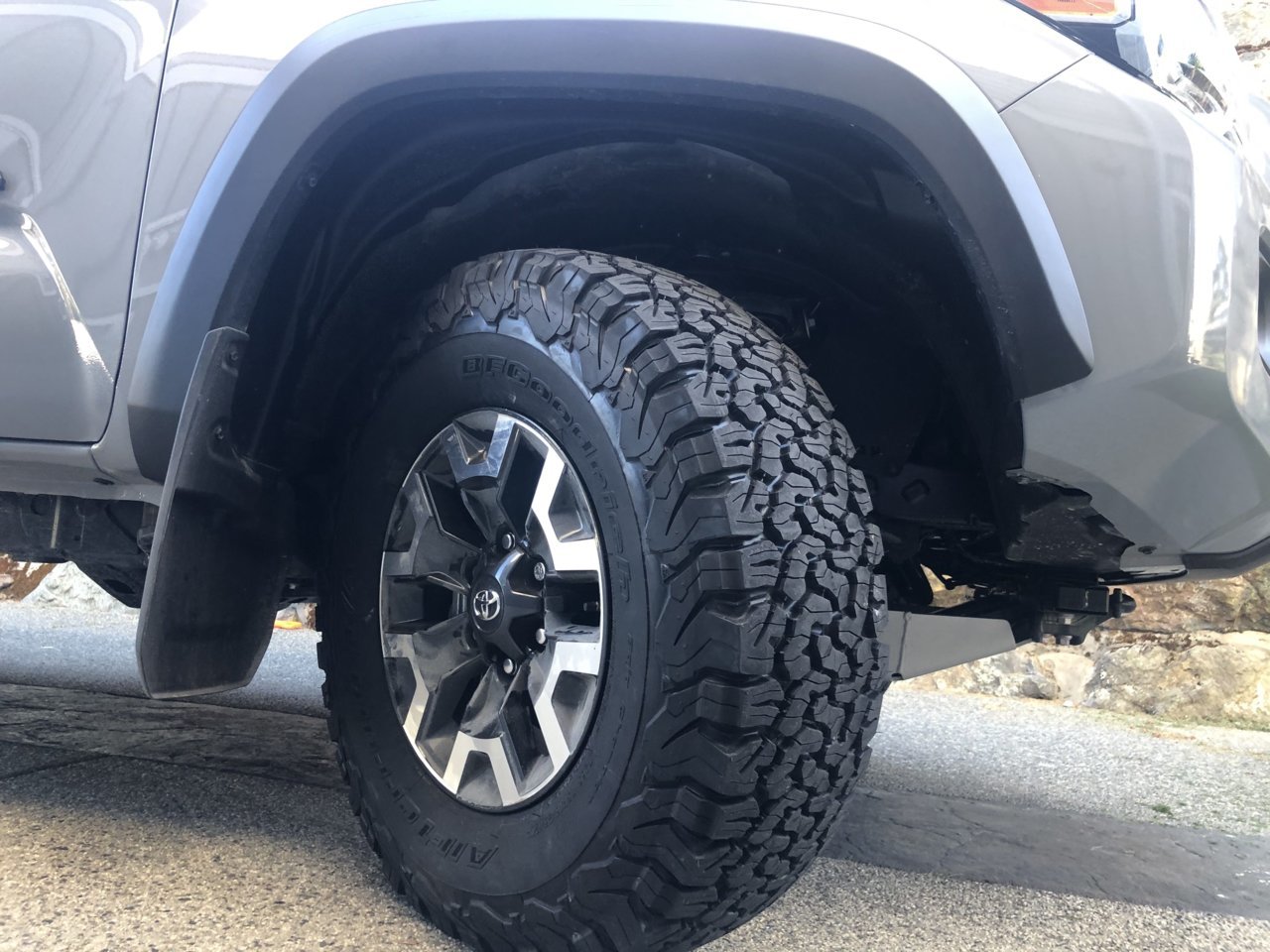

    I just lifted my 19 limited tacoma tried fittin 275 65 18s on limited wheel but rubbed the uca. What should i do now?

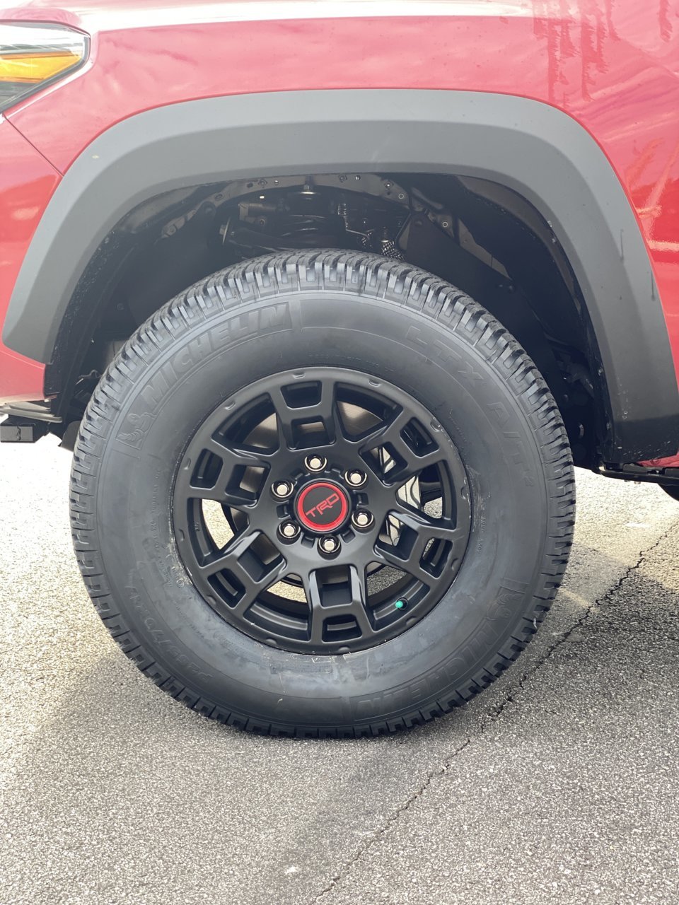

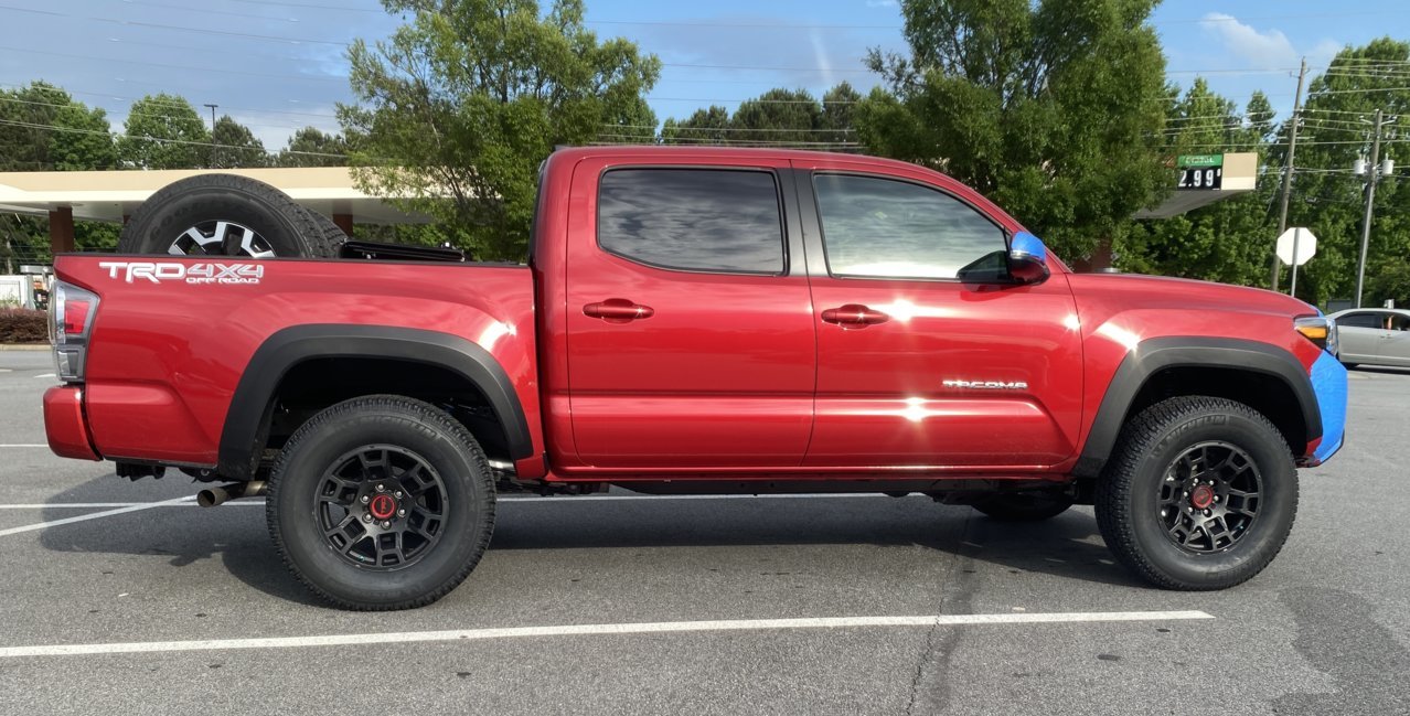

    Was able to get the 2021 4Runner TRD Pro mounted on my new truck with the help of @marinemonkey grinding a bit of the hub ring so they would fully seat. FYI: the 2021 version of these wheels looks slightly different than the prior year SEMA wheels and wont seat fully on the rear hubs without a little modification.
    They’re wrapped in Michelin LTX A/T2s in 265/70/16. I love them.

    i did that as well, minus the oven bake.

    Shop for a new set, camburg makes a nice set for about $600 with a ball joint and total chaos make an awesome uniball but they are pricy. Either way you can’t go wrong only option if you want to keep that tire size. Depending on how lifted you are the stock uca’s can bind up on the spring at full droop.

    No expert, but this ^^ seems to be the best route. Could get different wheels with a different offset if I'm current?

    What size and kind of lift did you install?
