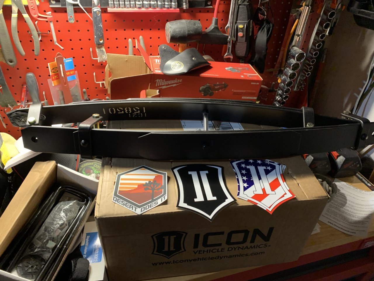

    New suspension. Who dis?

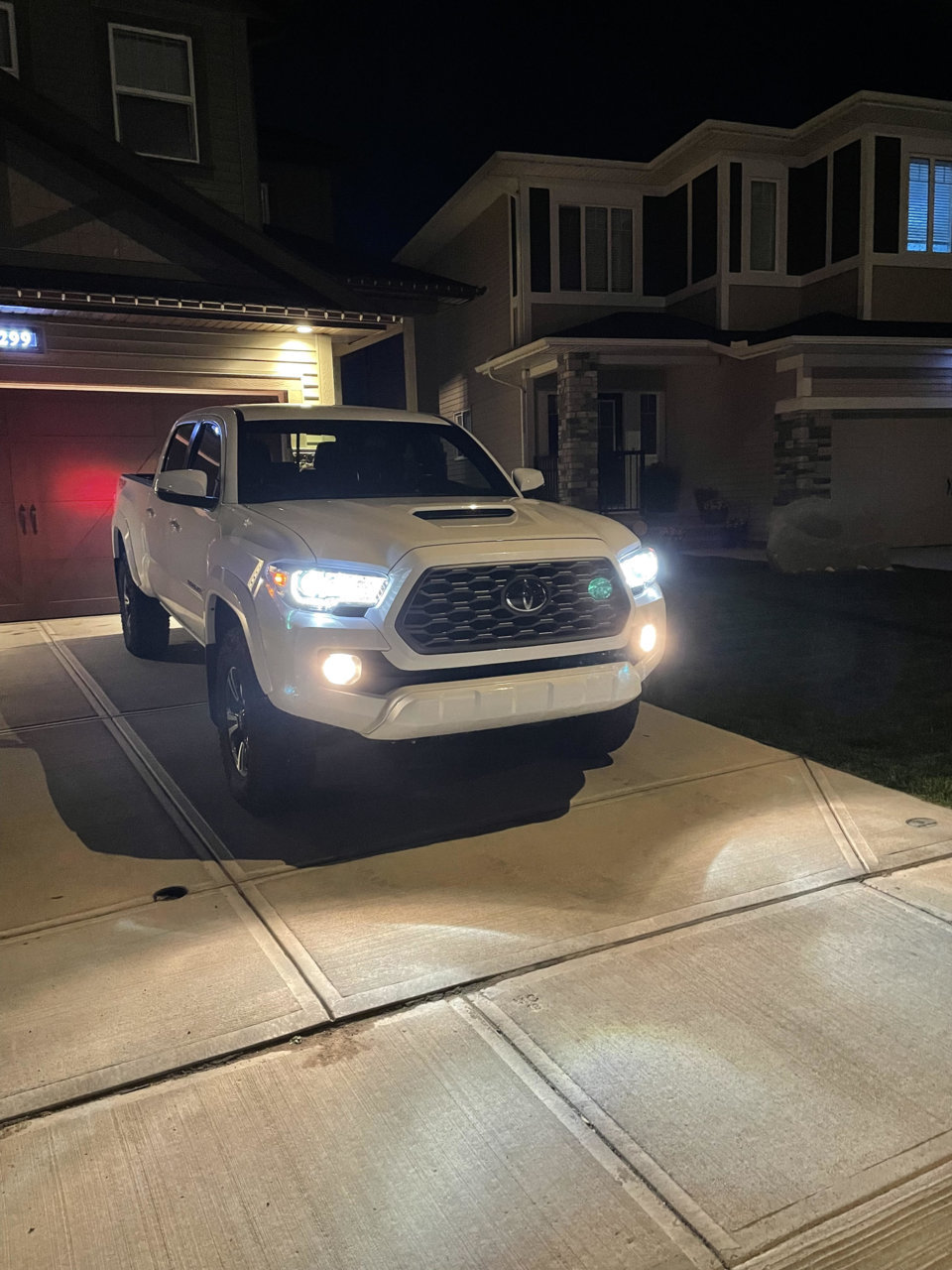

    Added some Diode Dynamics SL1 H11's in my low beams. Incredible change for a pretty low price.

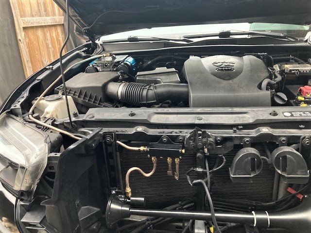

    I felt the horn on the Tacoma could use a little help...
    So I installed a little 26" horn. Black so it blends in...
    https://vixenhorns.com/product/vixen-horns-vxh1168b-semi-truck-single-air-horn-black/
    Installed the 3/8 double flared copper lines from the compressor to the manifold and then to the horn...
    the 2 RH pieces of tubing coming out of the manifold are just there to seal it off until I run the lines to the air tank with a drain, and the air hose connector.
    Will paint the copper and brass fittings black so it looks more "factory" as well as the white padding in the front trumpet mount.
    It's fed from an ARB twin compressor so even though it starts out at 150psi the pressure drops off quick without an air tank.
    Even without the air tank installed and the weathershield on,
    it is very loud similar to a truck / barge type level sound.
    Standing in front of the truck and testing it with ear muffs on,
    I could feel my lungs rattling in my chest for the first second.
    From inside the cab the sound was muffled quite a bit ,and it was comfortable on the ears without ear muffs. Sound level was like a Semi blowing their horn beside you.
    No extra holes were added/drilled, Used Unistrut for the bracket on the left side holding the horn base at the back, and a 90deg bracket on the trumpet base that goes to a rad support hole.

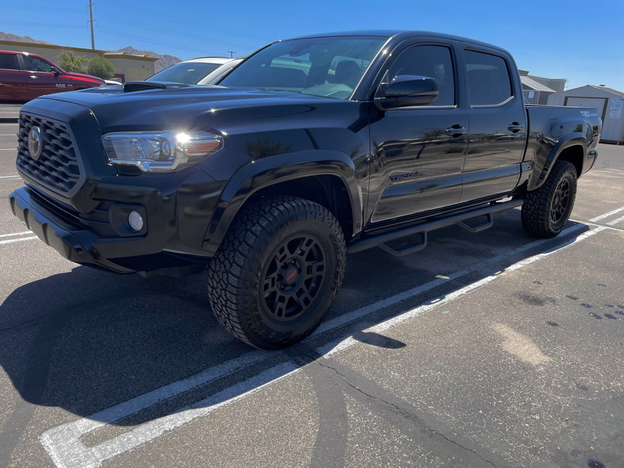

    Purchased and installed the TRD wheels. I'm not a fan of the newer look.

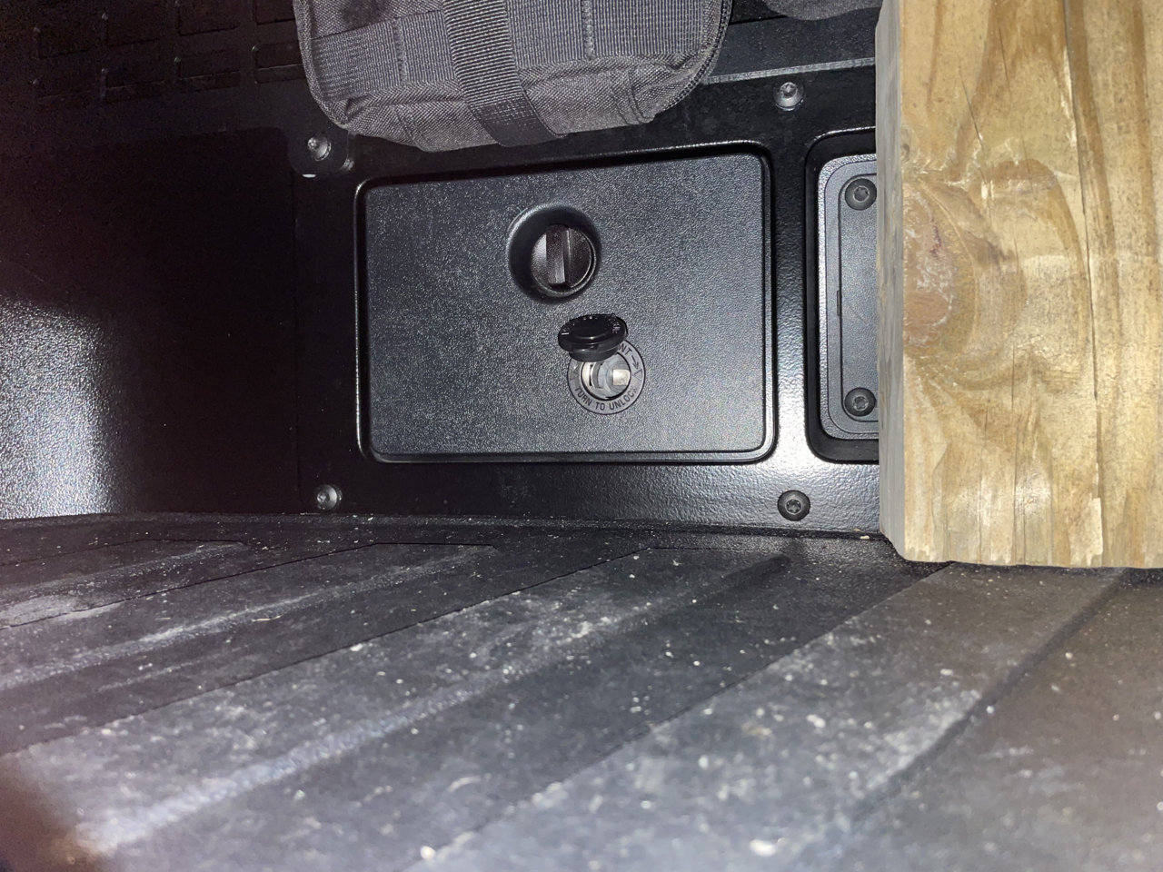

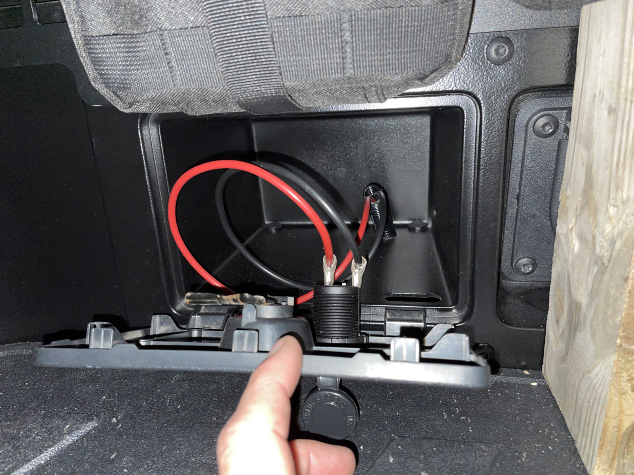

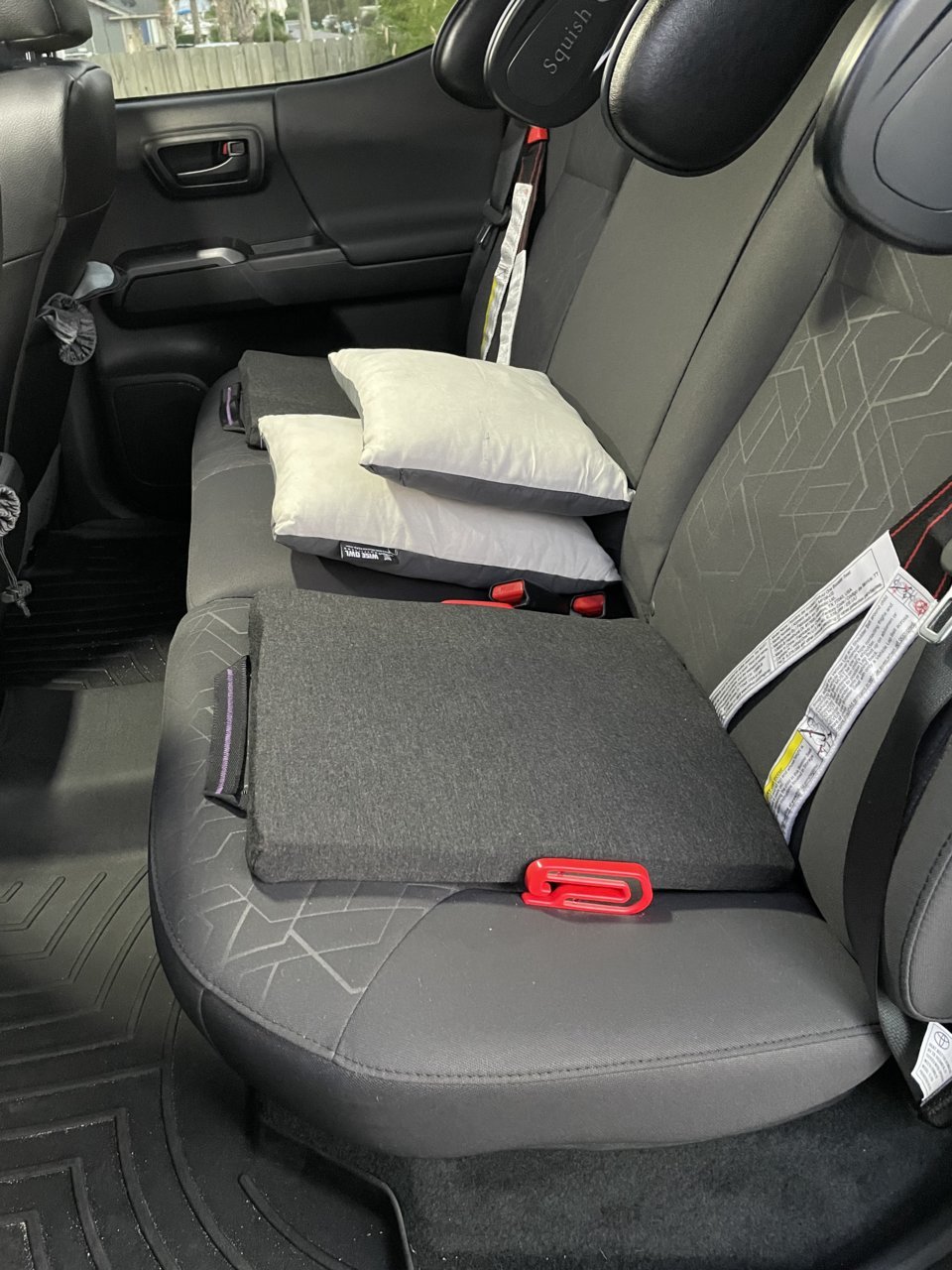

    Update to previous post with missing pictures
    I used a 4x4 as a spacer to not cover the vents and still strap it in (again as a temp solution)
    The purple cushion (bleacher size)

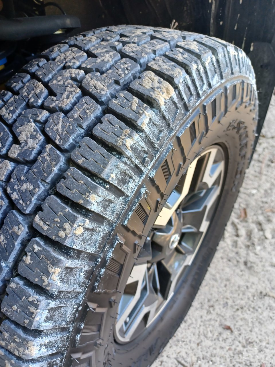

    I have the same tires in E loads. Was a little apprehensive about running Es, but about 5000 miles later, I don't regret getting them. Pretty good on and off road.

    Looks great!
