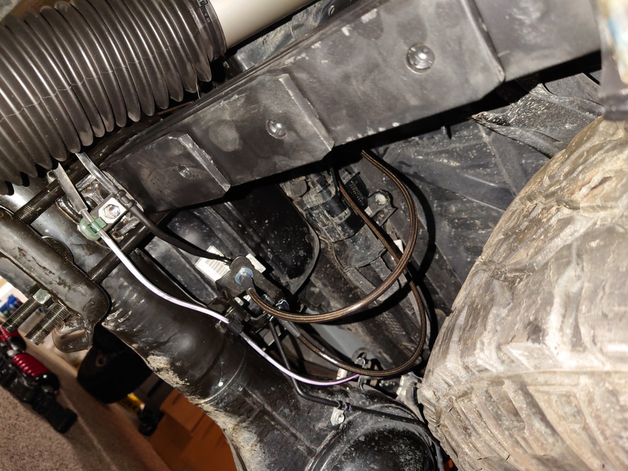

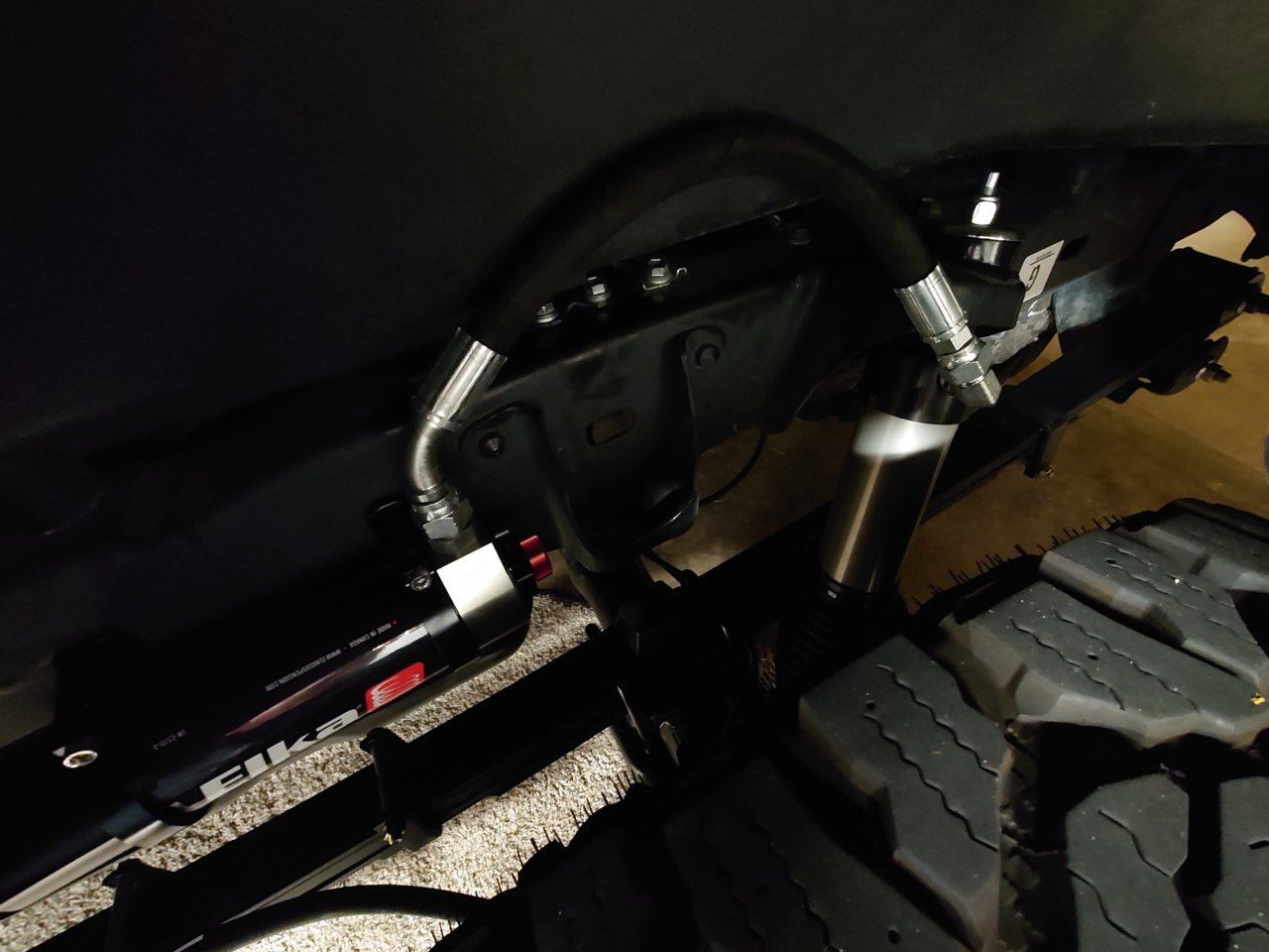

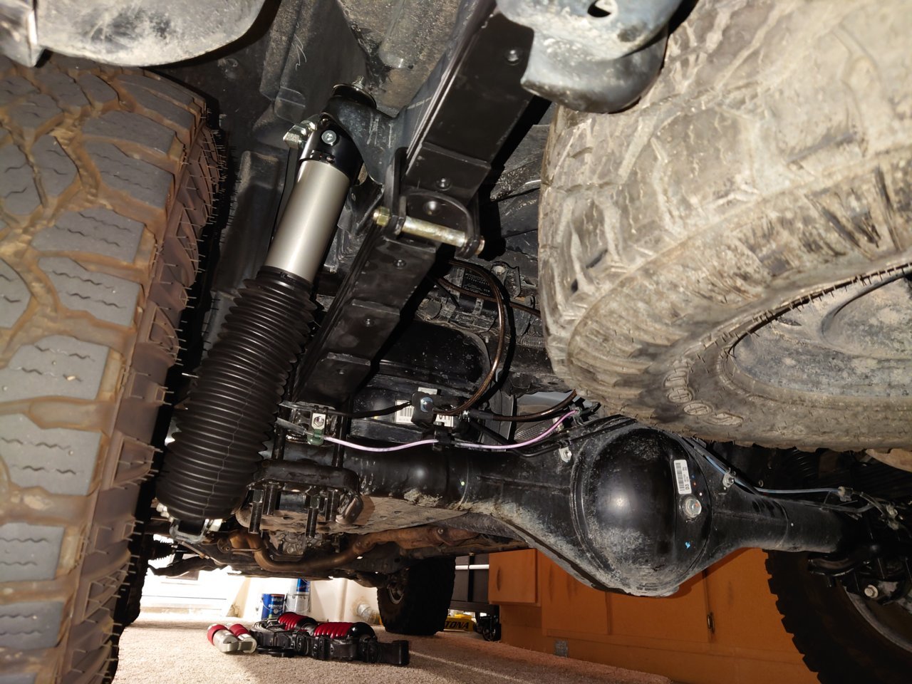

    Got the rear setup done today. Elka 2.5s with external reservoirs and adjusters, Icon RXT leaf pack set on option 2, ARB carrier bearing drop, and Wheelers extended brake lines. My stupid self forgot to take photos during the process, so all you get is dark close up shots while parked in the garage for the night. :(
    Also, since a bunch of people are PMing me and asking... yes, my old setup is for sale. TRD Pro Fox 2.5s, Westcott front lift kit, and Headstrong AAL. Shameless plug: https://www.tacomaworld.com/threads...eadstrong-aal-lift-shim.726735/#post-25888079
    I didn't expect this, but the brake lines were the least pleasant part of the whole job today. Doing anything with brake fluid is so messy and un-fun. Plus, these lines didn't have the big flange on them that pulls them tight against the brackets when you slide the spring clip in. Instead, they have two sets of slots, and you're supposed to install a spring clip on each side of the bracket. But... they didn't come with any clips. So I had to drive down to my local parts store, and the guy found some generic spring clips in the back that worked. Saved my butt, too, because the dealership couldn't have them until Tuesday, and the old lines were already off and I wasn't looking forward to reinstalling them.

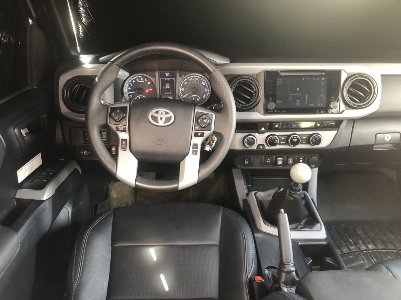

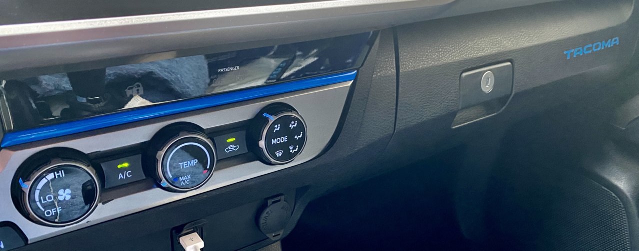

    It’s very easy to overdo especially with the mod bug infection we get from our trucks. The color it’s self can make it obnoxious as well. I took the cues from the design team at toyota and just made everything chrome black and everything gunmetal grey cement grey to match the exterior. There’s a lot of cement grey now, but I really don’t think it’s over done. E7EB0A52-0761-4AB5-8C5B-289A60E952D5.jpg
    The bezel inside the instrument panel was the biggest PITA. No clue why toyota made the plexi a sealed unit.

    One of the most tasteful interior mods I've seen. Nicely done

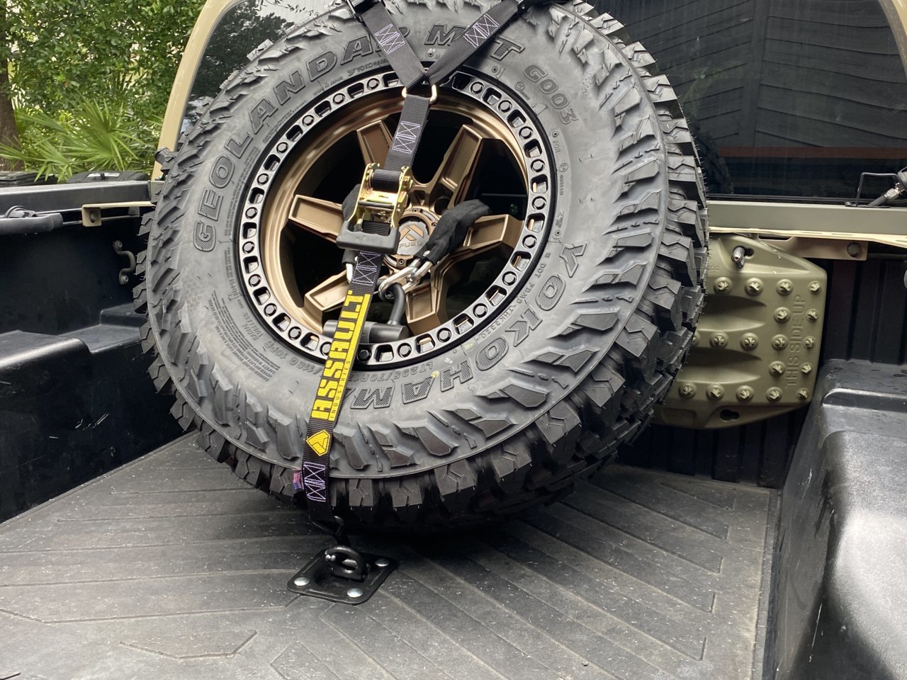

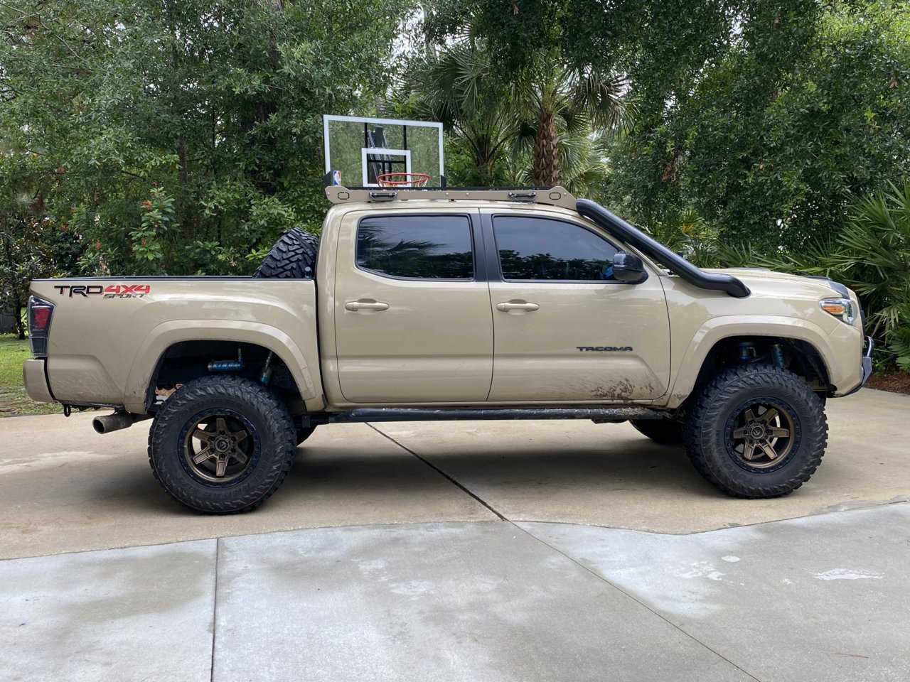

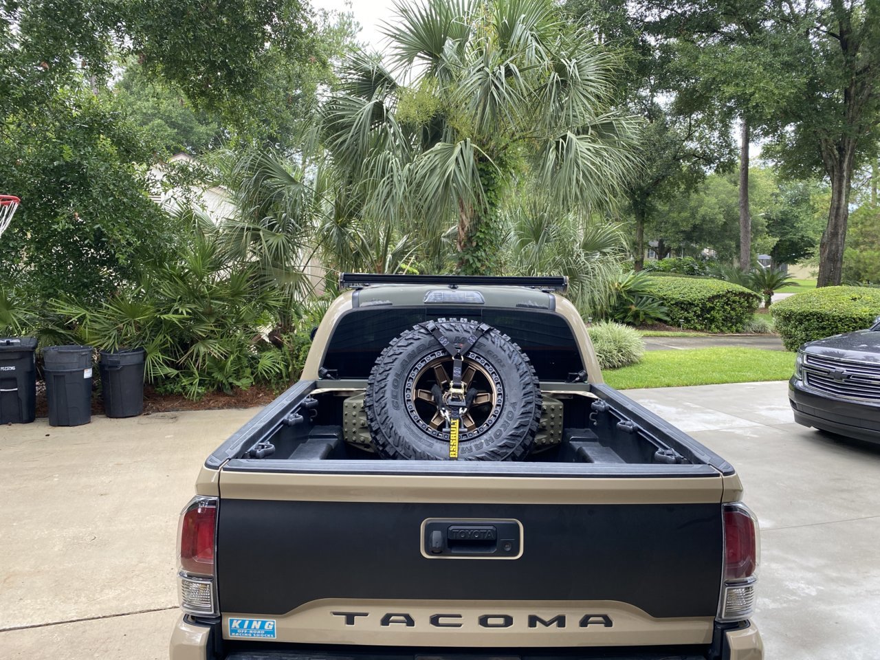

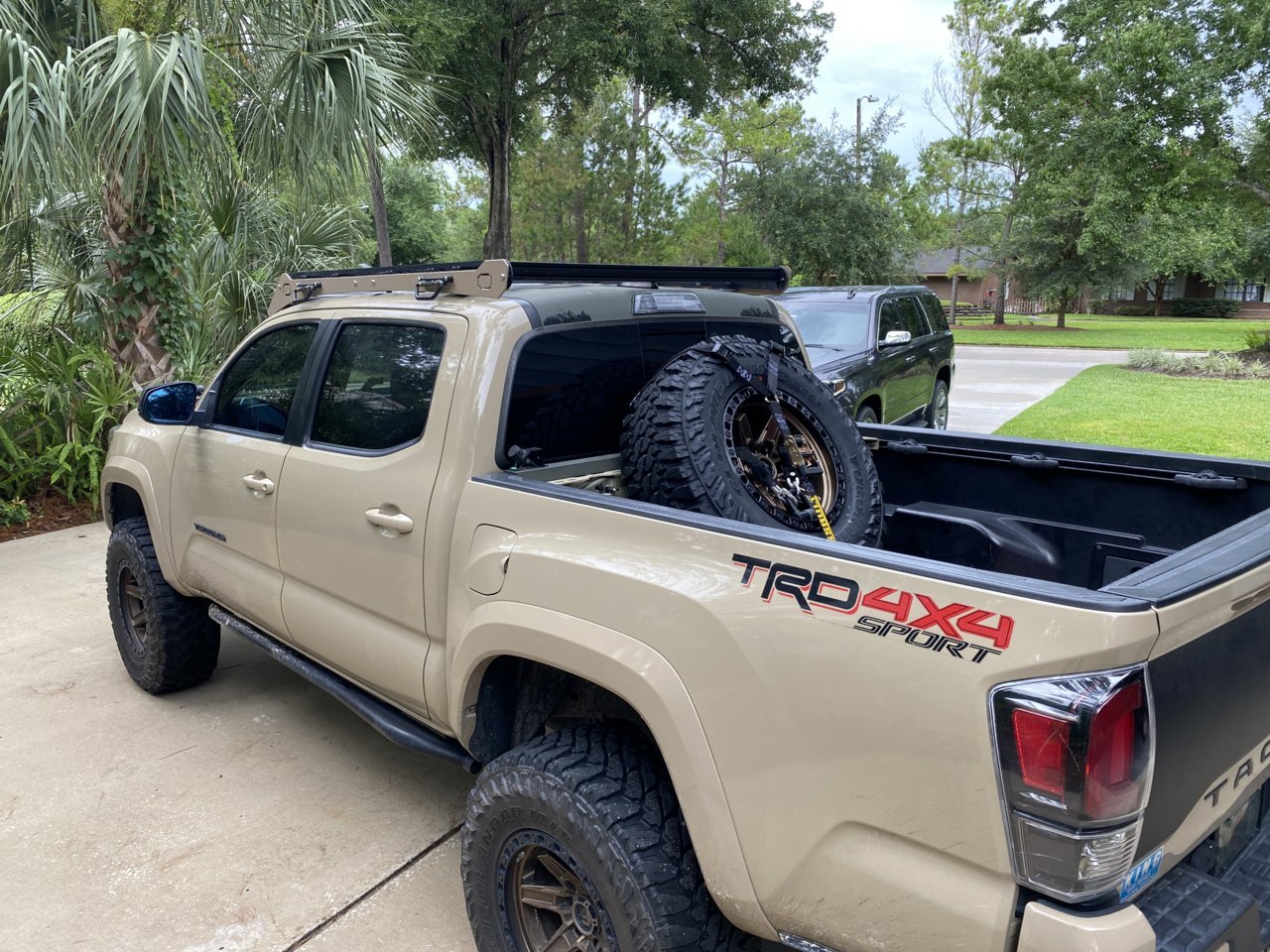

    Wrapped up my spare tire set up on Saturday in preparation for the Archive Garage install. I have been tracking down odds and ends to get the fit just right for about 2 weeks. Will have the install video up soon. Sneak peak pics.

    I like the set up, but does it interfere with getting the Trax out?

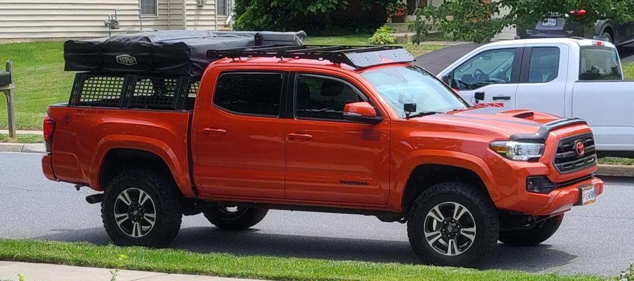

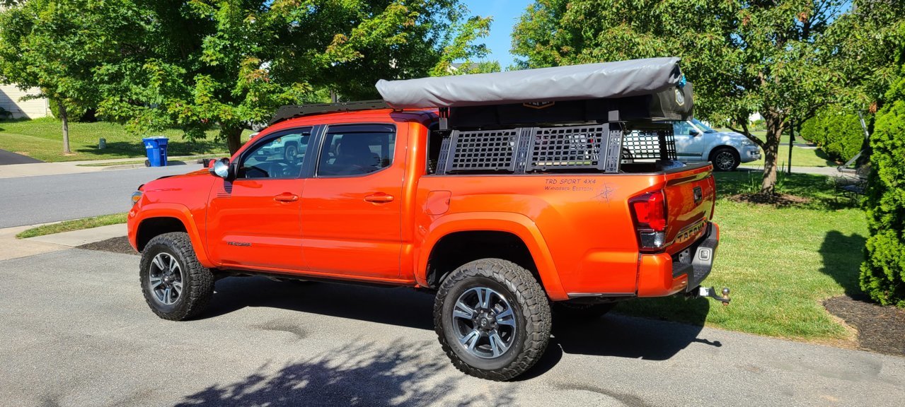

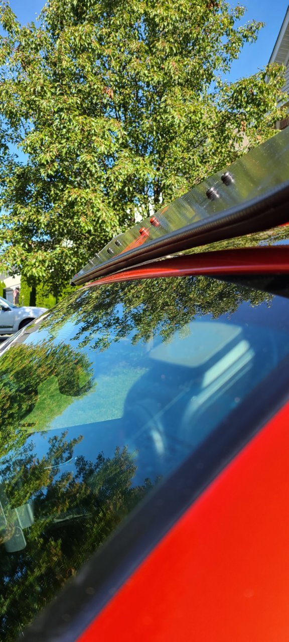

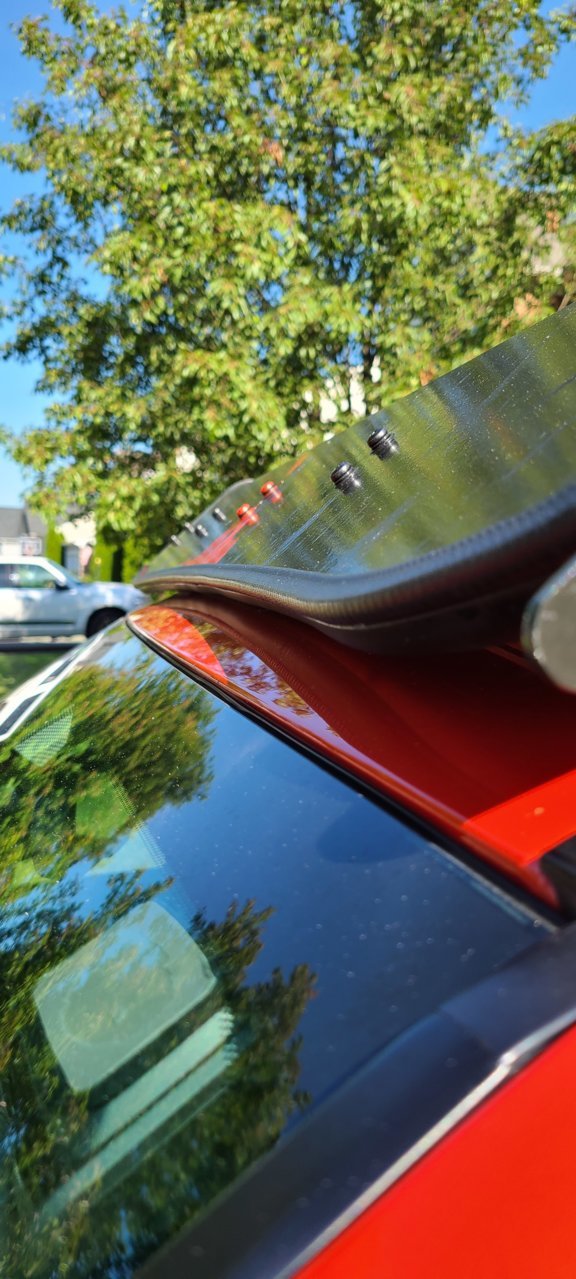

    Over the last few weeks did some small stuff.
    Solved the wind noise from the roof rack by switching out the edge trim. The wind coming under the faring was the culprit. This is the new trim.

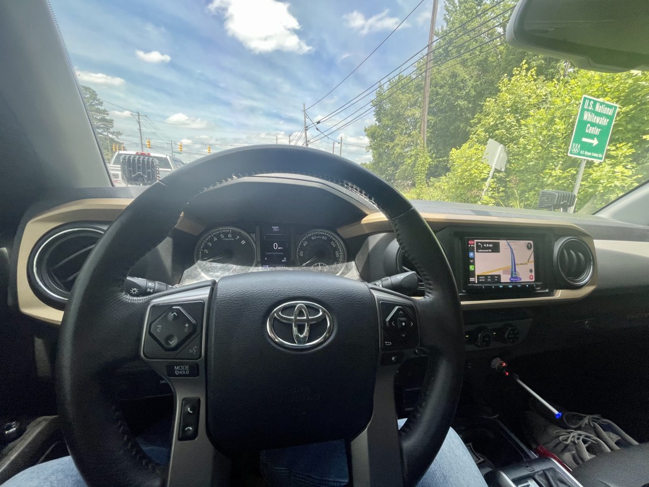

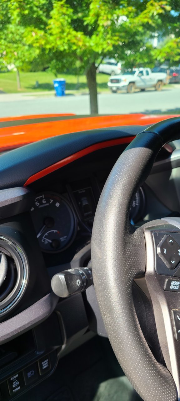

    Finally brought some Inferno inside the cab.

    Dud you reupholster the dash and door trim?
