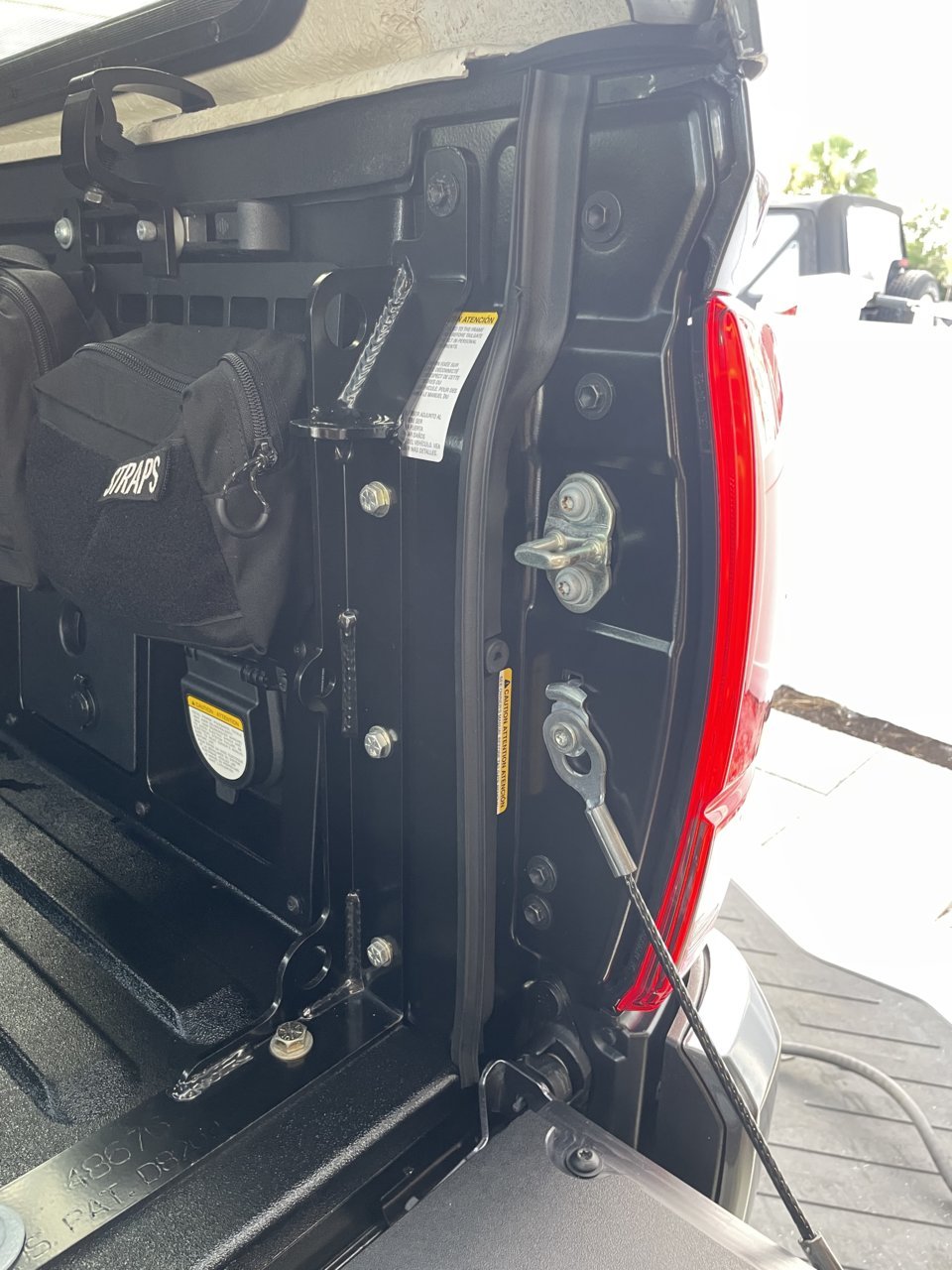

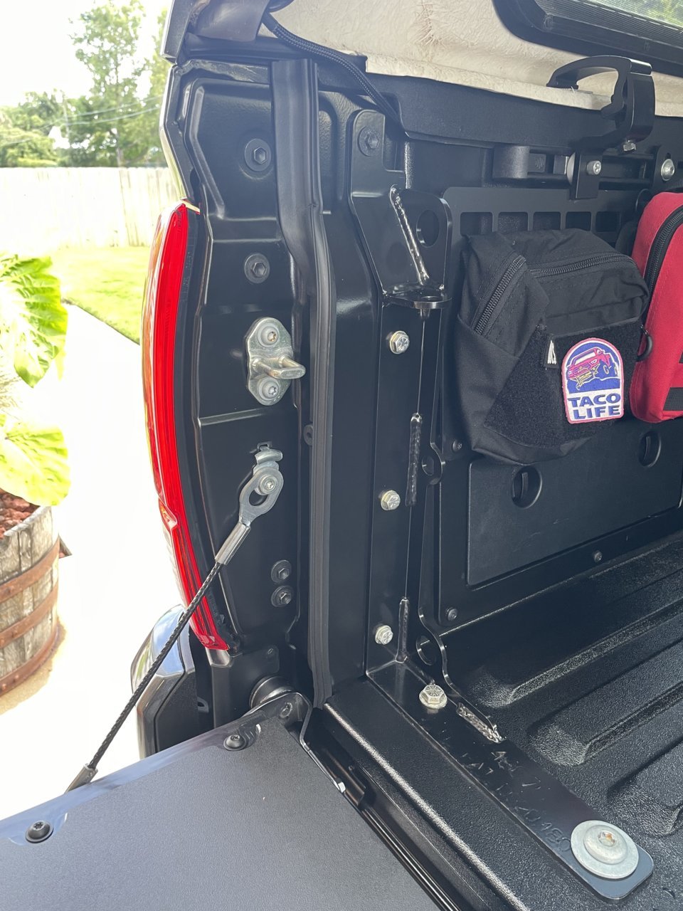

    After 2.5 yrs in the garage I finally installed the esi tailgate seal. Made some Minor changes in the directions… notch the seal vs 2piece cut and 3m 94 primer. Also precut the rokblok but wanted to run a test on install (specifically tailgate side). Didn’t really want to stick it on top of the mountain hatch so thought of below, sandwiched (which I may or may not of seen in this thread). Then thought maybe it would be enough to just pinch the seal between without utilizing the 3m tape. So I used the left over piece and installed it just like that (minus the 94 primer) and I’ll test it over the week to see if it stayed in place

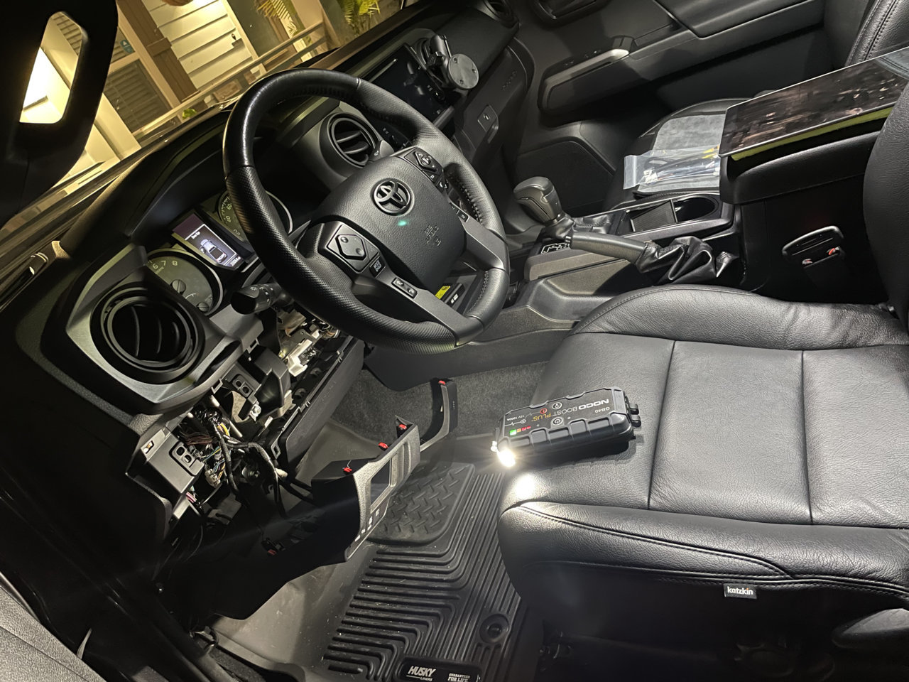

    Also installed the 12volt remote start. Wrapped the connectors in foam tape (need to go back in and zip the connectors together because I forgot), this foam tape is similar to the tape used on the connectors in the oem tailgate lock… just in case of rattles. Would like to figure something out for the module for a tighter/secure fit in that slot. Also not sure where others placed the warning sticker- I’m guessing the battery/engine bay? That’s the only thing I could think of is removing battery terminals would cause a need to be reprogrammed
