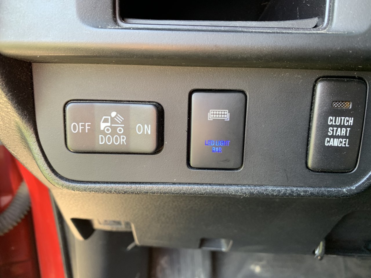

    I re-located my inverter button to the center, under the HVAC controls, and installed an OEM look LED bar button in its place.38F83EC0-9E92-46D2-A72F-6D2850E31D19.jpgD183237B-E13A-4EDC-AFFE-7D9C8868B156.jpg

    I too would like to know how you accomplished the inverter switch relocation. I assume cut and splice in extensions to the wire with solder or butt connectors?
    I haven't located a wire-to-wire male plug compatible with the female one but if you have please share :)

    I did in fact, cut each wire in the harness, and extend them a couple feet. I soldered each connection, worked great. I made sure to cut the wires about 3 inches from the plug itself to ensure I had plenty of wire on the plug side.

    Cool, thanks. If I ever manage to get my LSP-8 installed I'm likely to take that approach as well.
    The only other option I can see is something like:
    1. Take a good photo of the female connector and wire colors
    2. De-pin the female connector
    3. Fabricate male to female extensions of proper length (42-45") assuming male terminals are available (I think this is the case)
    4. Purchase terminal compatible wire-to-wire connectors (I believe this one is TE) of 5-8 positions
    5. Match colors and install pins.
    Though to go that far might be better off with just some generic 5-8 pin connectors, cut and crimp so you now have a short conversion pigtail, then do an extension in the easier-to-find connectors with color matched wires to get it to the LSP. That way you can undo later on and not have extra wire coiled.
    The in-truck crimping being the only annoying part but at least it's a one time deal.
    I think I'd be mildly tempted to use the green JST switch plugs since I have them and they go to 5 positions, IIRC only 5 of the 8 spots are used on the inverter switch.
    Of course I have yet to find any reason at all for 120v so this is all just pure fun and games. I thought it might be nice for someone in the rear seat using a laptop someday.

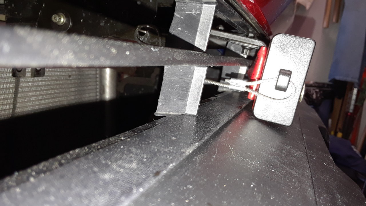

    Not quite sure what you mean by "flush". At least 1/3 of each plug has to be available to connect together.
    I routed mine out of the front with enough lead to allow a portable winch (inserted into the front hitch) to be connected. When not in use, the plug is secured flat against the grill.
    I simply remove the pin to free the plug to reach the winch, when needed.
    (I have an in-line switch so that no one can short out my battery by jumping across the plug connectors.)
    But flat against the grill is prolly not what you meant by flush.
    Secured
    Side view
    a step or two back
