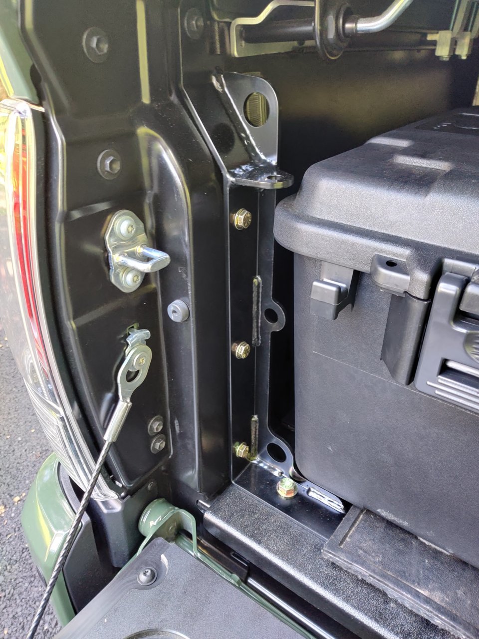

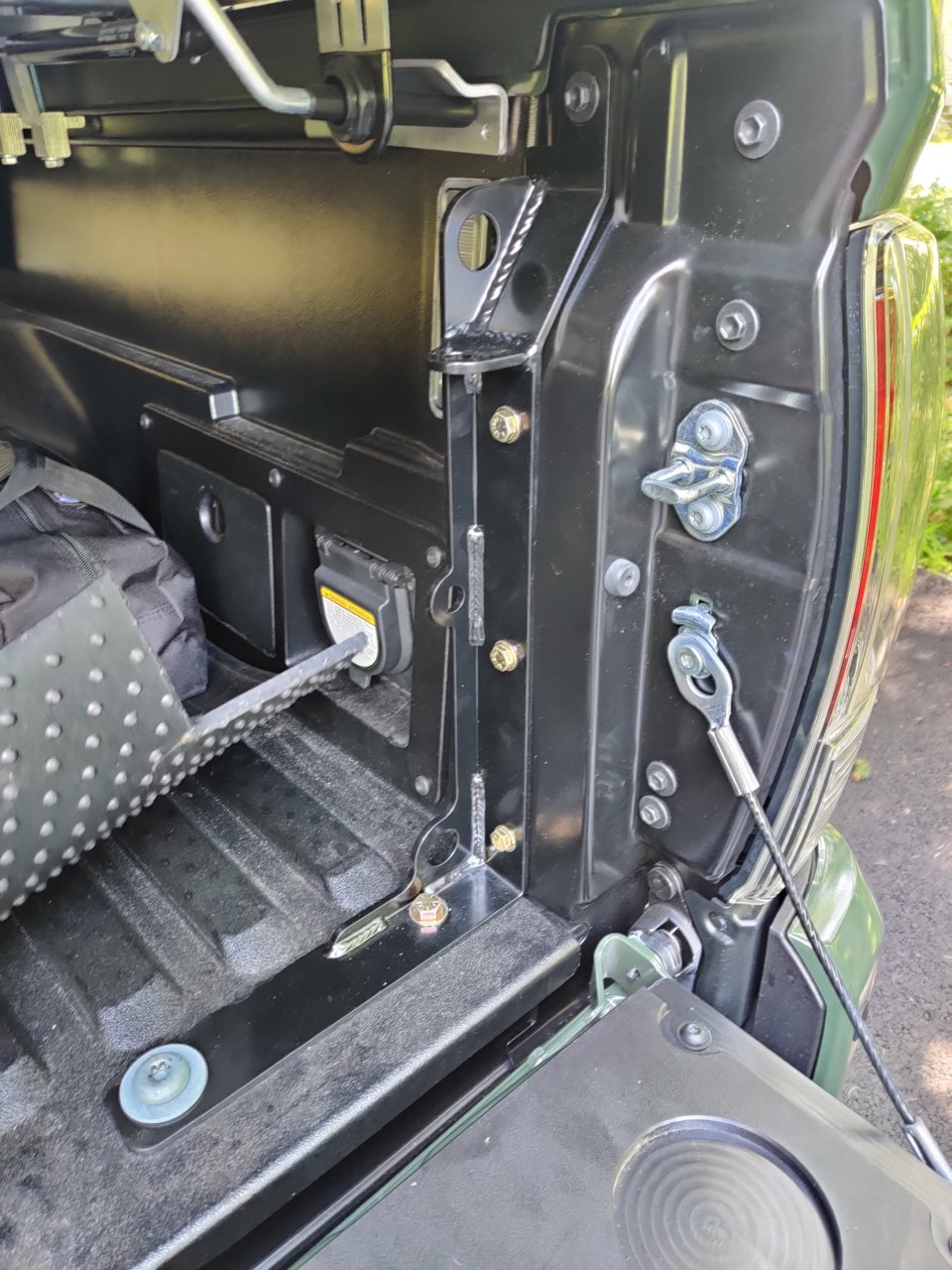

    Didn't do this all today but during this past week.
    Total Chaos Bed Stiffeners

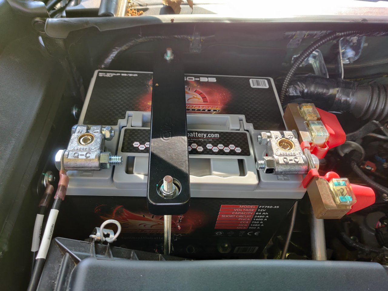

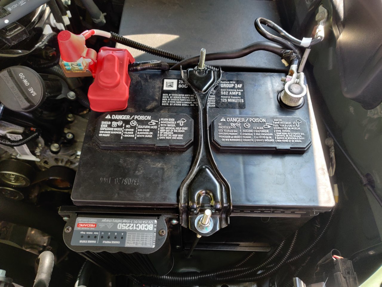

    Off Grid Engineering Dual Battery setup with Redarc. Kept the factory starting battery for now as my truck is still pretty new and picked up an FT750-35 for the Aux battery. Double MRBFs on the aux battery are for a future Powertrays/Switch Pros install

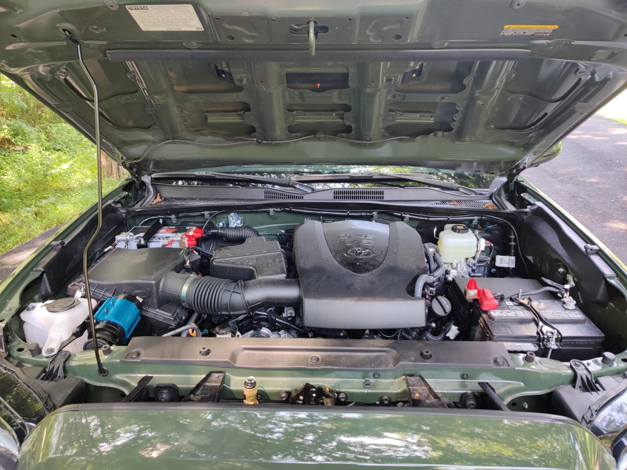

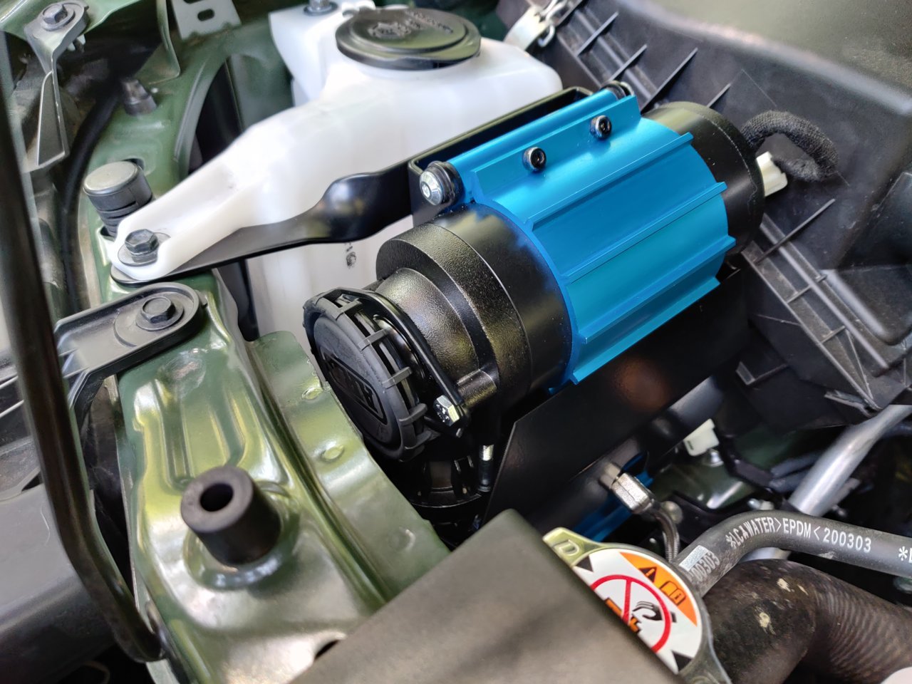

    Installed an ARB twin with a SLEE 2nd Gen ARB mount bracket and a custom fabricated bracket from Tacoma World that I picked up second hand on here.

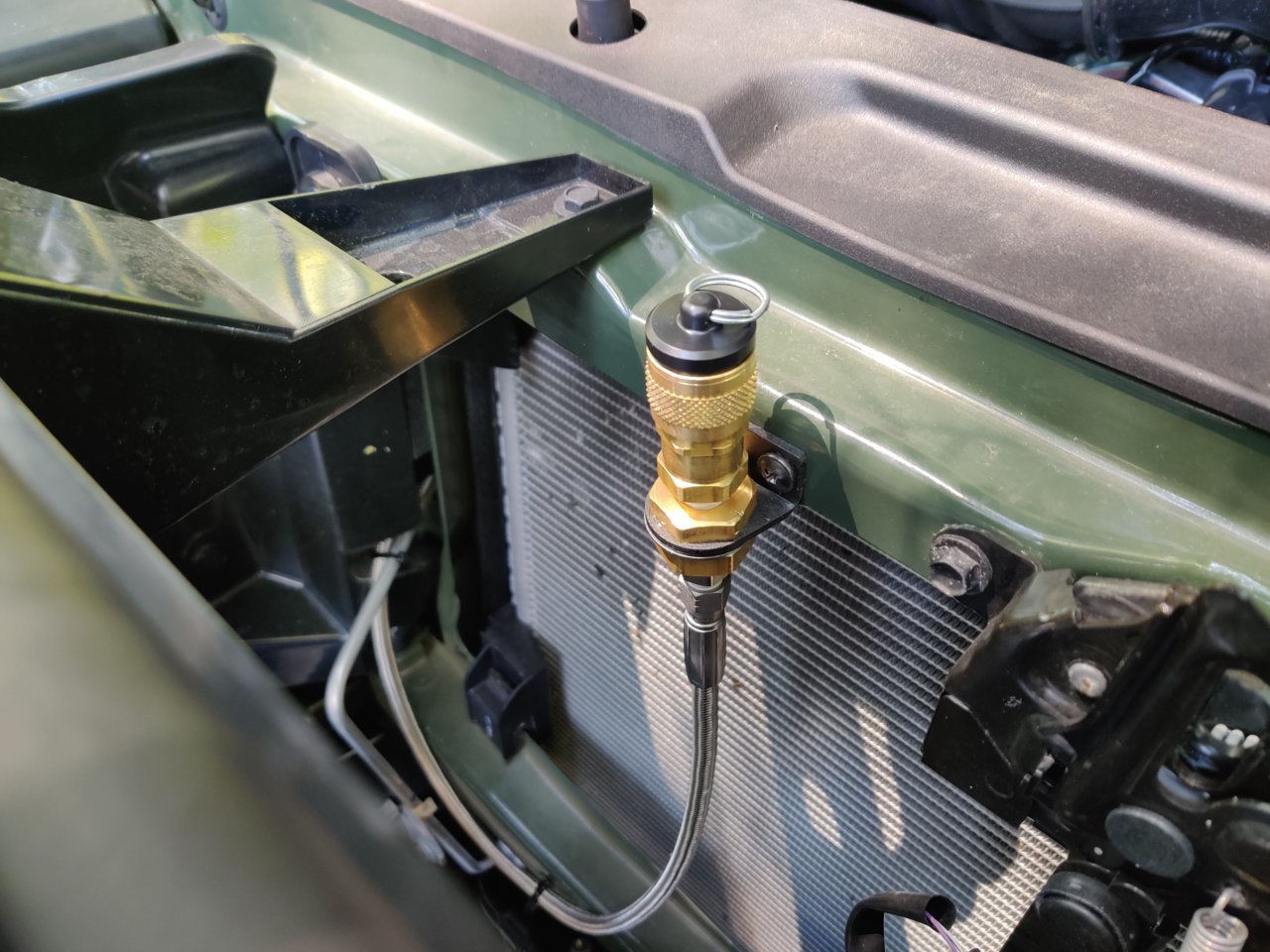

    Ran the hose to a quick disconnect chuck from Wits End I mounted behind the grill.
    Also made my own switch harness to have the switch right by the compressor. The compressor has its own inline fuses and is connected directly to the aux battery.
    Full view of engine bay

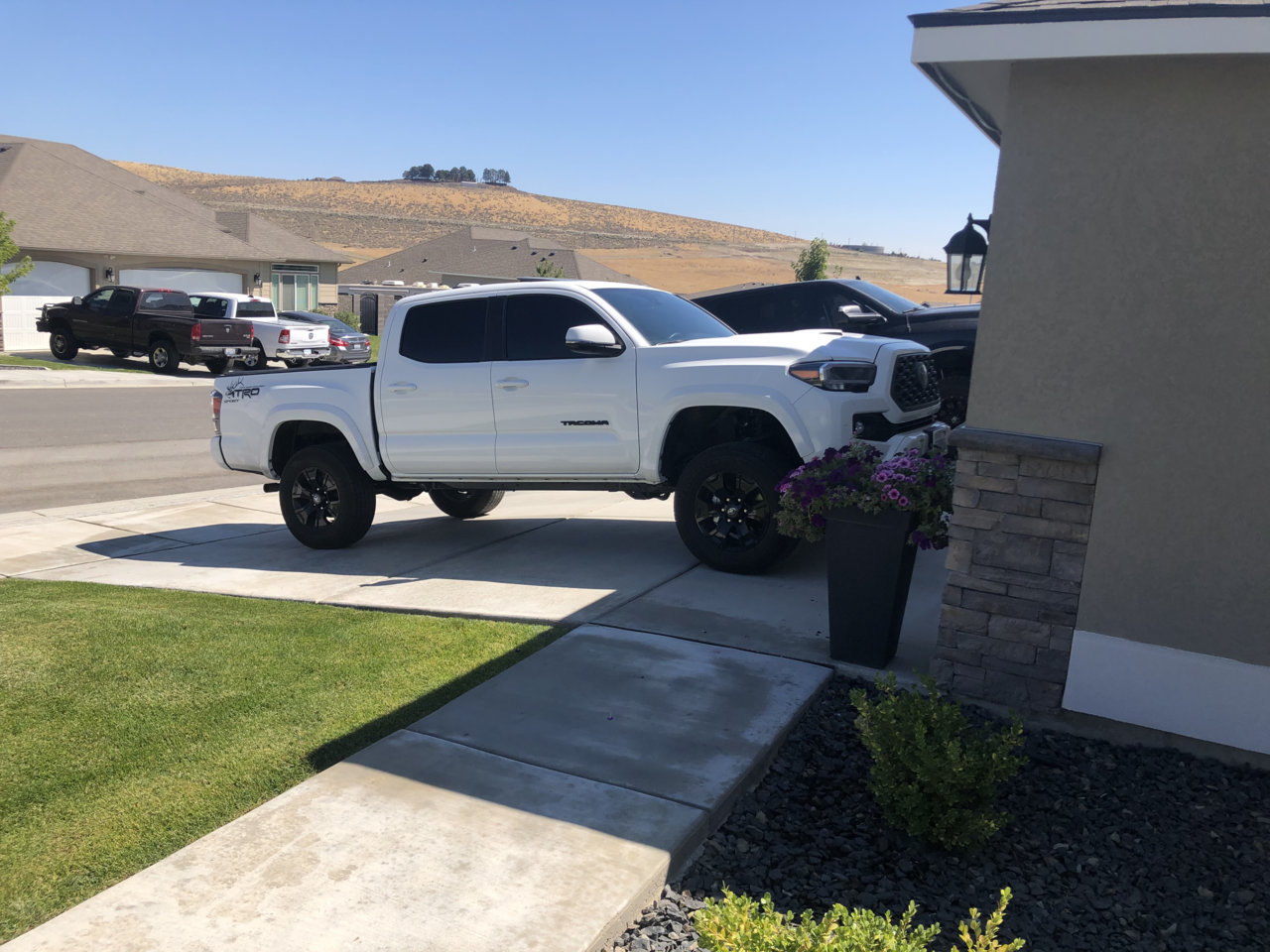

    After cutting up my truck for a few hours and trimming the fenders, I finally got my 33s on

    wow those total chaos stiffeners look really freaking nice! I've seen another company, RagoFabrication, who sells bed stiffeners as well. Those stiffeners are shorturl.at/atLQ4 and I couldn't help but notice your Total Chaos products go further up the tailgate. Do you think those Total Chaos would be more effective at their job because of that?
    I am just curious as I've only seen that Rago Fab brand sell them. I am not even entirely sure who needs stiffeners, I don't believe I do at the moment but I may need to look into them some time down the road if my wallet permits my dream build ;)

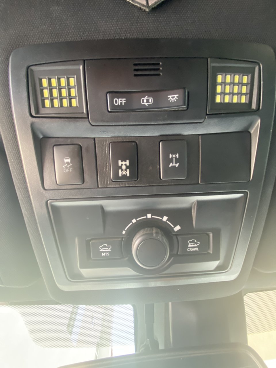

    Originally installed my front locker onto my switchpro, but to make room for possibly future plans decided to go with a more OEMlook for the locker. Installed a overhead switch panel from @MESO and a CH4x4 switch.
