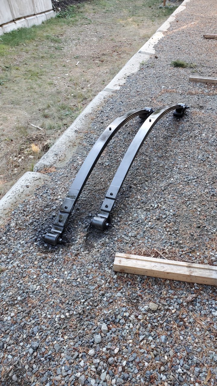

    Got the new leafs ready to go, still waiting on brackets and shock mounts though.

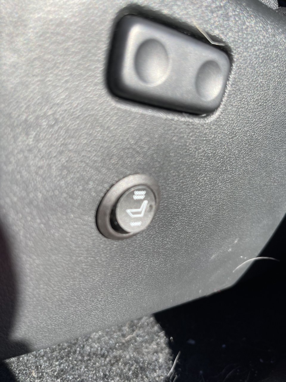

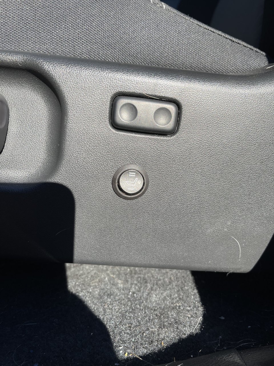

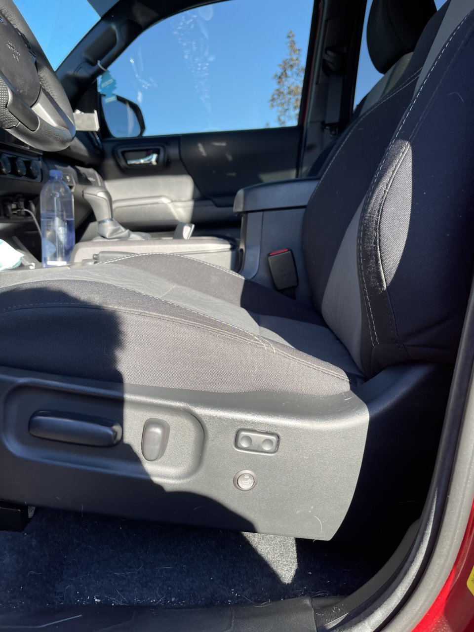

    Had the aftermarket seat warmers installed… my back already thanks me.
    Nice thing about these switches is that they’ll come on when the ignition turns over. Which means remote start will start getting them seats warm!

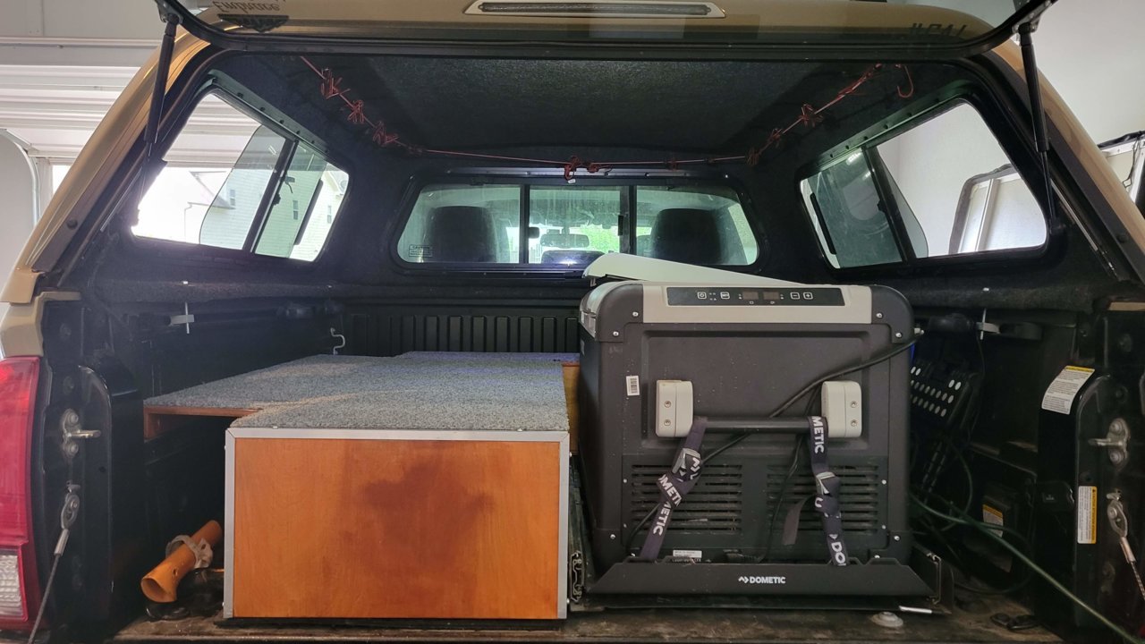

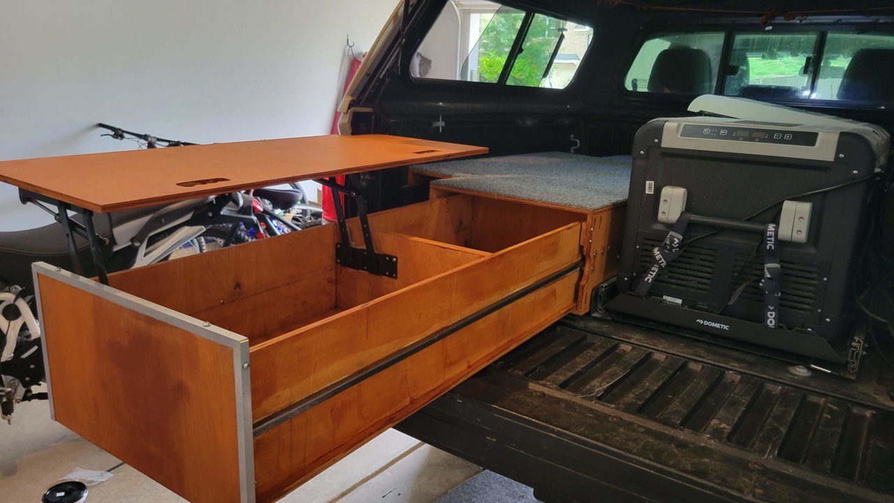

    Wrapped up my pull out camping drawer and battery box. Carpeted the top so my dog has something to dig her nails into riding back there.

    What brand?

    I believe they are the Rostra ComfortHeat heated seats. 3yr/36K mile warranty.
    I am hopeful they last longer than that but if they last 3 years I’ll put in a full seat replacement at that point and go with leather up front.
    I had seat covers in my F150 since day one and while I liked that the seats were basically factory new when I traded it in I hated the material/feel of the covers. Plus I didn’t have heated seats.
    I will do it right when the replacement is due up and get the ball coolers and heated seats. Probably leather. That’s what the wife’s Lexus has and it’s a game changer.

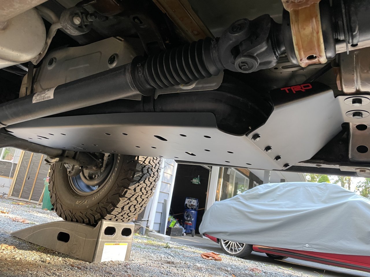

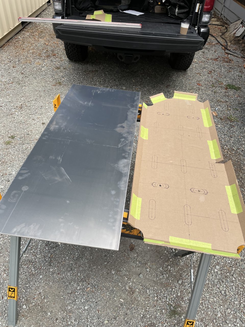

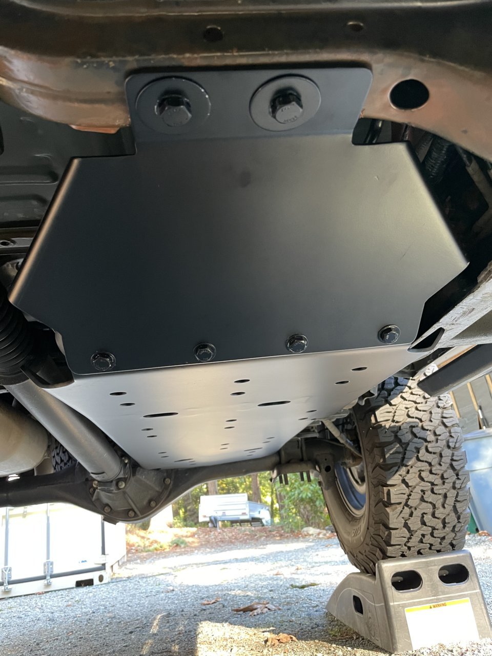

    Fabricated a metal rock guard for the fuel tank, made it from 3/16” 5052.
    Used the CBI fuel tank skid for R&D purposes, (Rip off and Duplicate) started with a cardboard template,and it evolved from there.01BA5A1B-9F4A-4626-A907-1570B705DDE7.jpg E4DABE65-87EF-4EDD-B778-E8E89945A1D2.jpg E63D97AF-CDB5-417F-9421-D78886BD6798.jpg A02651D0-F94E-461B-BB44-BC7D68E015B0.jpg

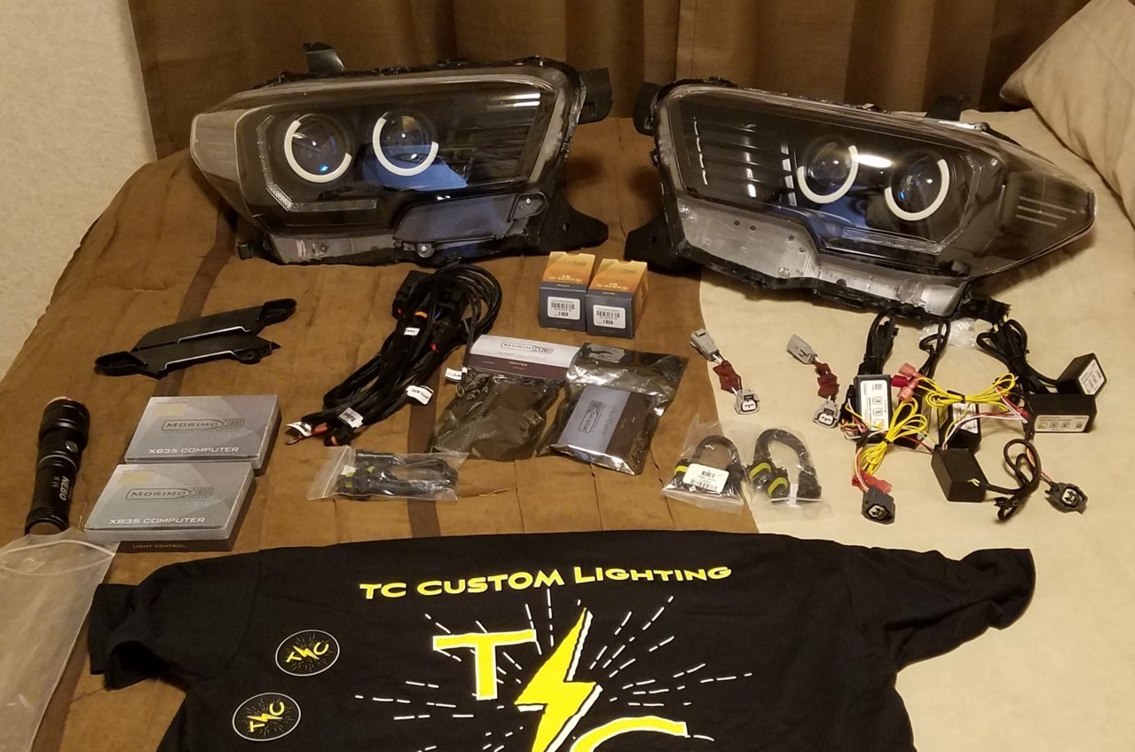

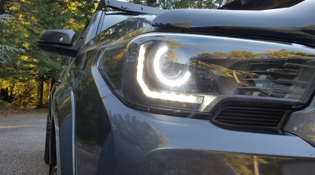

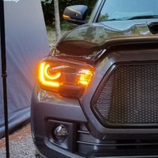

    I definitely prefer the og 3rd gen headlights over the led (just seems so squinty and crammed) and I can’t get over how the front bumper to headlight trim plate indent look against them- such an afterthought design. Just doesn’t flow together IMO
    can’t wait to see the results you have here

    I actually like them both but you can't completely black out the chrome reflectors on the LED's. Hopefully have these installed around around Oct 1st.
