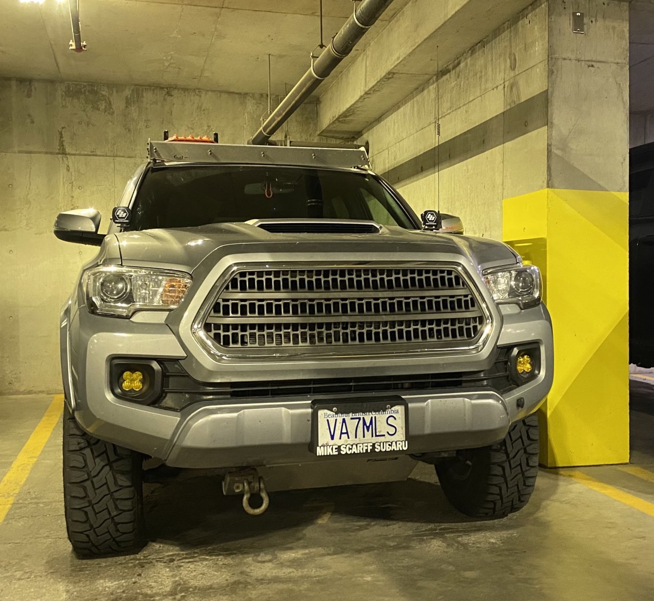

    Wow! That looks amazing! Nice work.

    Thanks, it's really grown on me..

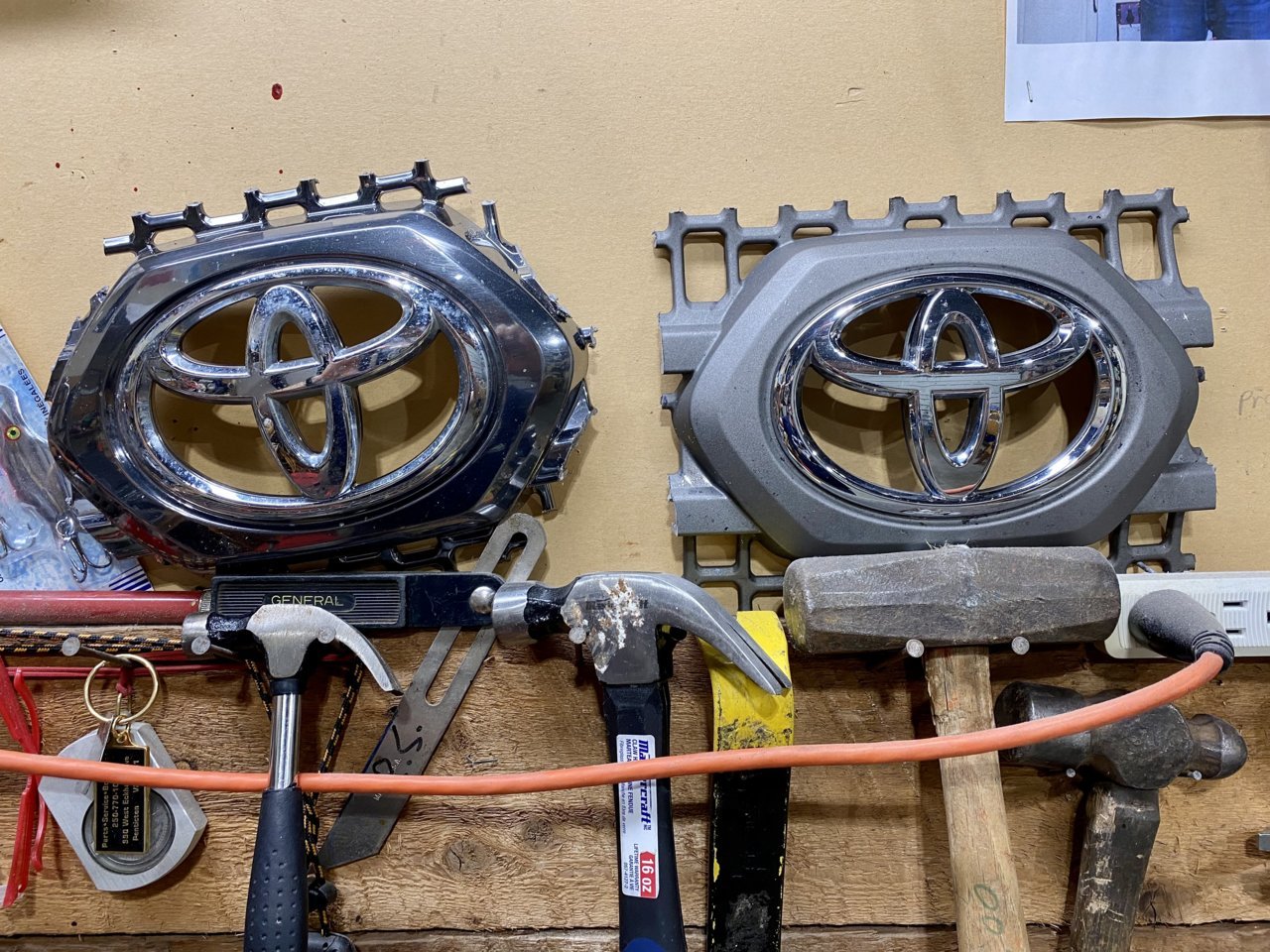

    We used to chop out/in emblems, tilt them, move them to the side, etc etc back in the Mk2 Vw days.. I just figured I could make it different than another Pro grille..

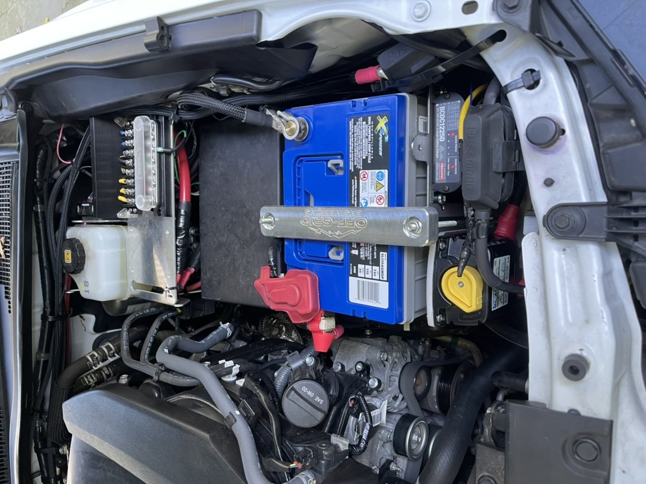

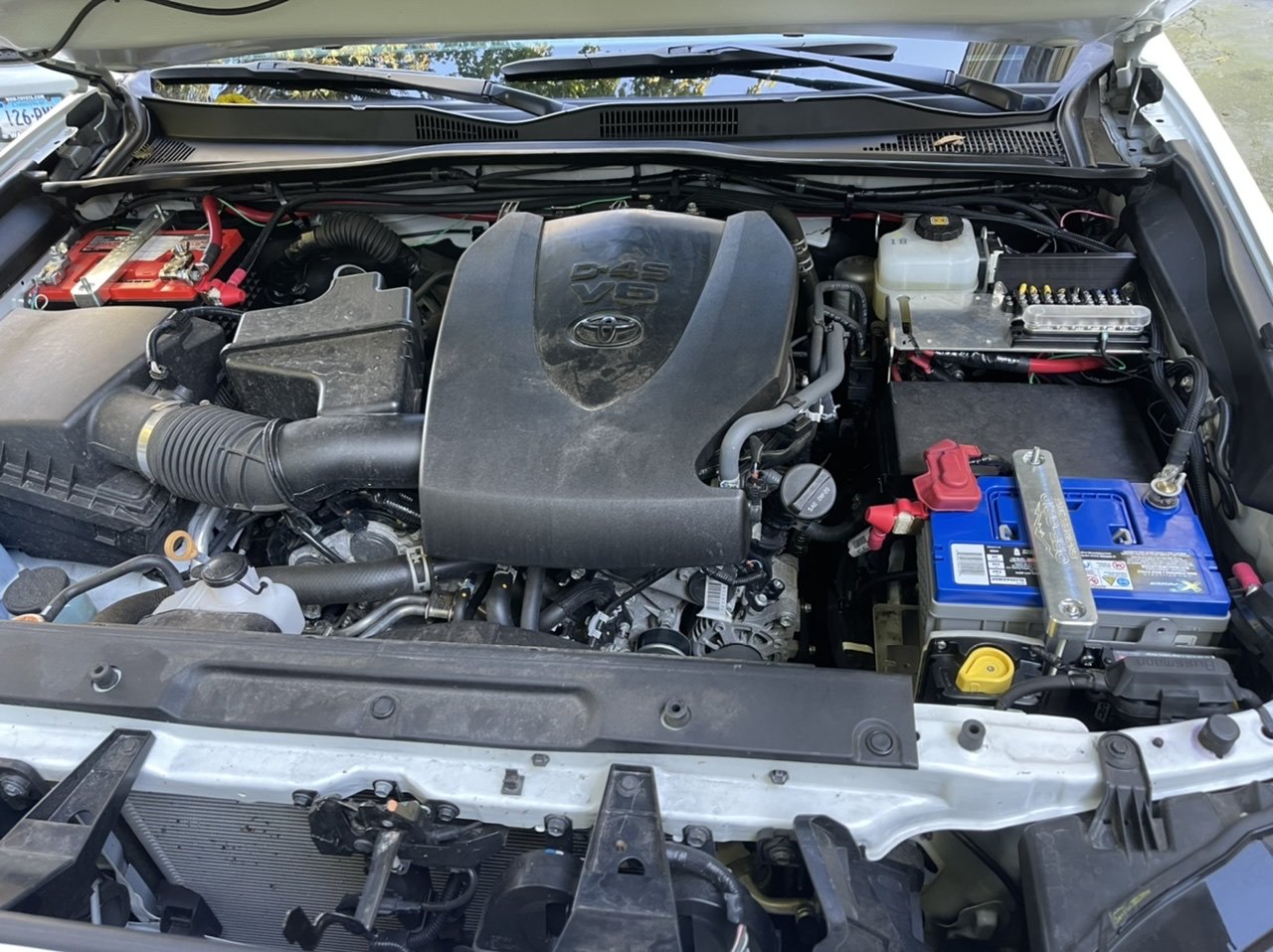

    I plan on doing the same thing. How did you mount the BCDC and wire it with the Blue-Sea? Did you wire the in-cab switch?

    yes I did mount the in cab switch, the bcdc is wired after the blue sea, comes off of left stud of blue sea to a 40amp fuse to the red of bcdc then brown to another 40amp fuse to the positive of aux battery. So positive circuit goes from main battery to blue sea out blue sea to redarc red, redarc brown to aux battery. There is a diagram somewhere which shows bcdc wired through isolator to enable emergency jump by connecting aux and main in a moment of need.

    The bcdc is mounted using the universal bracket from redarc which I connected to the kit from off-road engineering.
