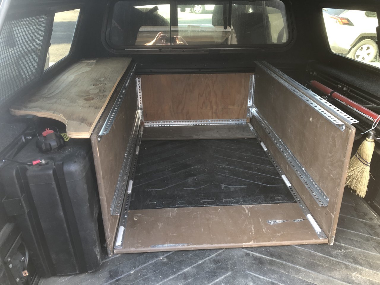

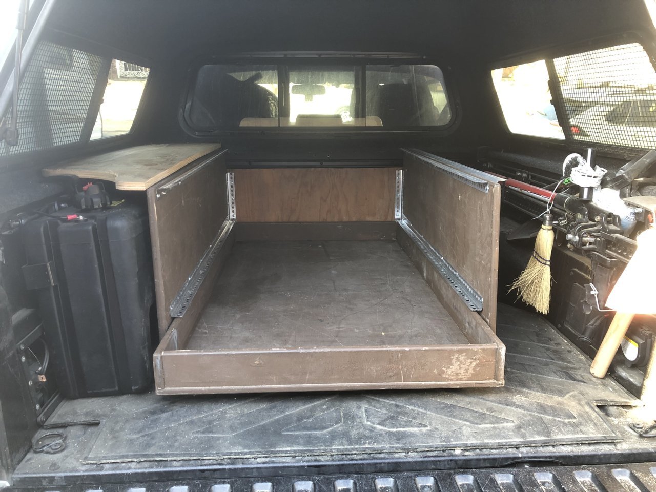

    Tore apart my previous shelving unit for wood and I’m using it to make a prototype bed shelving Unit. I’m just rough cutting everything right now and fitting it, but when finished with clean wood it will box in my 15 gallon Titan pony tank on one side of the bed, my shovels, jacks, other tools and recovery gear on the other side, and in the middle will be my refrigerator and other gear on a pull out shelf. The tracks for the shelf are supported by the steel angle iron but I put stick on Nylon furniture moving tabs along their length for the shelf to slide on and it now slides really easily. When the refrigerator is not in place I can put a full-size deck on top that’s all removable and can be reconfigured for tall items or short. I’m also going to add a couple more levels of shorter shelves thAt can fit in behind the refrigerator. Right now it’s just a prototype, I’ll post measurements and plans when I get the thing done on a separate forum.F15D19C7-1CDA-4CB3-87A8-75782D403B87.jpg3A71F30C-D2F7-4F57-956C-A69A692A5D6F.jpg

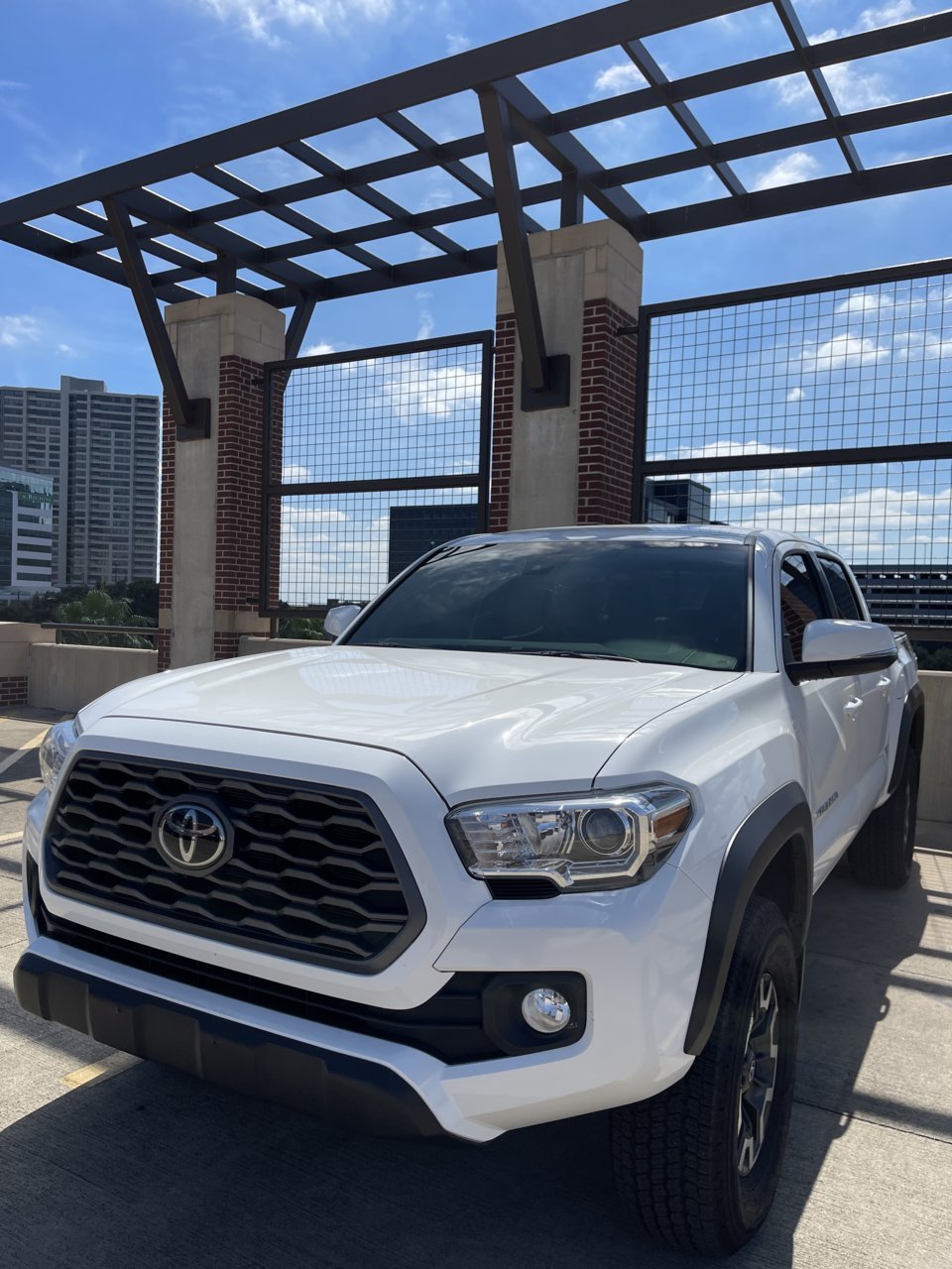

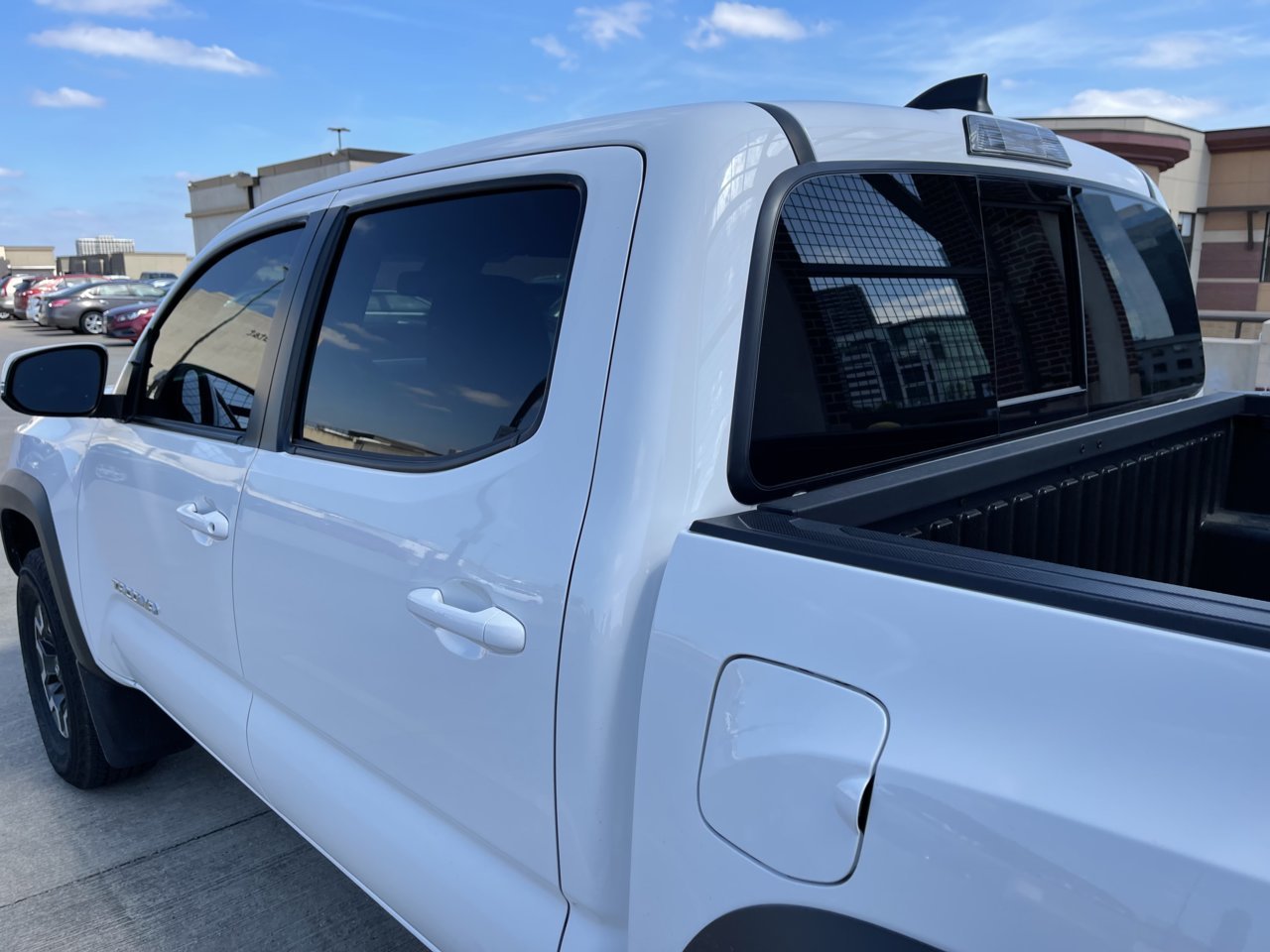

    Ceramic IR Tint.
    -70% on windshield & factory tinted rear glass.
    -20% on front windows
    Windshield looks darker in pictures vs. in person.

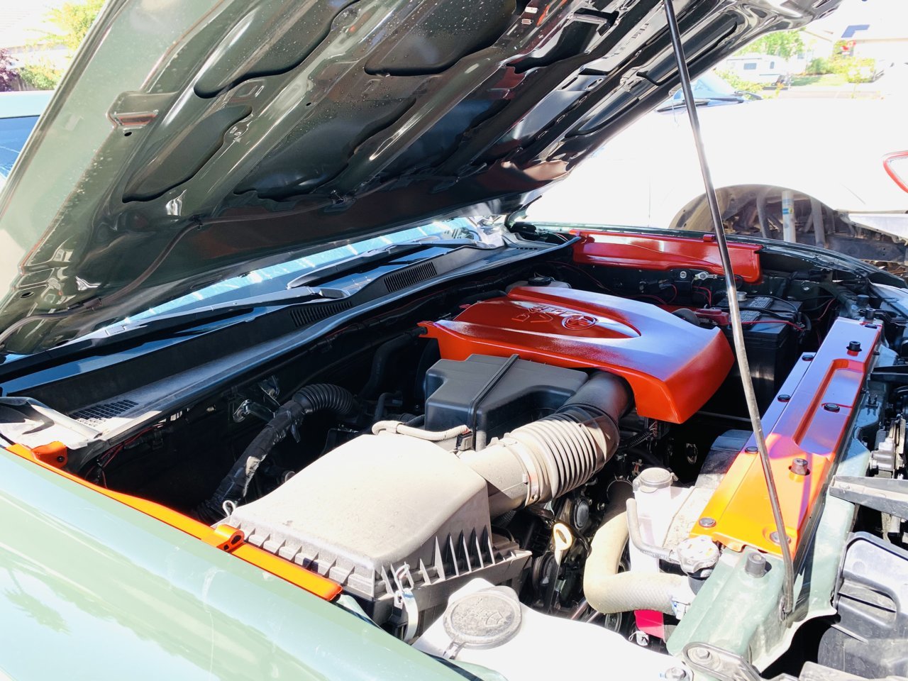

    Prepping for the TRD Intake 31B64B32-6127-400C-859C-0C39A0DDFCFD.jpg 08E31B0D-21DA-416C-BECB-E84A7D773D36.jpg
